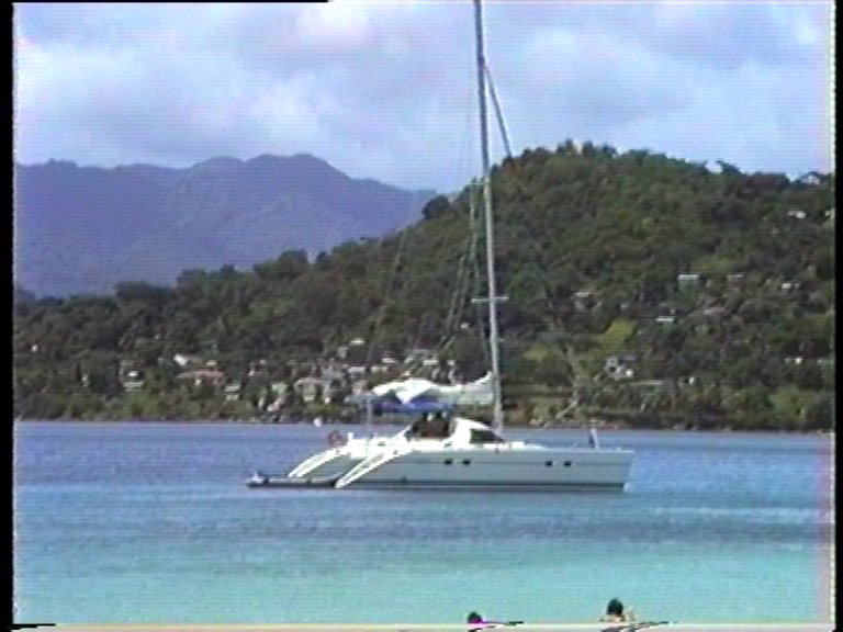

    @Sharc & @DB83, and everybody else interested:
    like I wrote in my previous post, I haven't provided sample files yet. But here they are. They are matched by frame. I put both captures in my NLE on top of each other and matched them frame by frame. That way I'm able to compare them frame by frame by muting one track and see how the image changes after muting.
    That way, I can see that my own 2023 capture seems to be a little bit brigther / the gamma seems to be a little bit higher than the 2008 one. Interestingly, such differences are only visable in certain scenes (usually outdoors). Other scenes are literally identically with no change between 2008 and 2023 whatsoever.
    I rendered a couple seconds out in DV-AVI (making sure my NLE doesn't re-encode as the target format is the same as the input-format, my NLE calls this "Smart Rendering") for each captures:
    2008 capture: Here
    2023 capture: Here
    The good thing about re-capturing, even though most of the time I don't see a clear difference in picture, is that I can eliminate errors such as at 20 seconds in the 2008 capture (small horizontal line, visible for the length of a frame) which usually aren't there in the 2023 capture. So I gained new information from the 2023 capture that I can use to replace faulty frames with in the 2008 one and vice versa.
    I did the 2023 captures with a Sony Digital8 TRV-730E (which also has analogue-in and digital-in - so could be used as an A/D converter for analogue signals coming in and outputting them either via DV or analogue).

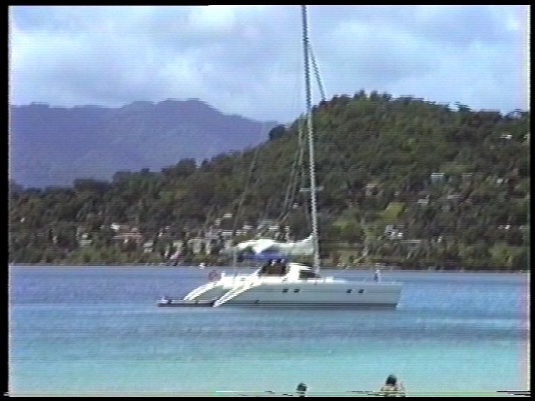

  10. Your 2023 capture is as good as the 2008 variant IMO.
    Here just a quick and dirty levels alignment of your 2023 capture to make it look similar as the 2008 variant; nothing optimized yet.
    I left it interlaced as the original capture, re-encoded to AVC x264 and removed the audio to keep the file size small.

    Do you still spot differences in details retention?
    If I compare the original 2008 and your modified version frame by frame I can see very slight differences in colour. Especially in the clouds: yours seem to be a tad more blue and the 2008 original one seems to have soft purple specs:
    2008: Image
    [Attachment 71856 - Click to enlarge]
    2023 modified: Image
    [Attachment 71857 - Click to enlarge]

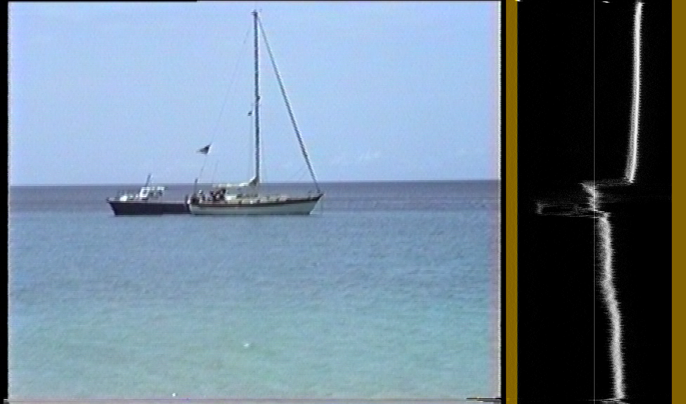

    Oh sorry, I thought this has been explained so many times I would only pour a pint of water into the ocean.
    It can be done in Avisynth with Tweak() or ColorYUV() or (Smooth)Levels(). I used SmoothLevels here:
    AVISource("2023_DV.avi")
    Smoothlevels(input_high=255,output_high=243)  #bringing the high level 12 notches down
    Histogram() #to show the waveform for adjusting the parameters
    As you see from the picture below there is still little luma reaching out into the brown bar, hence the output_high should actually be set a bit lower than 243 (like 235), recovering few more details in the brights. I used 243 in this case just to make it look much the same as the OP's 2008 'professional' capture.

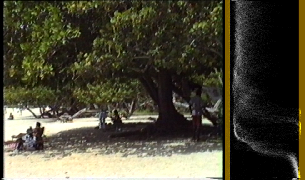

    And, btw., to eliminate the horizontal stripes one could use:
    Smoothlevels(input_high=255,output_high=235) #setting the max level correctly to 235 here
    separatefields().vinverse().weave()  #remove the horizontal stripes
    Histogram() #to show the waveform for fine tuning
    See Attachement 2 with the horizontal stripes removed (still interlaced though).
