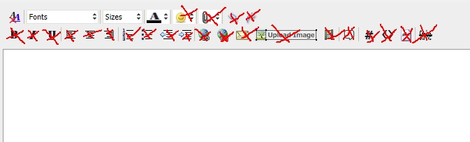

    p.s. ehm... I wanted to attach a video example to better explain what I need to do.... But I just found out that none of these buttons work.
    So now I have a problem within a problem....
  13. Upload Image works,
    "Add an Image" window would popup, select "From Computer" Tab, then "Browse" button, then "Upload Files" button
  14. Yes Upload image works in "quick reply" mode, not in "go advance" mode. Really strange. Anyway, I was able to upload the video to at least paste the link
