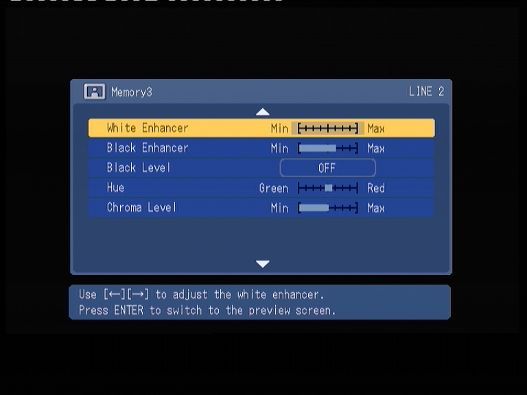

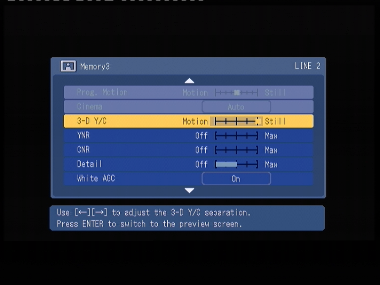

    So i had some free time to play with recorders and made more samples with more tapes.
    I used JVC HR-S7500 with its s-video output. I tested ES10 with s-video output and s-video through scart as well.
    I captured two tapes with passthrough to Hauppauge Live 2 but also simultaneously using HDD recording on Sony RDR-HXD895 (15mbps mpeg2) and DVD recording on Panasonic DMR-ES10 (XP mode). I used avidemux to cut video to fit in the 500MB file size limit. Panasonic doesnt seem to be consistent with its results, two avi files and simultaneous dvd ones differ from each other a little, which is weird as input was the same (AV3 all the time, in front of es10).
    You can see what i meant with much weaker "frame" TBC in sony before, it skips frames while panasonic doesnt, or skips only few.
    Line TBC difference isnt that visible but as i said, with the tape i captured and talked about in my thread the differenece seemed to be more visible for me.
    PS. What do you think about the quality of that HR-S7500 vcr? I bought it for 60 euro (with shipping) but was sceptical about its state but seems to be playing tapes just fine.

    I used only s-video output from hr-s7500 and s-video inputs/outputs on recorders, so all are y/c. I recorded with hauppaauge and internal recorders in the same time.
    I tried s-video output with scart (av1) on DMR-ES10 as it was said it has birghtness variations in normal s-video output (thats why i added scart in file names).
    Internal records are additional, just wanted to show them too. What's nice about sony is that it captures whole frame unlike panasonic.

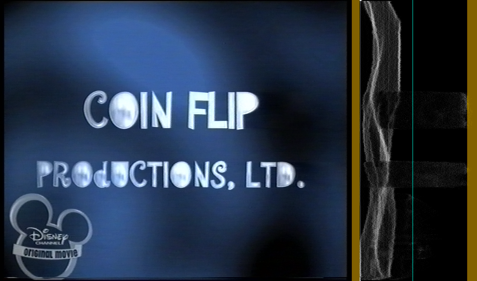

  22. Hi guys, both my ES-10 and Pioneer DVR-530H arrived today. I started some prelim testing...
    Just FYI, i just plugged DVRs as-is and recorded. I did not adjust the DVR settings yet (it seems they sent me wrong remote for ES-10. When i press menu on the remote, i get an error, and i had no batteries for Pioneer remote), so will play with those over the weekend.
    Regarding the initial testing - both samples have amazing lineTBC/horizontal-jitter removal [Panasonic is bit more stable]. Thanks both for advising the DVRs. I did not think i could get such stunning and stable image!
    Panasonic ES-10 however introduces posterization (if i see properly) and really strong temporal denoising (there is this contour shadow following all the figures, especially if the image is darker), if i will be able to adjust the menu, ill try to turn that off to fix the issue.
    Pioneer does not add stuff that shouldn't be there like Panasonic does (posterization, sharpening, denoising), but i do feel that the color management is worse. Denoising is much weaker, so the colors are not unified, there is overall green tint to the video and there is this green stripe on the left side in most of the recordings i did today that wasnt in the original 'VCR - hauppauge' connection.
    Ill have to adjust the settings to see what is due to wrong settings and what is the default of the VCRs. I was trying to look for manuals how to setup passthrough DVRs, but they are not pinned in this thread. If you guys have any guides, id be eternally grateful, please.
    PS: it seems both DVRs convert signal from SECAM to PAL as now in my Amarec-Tv, i have to set PAL instead of SECAM (in SECAM, i get crazy colors and the video freezes). [in my original connection VCR to Hauppauge to PC, i was recording in SECAM]

    All you can set on Panasonic is disabling AV denoising (makes obvious difference) and eventually choose output on scart (Composite/RGB/S-Video)
    I'm not really sure what you can do on Pioneer. On my sony i can adjust picture much more (uploaded settings menu above)

  25. Hello all,
    i am posting another sample for ES10 but this time with NR turned off (thanks Brad for the guide)... The annoying temporal denoising is now gone and the image is nice and clear.
    i did further testing and I think i will go with Panasonic ES10 due to following reasons:
    1. Pioneer adds overall green tint to the image
    2. In Pioneer recordings, there are these jumpy horizontal green lines on the left edge that werent there before ( i did about 5 hours of footage from 4 different tapes and its everywhere. as it is jumpy, i do not think it can be removed in post-processing)
    3. every minute or so, there is a skipped frame at the top part of the image (white or magenta rectangle that flashes for a second)
    4. to me, it seems that Pioneer jitter is worse and Panasonic as more stable image if im looking at the edges.
    With NR turned off, Panasonic now seems like a great choice and very close to my original recordings without passthrough devise. there might be slight posterization but everything considered, it seems to be a small price for ultra-stable image.
