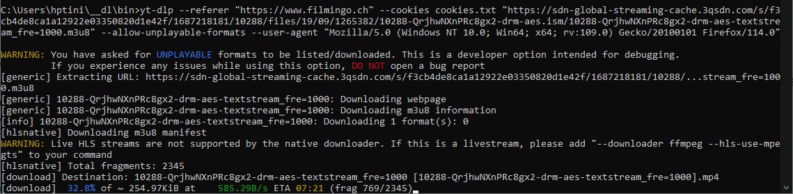

    thanks, apparently something is ok now !
    [Attachment 71792 - Click to enlarge]
    i'll let you know about the result.

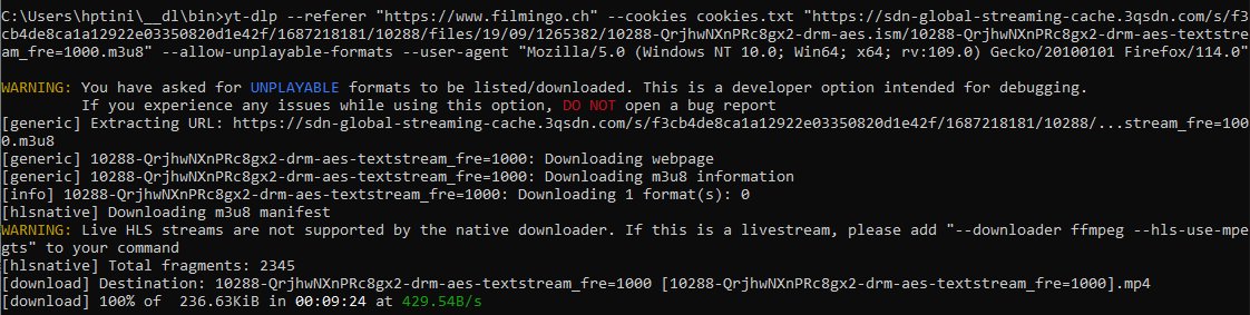

  4. it's done.
    but i have a MP4 file... howcan i get a vtt or srt instead, please ?
    [Attachment 71793 - Click to enlarge]
  5. re-download your video
    yt-dlp --write-subs --sub-format vtt --sub-langs en --embed-subs "https://m3u8" -o output.mp4

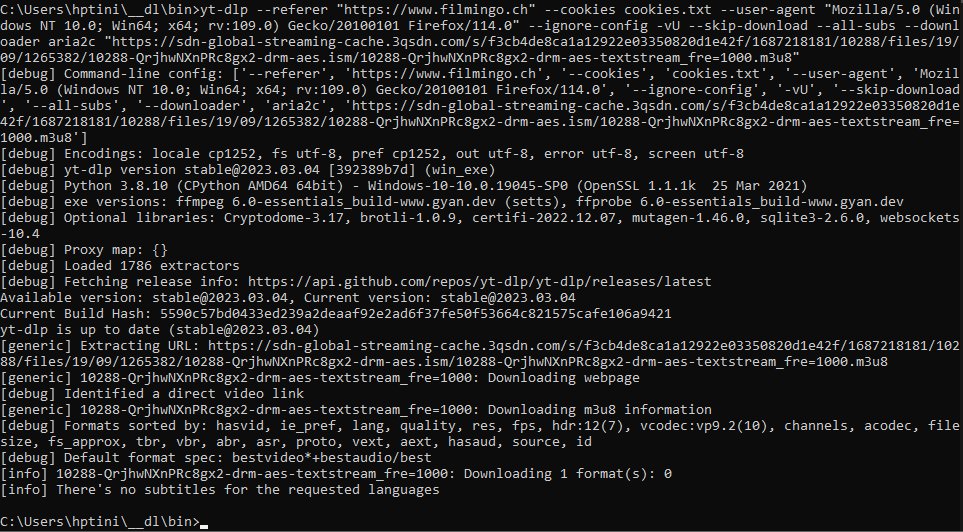

  6. If the m3u8 has subs you can use this yt-dlp.exe --ignore-config -vU --skip-download --all-subs --downloader aria2c "yourmasterm3u8url"
    You also need to put aria2c in you env folder for it to work.

    then with this last advice from sadomasochist, i get this : "there's no subtitle for the requested language"
    [Attachment 71808 - Click to enlarge]
