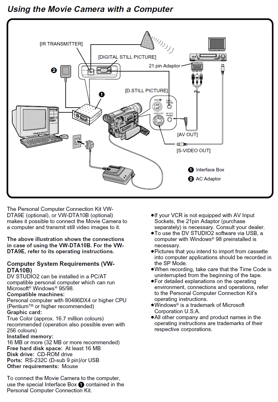

    see this PDF guide page 85 - https://www.manua.ls/panasonic/nv-ds150/manual?p=51
    the firewire cable is only used to connect from one camera to another. to connect to a computer,
    see page 87, there's an adapter that you'll need.

    No adapter needed for firewire, that is referring to transferring digital stills stored on a memory card.

    Some people say you don't need drivers for Firewire, but my practice says the opposite. The DV camcorders that I can use with a computer have native Firewire drivers installed on top of a standard driver. I have a 1999 DV camcorder that I was not able to connect to my Win7 computer. Yours seems pretty old too, considering references to Win95/98 and i486 CPU. I bet there is no driver for it, it was not meant to transfer video to a computer via Firewire.
    I may be wrong, and maybe some universal Firewire driver will work for it. If you make it work, please share, maybe this will help connecting my old DV camcorder to a Win7 PC.

    I believe it uses a very old protocol to connect a 3.5mm jack to a serial port on the computer like the ones used in analog VCR's and camcorders to connect to a computer or a printer to take snapshots (Sony called it LANC and JVC has JLIP, not sure about Panasonic), The firewire port I believe is strictly for dubbing tapes from one camcorder to another, I hope I'm wrong.

    You are wrong (unusual for you, Dellsham). LANC has nothing to do with video transfer; it is a Sony remote-control protocol for using a wired remote control to control cameras (video and still alike). Besides, LANC is not fitted to this cam, by the looks of it.
    In my view, the only reason it was added to camcorders was to provide a fast-enough continuous-flow method of getting the video off the tape and into a PC (or another "digital device", as that pic shows). Camcorder to camcorder was a gimmick. Camcorder to a DV deck, now you're talking, but that merges into a computer (remember Apple started FW off).
    That quoted image, on page 87 of the manual, is clearly off on a tangent because the only video flow goes to a VCR, and I suspect that that "21 pin adapter" is nothing more than a boring old SCART plug.
    I believe the relevant diagram is the one on the previous page titled "Using with Digital Video Equipment (Dubbing) (NV-DS150 only)".

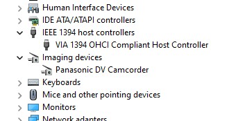

    That'd be me and I'll say it again. Never, in 20 years dealing with firewire camcorders, including two Panasonic DV cameras, have I installed a unique "driver". I have always only used the Windows driver. The only problem I have had is recently, when I changed my computer and had to install a firewire expansion card. With Win 11, I am using the bog-standard Win 11 driver ie not "(Legacy)" with a cheap VIA firewire card. On my old Win 10 machine with built-in Firewire, I had to use the "(Legacy)" driver.
    Originally Posted by Kiwikraut
    I had a look in Device Manager, in Imaging Devices as well as in Sound or under the actual Firewire connection but no DS150 shown anywhere.
    OK, you need to see your camcorder under imaging devices, like this:
    [Attachment 71784 - Click to enlarge]
    Have a look in the menus to see if there's a DV In setting/switch; the 150 looks like it can do DV In, which you'd want turned off. Apart from that, and swapping the Windows driver to try both combos, and trying various sequences of powerups and connections, I can't suggest much else except for installing one of those Firewire cards in a PC (easy to do if you can take left-side off a PC box).

    Off course it's not, It's a Panasonic camcorder, It uses a different sceme to transfer stills shown in the above diagram posted by Bwaak, The adapter is required to transfer images to a serial format a computer can understand and again this is for stills not video. Yes LANC is for controlling from external peripherals I used it to control Sony camcorders from a tripod, but my memory of these proprietary names is too short.
