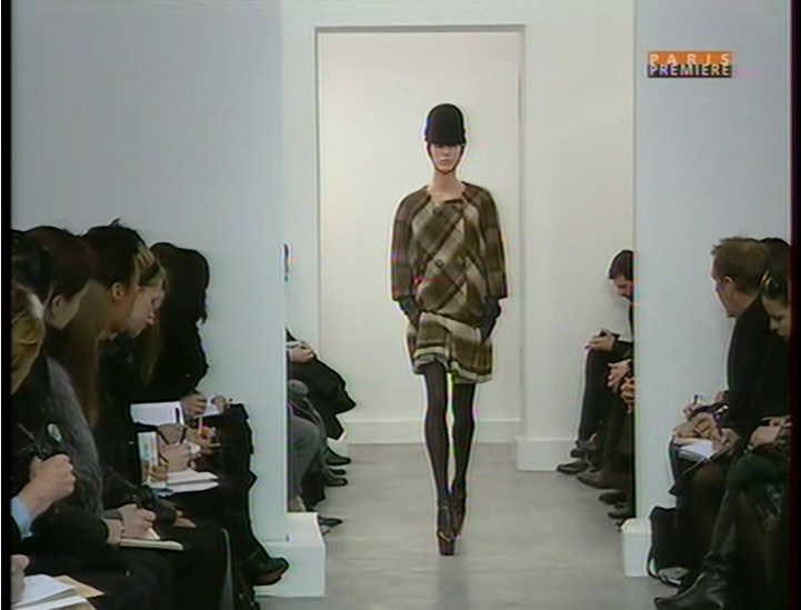

    This is not VHS to PC but actually live TV to DVD recording via DVD recorder (therefore, no way to re-record). Regardless, i do see this in both my DVD and VHS-to-PC recordings and is it this border around objects... I do not know what would be the correct term? Halo? Ghosting? Ringing? Aura? Holy Spirit? [edge is on both left and right side so i presume its not ghosting?] I also see some rainbow? Is it a rainbow?
    Anyhoo, it does not bother me that much as-it... BUT.. when i try to upscale videos using Topaz, Topaz thinks this is an actual object, not a video defect and upscales it too making the edge super obvious and the video looks ever worse than before upscaling. Is there a a way to remove this, please? I do not even know where to start as I dont even know what im dealing with?
    Please, help and save my sanity while there is still some time!

  2. Over-sharpening halos and rainbow artifacts (leakage of high frequency luma content into the chroma). They can be reduced to some extent with post processing but it's best not to produce them in the first place. See if there's a sharpness setting in your DVD recorder and turn it down.
  3. you have two things: Haloing ("double edges" effect more or less big, here they're rather small imo ) and what looks like Moiré (bad demodulation of chroma -> cross-color), can be fixed on the hardware level by using a 3D Comb filter when you use composite or simply a s-video cable is enough
    https://www.avartifactatlas.com/artifacts/moire_effect.html
    Moiré can be fixed with avisynth and the SSIQ filter
    MPEG2Source("defect sample.d2v", cpu=0)
    SSIQ(diameter=11, strength=200, interlaced=true)
  4. YAHR works fine for the dehalo part.

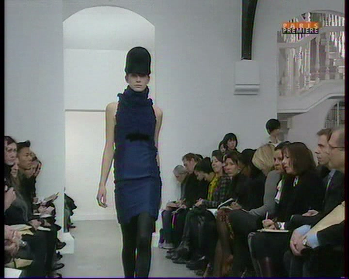

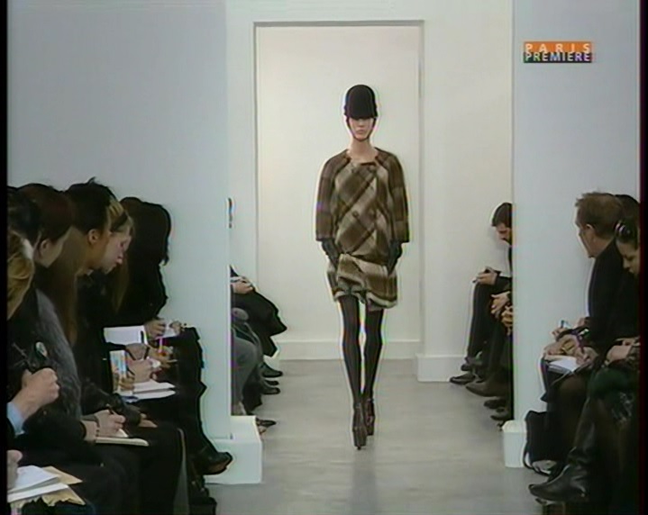

    thanks for the tips. i agree that the 'double edges' effect is not visible. the problem is when i try to upscale the videos - with digital vids, i get stunning results, but with these analog vids with 'double edge', the second edge becomes very obvious (as software thinks its part of the video) and the video becomes a hot mess.
    Thanks for the SSIQ tip, i cannot find x64 plugin so will try it later with x32 plugin.
    thanks Selur. Im trying below YAHR function but i cannot see a difference. (i am zero-skill scripter and i use chatGPT). Did I enter something incorrectly, please?

Name:	1 before.jpg
