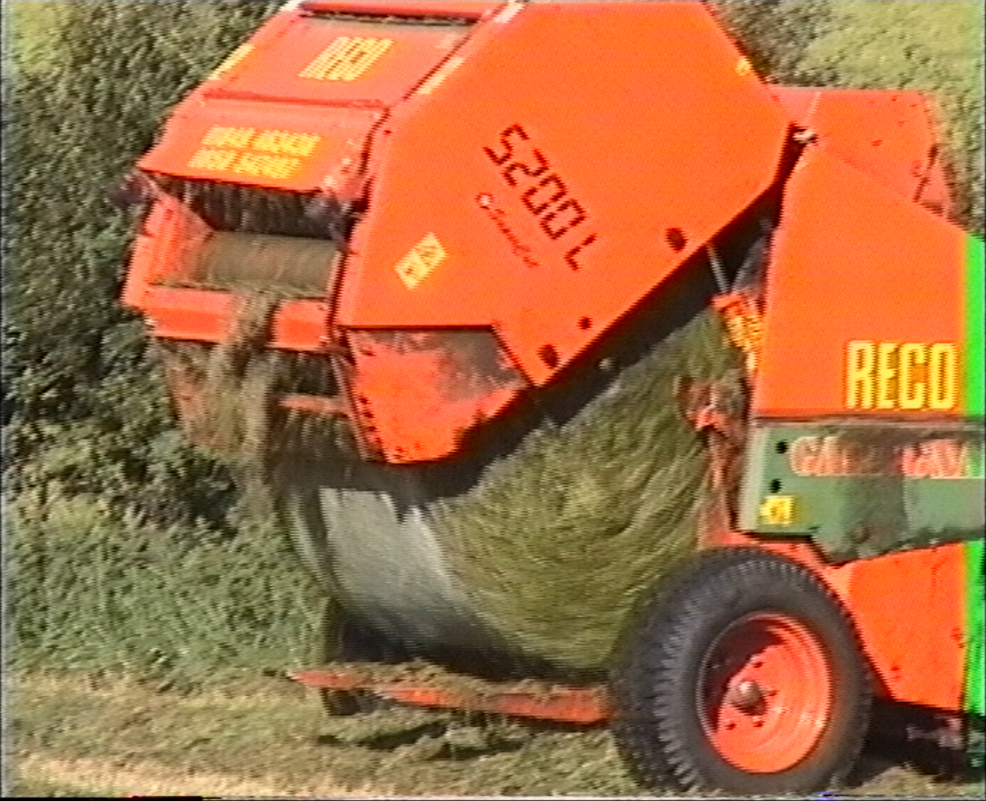

    Here are some samples I've uploaded from some amateur footage from some Video8 tapes - this is via the Digital8 TR7000 into the HV40 into PC via firewire. To the untrained eye it looks pretty naff but I'm sure there is a more technical description. Initial thoughts?
    https://1drv.ms/f/s!AoYVwYm0qHh9lq5RJiQNC6vn-TB0dQ?e=nL0bdu

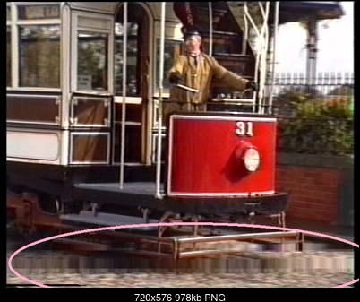

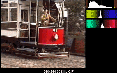

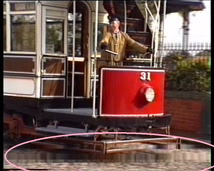

    Sample 2 suffers from color loss in frames between 360 and 380 and damaged frames around frame 400.
    Try to recapture to check if the problem is on the tape.

  10. Video Restorer lordsmurf's Avatar
    Nothing this canbe
    (a) in the footage, so SOL
    (b) due to bad player/camera
    (c) due to lack of TBC
    All are equal chance here, 33/33/33.

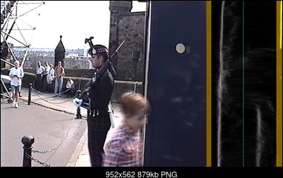

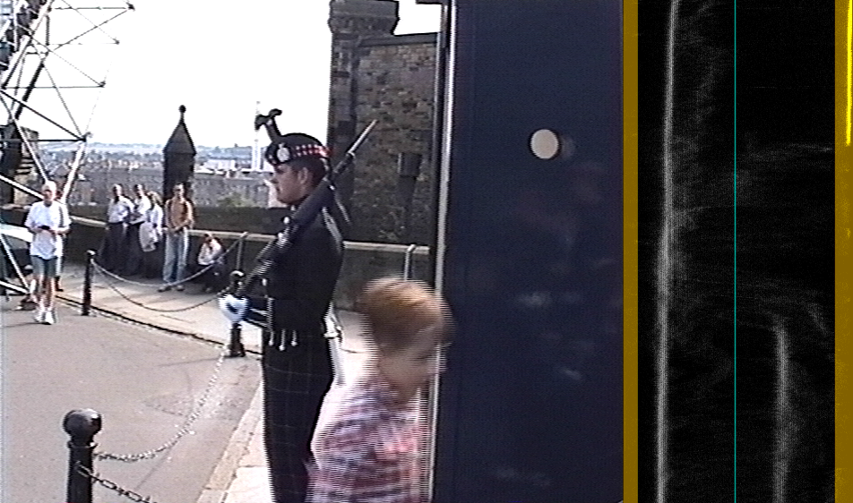

    I notice a narrow bar down the right hand side of the footage, with red or green hue depending on the scene. Anything I could be misconfiguring in the capture perhaps?
    I do not think so. I found stange it only affects the orange machine but not the background. Eventually, you can mask/crop that portion in post-processing.

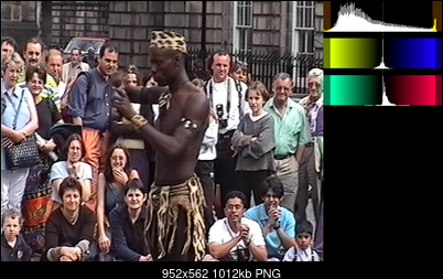

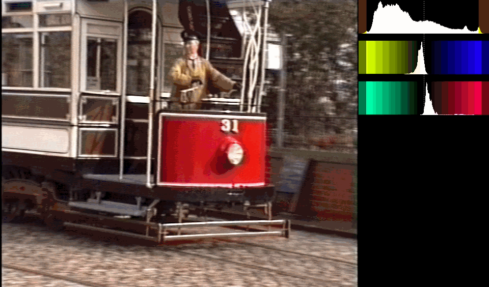

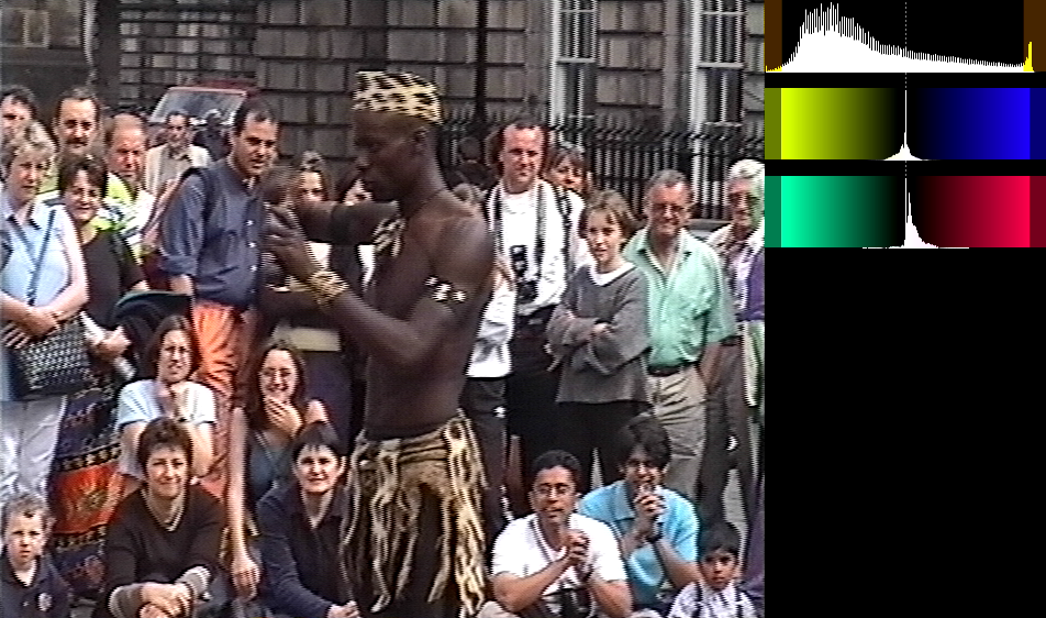

    This is an excellent capture.
    The picture is clean, detailed and sharp. TTF interlaced fields architecure. The levels do not show evident crush of the blacks nor clipping of the whites You may need to reduce the range to 16-235 for processing involving RGB conversion, or at the end of the processing.
    There is some accumulation of the whites at the beginning (clear sky in the background), probably normal because the shot.
    If in other captures you experiment crush/clipping, tune the input levels with the procamp of the USB-Live 2. There are several topics in the forum about it.

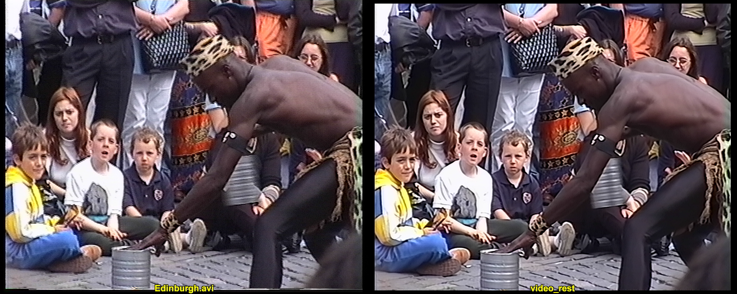

    For restoration a simple QTGCM, light denoise and very light sharpening is maybe just enough

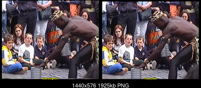

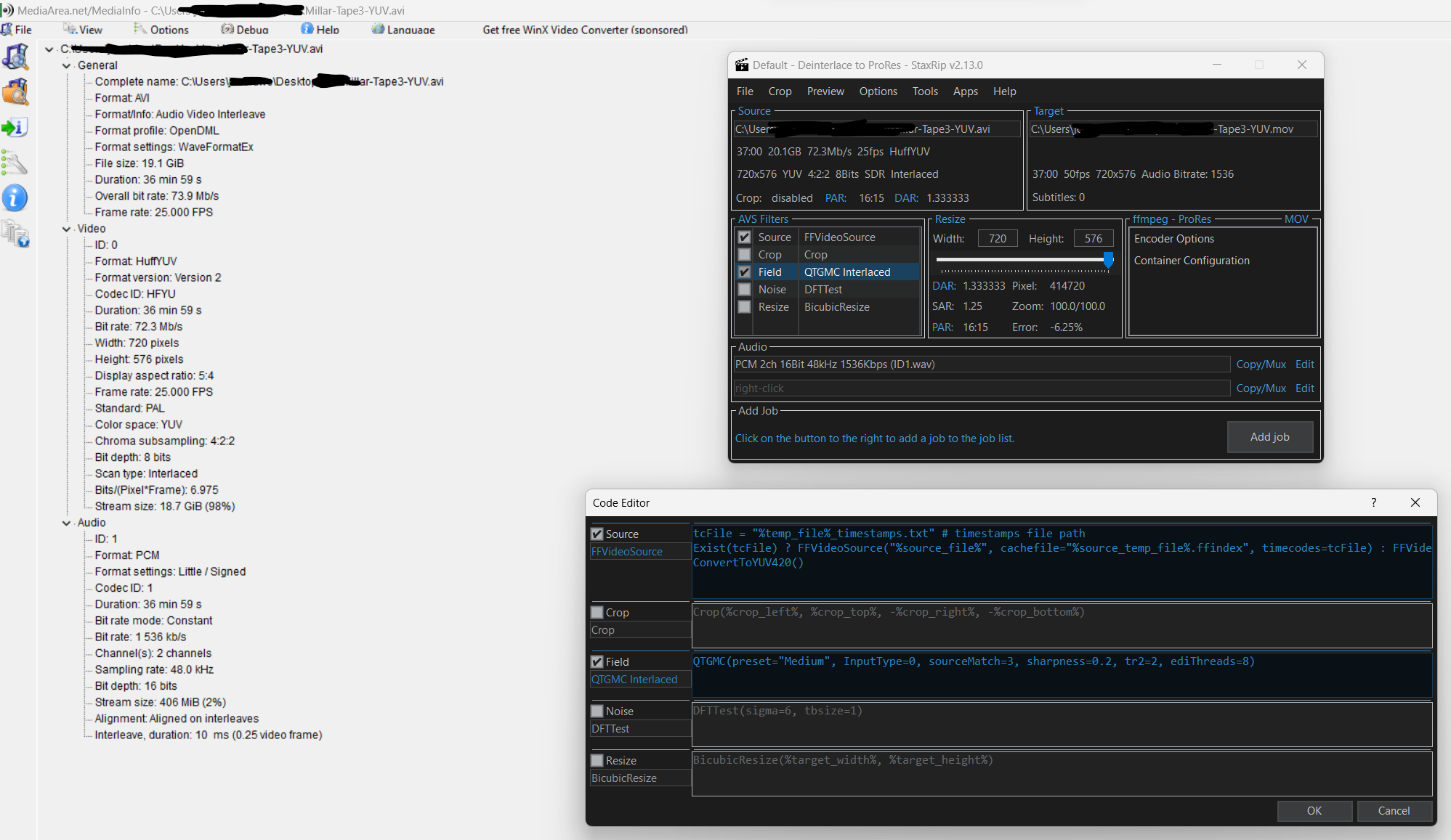

  23. So I've got some captures done but struggling on the deinterlace part. I've used Staxrip in the past but with the configuration here I am getting quite jittery, jerky results compared to the original. Does the mediainfo capture or the Staxrip config show any obvious issues or settings I have missed? I'm outputting to ProRes for my "editing" format as I cannot seem to retain the avi.
    Here is the Staxrip session showing more details on the parameters...
Name:	Screenshot 2023-06-20 211150.png

  24. Video Restorer lordsmurf's Avatar
    Use Hybrid, not Staxrip.

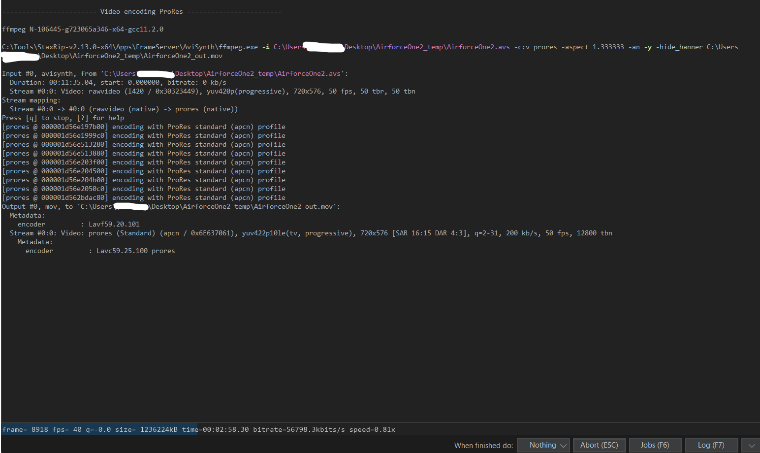

  25. Got this one sorted. Needed to modify the Staxrip script to use AssumeTFF() - it seems to assume BFF as the default. This has much better results so I am now moving on to try to work out best workflow for cutting out the scan lines at the bottom and do some denoising in the same script.
    Is there an advantage of masking the scan lines as part of the same workflow, or can I just crop in the editor before rendering out to delivery format?
  26. Update:
    I noticed in Staxrip that there is a "ConvertoYUV420()" command inserted by default under the source file selection section. My source footage is 8-bit 422 HUV interlaced so I don't think this is needed or accurate - will it do harm to keep that in there, especially considering interlaced=true isn't specified?
    My process for now is...
    AssumeTFF()
    QTGMC(preset="Medium", InputType=0, sourceMatch=3, sharpness=0.2, tr2=3, ediThreads=8)
    # This extra crop on the right bar was due to strange colours due to a known Sony PAL camcorder issue
    Crop(0,0,-28,-12)
    AddBorders(14,6,14,6)
    # Upsizing to 1440 x 1080 (YouTube is the target)
    Spline64Resize(%target_width%, %target_height%)
    Any obvious concerns or comments on this flow? I am outputting to ProRes MOV. Any better format I should be looking at to preserve detail?

    All this if you are not happy with your DV flow
    PAL 4:2:0 is far more tolerable, but the loss is still noticeable, especially viewed "large" (normal TVs, not phones or tiny capture preview windows). It's really about use case more than anything else, with DV-allowable cases becoming preference.
  29. Captures & Restoration lollo's Avatar
    Jul 2018
    Italy
    This is vastly overblown, and in fact has only been mentioned in recent years as an excuse to not get a TBC. The supposed "loss" in a TBC it tiny compared to loss by capture cards, wrong capture settings, etc. Or loss by not using TBC at all.
    I agree. My point was that if a (frame)TBC is not needed, you also save lossy A/D and D/A conversions.
    Also using a high-end card like a BrightEye 75 having an internal (frame)TBC remove this lossy A/D/A conversion, as testified by user dellsam34.
