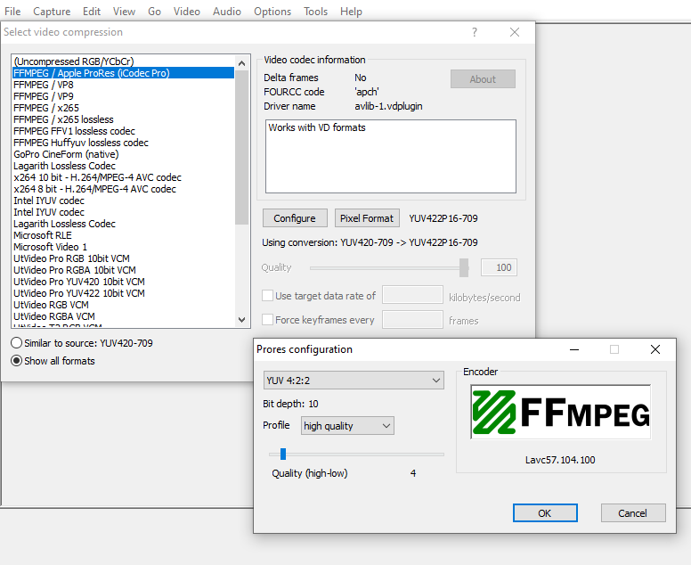

Any changes to the default encoding settings you would recommend? (see screenshot)
[Attachment 71548 - Click to enlarge] -
Looks ok, but are you sure prores is what you want ? You should be asking which "lossless format" they want and give them that, because prores is lossy (minimally lossy, but still lossy)

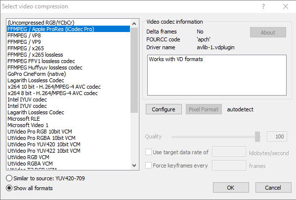

Are the .mov encoding options you mention in this list of Vdub2 profiles? (see screenshot)
[Attachment 71549 - Click to enlarge] -
video=>compression=>uncompressed (it's the one above ProRes in your screenshot)
Select Pixel Format Button, 4:2:2 YCbCr 10bit (v210), Push OK
For ProRes 4444 XQ, it's in the drop down menu in your 1st screenshot (instead of "high quality") -

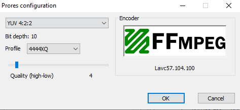

[Attachment 71554 - Click to enlarge]Last edited by spicediver10191; 8th Jun 2023 at 02:53.

Encode tests with the 4444XQ ProRes profile actually gave me smaller files/lower bitrate, so have dumped that option.
Instead I'm just creating an uncompressed .mov file, plus a ProRes 422 HQ .mov file because that profile encodes at a similar bitrate to my lossless source. The 4:2:2 subsampling is the minimum for this profile I believe, so I'm just leaving it alone.Last edited by spicediver10191; 9th Jun 2023 at 03:50.
