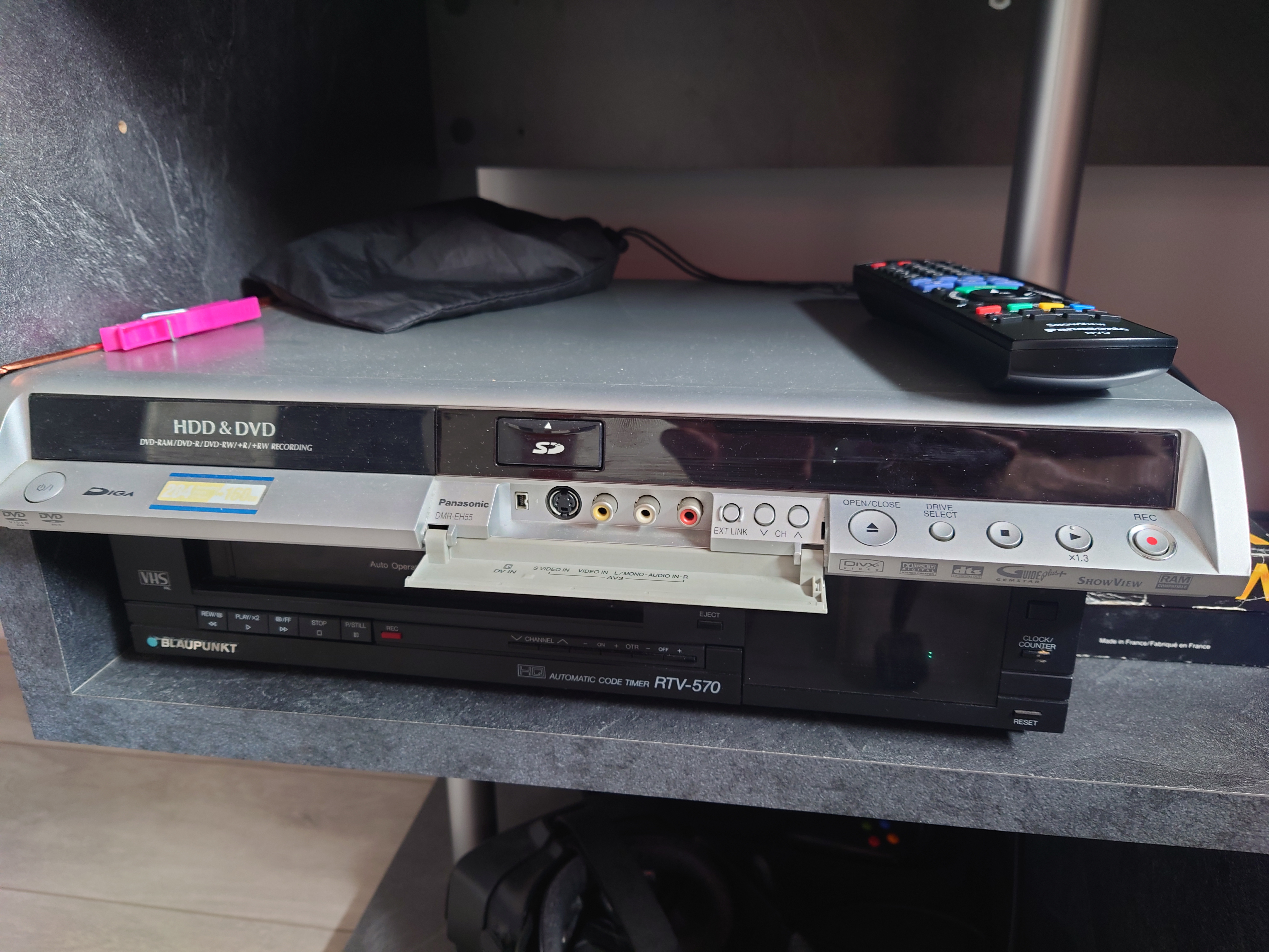

    Update: No progress, but this happened:
    I finally managed to pick up a secondhand Panasonic DMR-EH55 DVD recorder. Upon arriving home and setting it up, I plugged it in and hit the on/off button. It greeted me with a "HELLO" message, but I soon suspected something was wrong as the message didn't disappear. After patiently waiting for a few minutes I decided to press some buttons, but they wouldn't respond to any of my presses presses, except for the eject button; when pressed it told me to "PLEASE WAIT" and it then quickly followed up with a "BYE" and shut down...
    So yeah, it looks like I bought a broken device...
    I did some troubleshooting with the use of the manual, but can't say that proved any use. I can't get the tray to open whatsoever or get any of the buttons to respond and I can't get any video feed out of it. It also didn't come with a remote, so there's only so much I can do to try and fix it.
    Yay, back to searching for another secondhand!

    This behavior is also characteristic if the DVD drive is broken. Got any error codes?
    You can try to replace DVD with another recorder.
    And try a hard reset.

    Originally Posted by rgr View Post

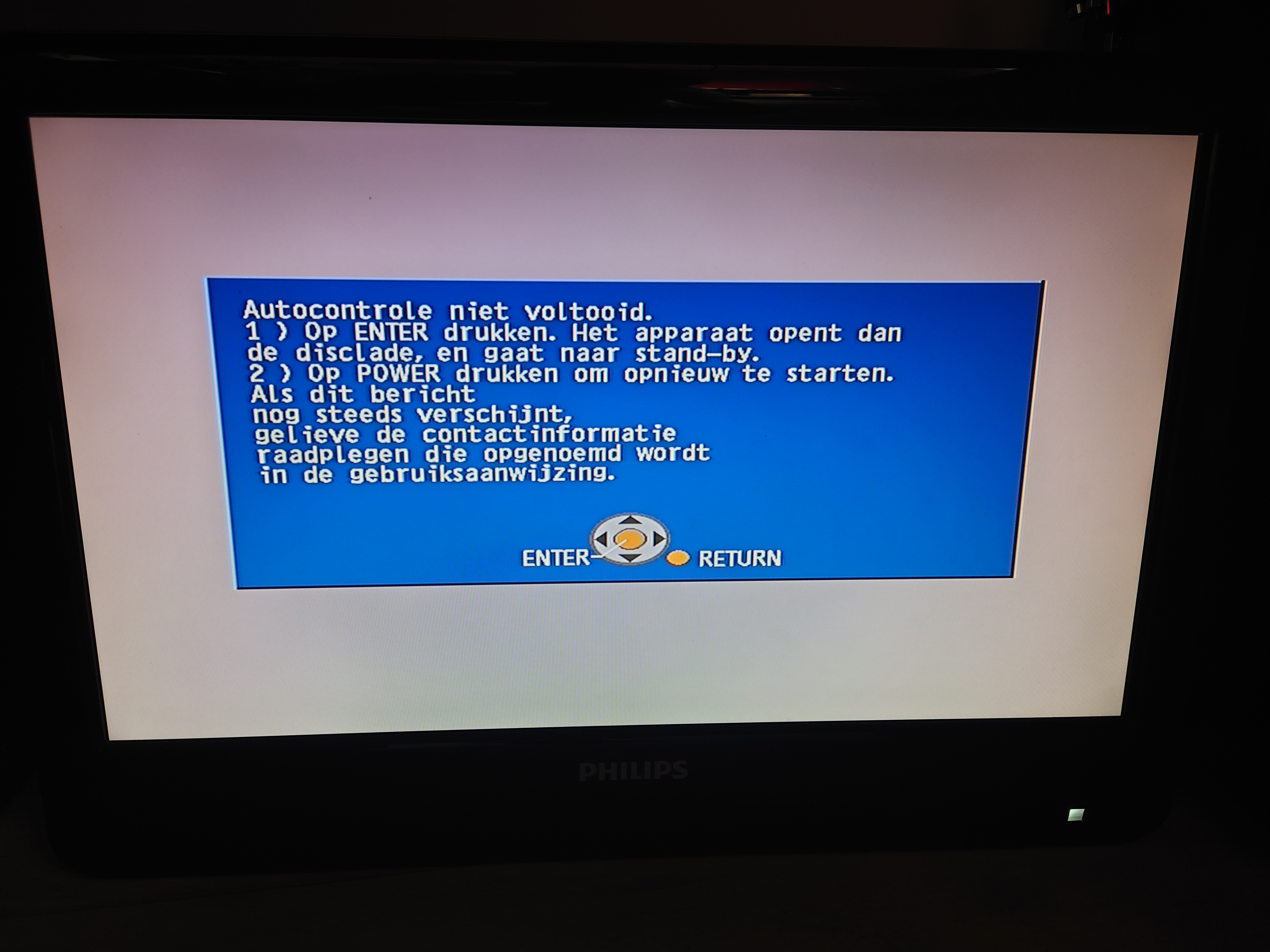

    I have seen the following error code a couple of times, although I'm not sure what prompted it: U61
    Which - according to the manual - means either:
    (When a disc is not inserted) Displays when a malfunction has occurred during recording,
    playback or copy. This is displayed when the unit is in the recovery process to return to
    normal operation; it is not broken. Once the display clears you can use the unit again.
    or:
    The unit is carrying out the recovery process. Do the following to eject the disc.
    1 Press [POWER O/I] on the main unit to switch the unit to standby.
    If the unit doesn’t switch to standby, press and hold [POWER O/I] on the main unit for
    about 10 seconds. The unit is forcibly switched to standby.
    2 While the unit is off, press and hold [■] and [CH ^] on the main unit at the same time for
    about 5 seconds. Remove the disc.
    Neither of the two offered solutions bore any fruit, the disk tray won't eject whatsoever and waiting for the error code to clear results in it going into standby without fixing it.
    Is there a way to manually eject it without taking it apart? I tried looking for that tiny hole to stick the end of a paperclip in, but can't seem to find one.
    And how would I go about doing a hard reset on this thing? The only thing I found in the manual regarding 'reset' was either pressing the power button for 10 seconds, which - again - doesn't do anything, or to select the 'restore default settings' option in the setup menu, which requires me to use a remote that I don't have.
    I've decided to keep the recorder and since I have been able to get a menu to appear on screen, I am considering to buy a remote. Or would it be a stretch to assume that it will respond to remote input when buttons on the device don't?

    Hard reset:
    With power off (stand-by mode), Press and hold [skip reverse] [Time Slip] [Eject] buttons on the units front for about 10 sec. Unit will go into Self Check Mode and then Display 'L1 TEST'. Now power off. Clock should be flashing 12:00. Turn power on and intial setup menu will be displayed on TV. Use also for DMRE50, DMRE55 AND DMRE85 models also.
    For the DMRE75V press both [dub] buttons and [eject].
    EH55:
    "You can either go into menu (pressing 'FUNCTIONS' button on remote) and look for 'RESTORE DEFAULT SETTINGS' or similar heading, or you can (while unit is on) on the front of the unit (not the remote) press CH UP and CH DOWN buttons together for 5 seconds - the unit will switch to standby. Give either one a try. (refer to page 60 onwards in your user manual - these pages detail 'settings')."

    I tried hard resetting with your instructions rgr, but it seems I have a different button layout on the front panel than what you are describing. I tried pressing/holding the buttons that came closest to your description and tried a few other combos; but sadly no result. See photo below for what my front panel looks like.
    [Attachment 73178 - Click to enlarge]
    There's some good news though: The device responds to the universal Panasonic remote I ordered. The downside however: I can't seem to get into a main menu of any kind, since it only seems to boot in some kind of auto check mode (which it can't complete according to the message prompted below).
    [Attachment 73177 - Click to enlarge]
    Rough translation:
    " Auto check incomplete.
    1) Press ENTER. The device will eject the disc tray and will go into stand-by.
    2) Press POWER to reboot.
    If this message persists, please contact the manufacturer."
    Pressing ENTER doesn't eject the disc tray and will just turn the device into stand-by mode.
    Is there a way to force open the disc tray? And should I? Because I'm guessing that won't stop it from going into this auto check loop...
