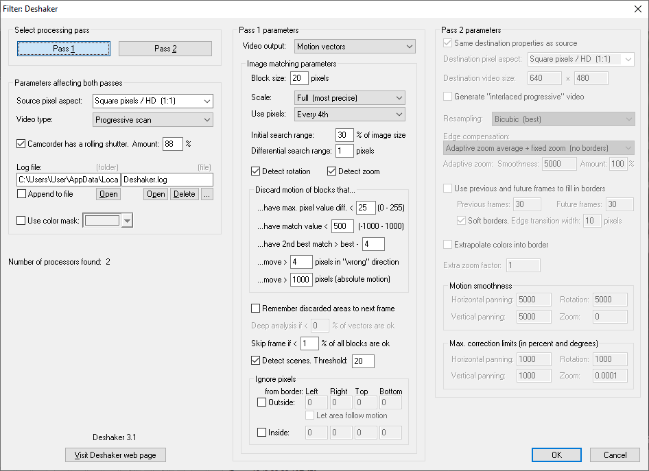

    Let's do some tests. Attached is the original file and after using Deshaker.
    If there are more, I will combine them into 1 comparison clip.
    I did only first half because my computer is slow.
    Proper filming is a key, use higher shutter speed and fix camera on your head rather than frame of your bicycle.
    This is Deshaker settings i used.

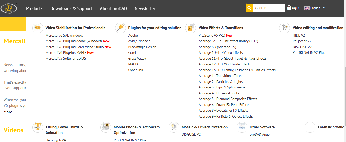

    Originally Posted by RGR
    Mercalii is only available for Vegas Pro X? The plugin will not work with Vegas?
    @RGR, it appears so. "Video Pro X" is actually "Magix Video Pro X" and "Video Deluxe" (German name) is Magix Movie Studio. Having a look at this from the Prodad website, it doesn't look like Vegas has a Mercalli plugin.
    [Attachment 83988 - Click to enlarge]

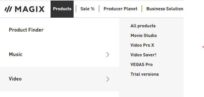

    But the full name is MAGIX Vegas (Pro etc.). I'll have to ask or check.

    Here are all the video products sold by Magix (from Magix.com):
    [Attachment 84019 - Click to enlarge]
    The only Vegas product is Vegas Pro.
