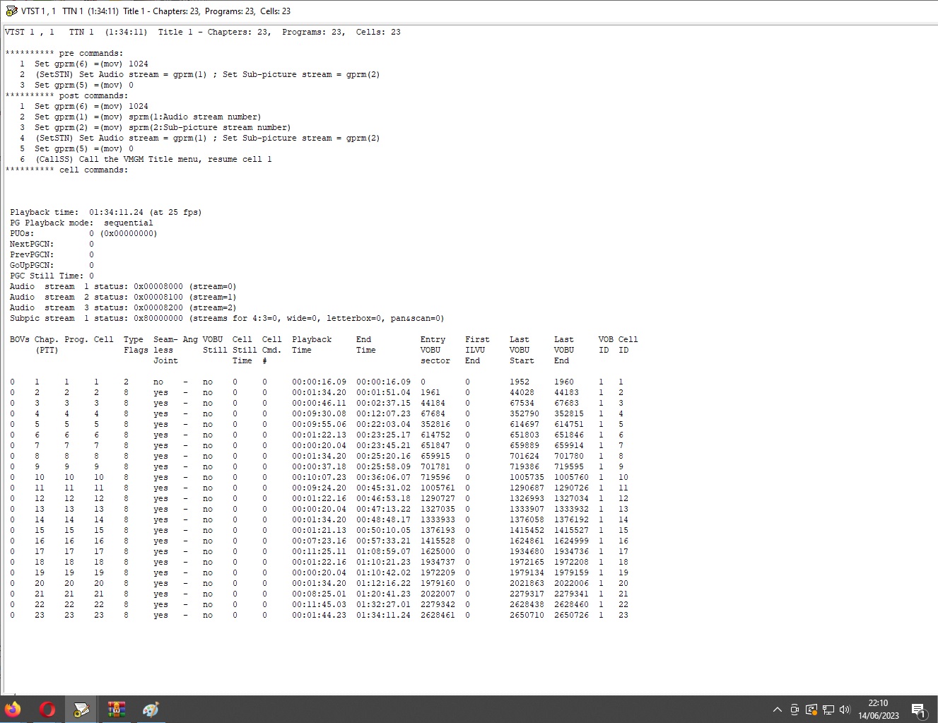

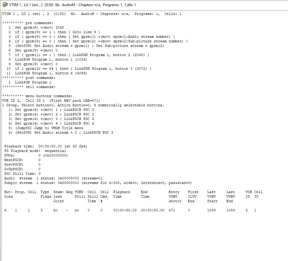

When I play the dvd, and select the new audio, it doesn't play and the Italian audio skips.
I leave these images so you can see that the audio and the button are added.
[IMG][/IMG]
[IMG][/IMG]
[IMG][/IMG]
the navigation prompts for the buttons are:
Spanish(add)---- (SetSTN) Set Audio Stream=2;Link PGCN PGC3
Italian ------ Set gprm(4)=(MOV)1;Link PGCN PGC3
Japanese ------ Set gprm(4)=(MOV)2;Link PGCN PGC3
Where could I have gone wrong?

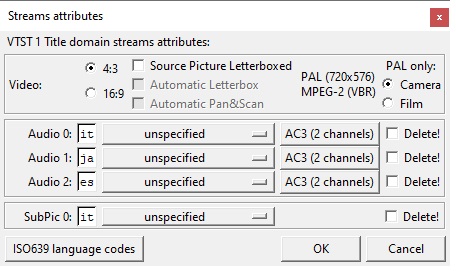

First, have you modified the "audio track to stream map" to include the new audio stream ? Double-click the PGC with the movie to open the PGC Editor. In the editor, you should see the two original streams. It yours is missing, add it in the third position (#2, and use normally the stream value 0x82 if the audio track has been added correctly after the two original tracks). Check the DVD, but it's probably not sufficient.
IMO, you should use this button command for the Spanish track:
Set gprm(4)=(MOV)3;Link PGCN PGC3
Then, check the DVD. With some (much?) luck, that may work immediately.
If that doesn't work, try to follow the navigation (with the PgcEdit Trace feature). You should begin with PGC 3, where the button command links. Continue to trace and see where the gprm(4) is used. It's probably in a PGC where gprm(4) is tested, and according to its value, the right SetSTN command is issued, or, possibly, another gprm, perhaps gprm(1) is modified with the right audio stream value. You may have to add a new test and a new SetSTN or a new Set gprm command in that PGC.Last edited by r0lZ; 12th Jun 2023 at 07:48.

I modified the "audio track to stream map" to include the new audio stream, in the third position with stream value 0x82 .
I already set gprm(4)=(MOV)3;Link PGCN PGC3, and the original audios (Italian and Japanese) come out fine, but the Spanish button, direction to Italian audio.
I tried to follow the navigation, and due to my inexperience, the only thing that I have made clear is that the audio is added, but in the gprm, no button has been assigned to it.

OK, it seems that you have added button 6. According to the screenshot editor, its command is (probably) correct. But according to the dump of the PGC, its command is Set Audio Stream 2; LinkPGCN 3. Difficult for me tu understand what's wrong with conflicting information. Anyway, it seems that gprm(4) is used to store the audio AND the subtitle stream numbers. It's probably because its value 3 is used to set the subtitle that it doesn't work fore the audio. Unfortunately, I can't help much more without knowing the content of the PGC where gprm(4) is used to store the audio and subtitle stream numbers in gprm(1) and gprm(2) respectively.

I told you to send me a backup, NOT the whole DVD ! It has been a pain for me to download only the IFOs. Anyway, I did it.
So, IMO, I have found the solution, but verify if it works correctly, especially the audio (of course) but also the subtitles.
For your new button command, use this:
[71 04 00 04 00 03 00 03] Set gprm(4) =(mov) 3 ; LinkPGCN PGC 3
Note that you must link to PGCN 3, not 4 !
Then, select the next PGC : VTSM 1, LU 1 (en), 3 (dummy)
Right-click command 2 and select Duplicate.
Select the new command (now command number 3) and change it to this:
[71 A0 04 01 00 02 00 03] 3 if ( gprm(4) == 3 ) then { Set gprm(1) =(mov) 2 }
This should be the content of the modified PGC:
Code:********** pre commands: 1 Set gprm(1) =(mov) 0 2 if ( gprm(4) == 2 ) then { Set gprm(1) =(mov) 1 } 3 if ( gprm(4) == 3 ) then { Set gprm(1) =(mov) 2 } 4 (SetSTN) Set Audio track = gprm(1) 5 Set gprm(9) =(mov) 1 6 LinkPGCN PGC 2 ********** post commands: ********** cell commands:
This simple edit should work, but as I wrote above, be sure to test the DVD carefully. (You can do it with the Trace of PgcEdit, or use a player that can play the IFOs in the folder.)
Good luck !r0lZ - PgcEdit homepage Hosted by VideoHelp (Thanks Baldrick)
