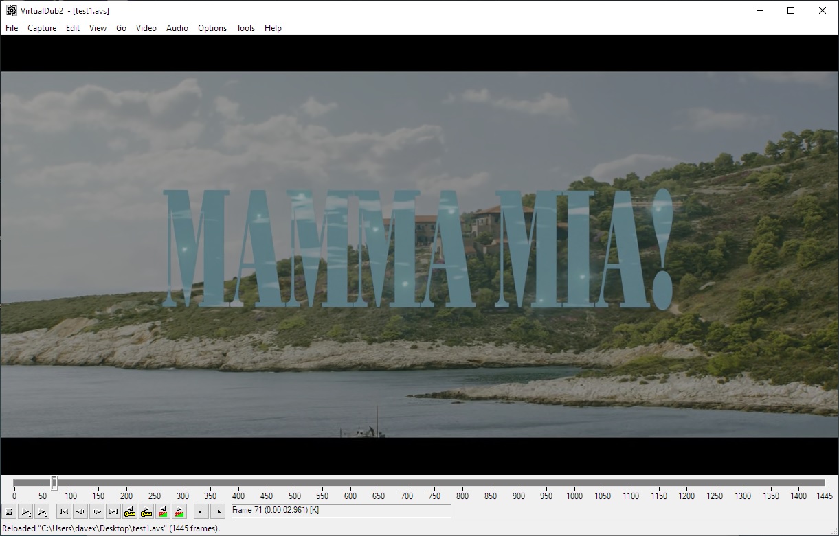

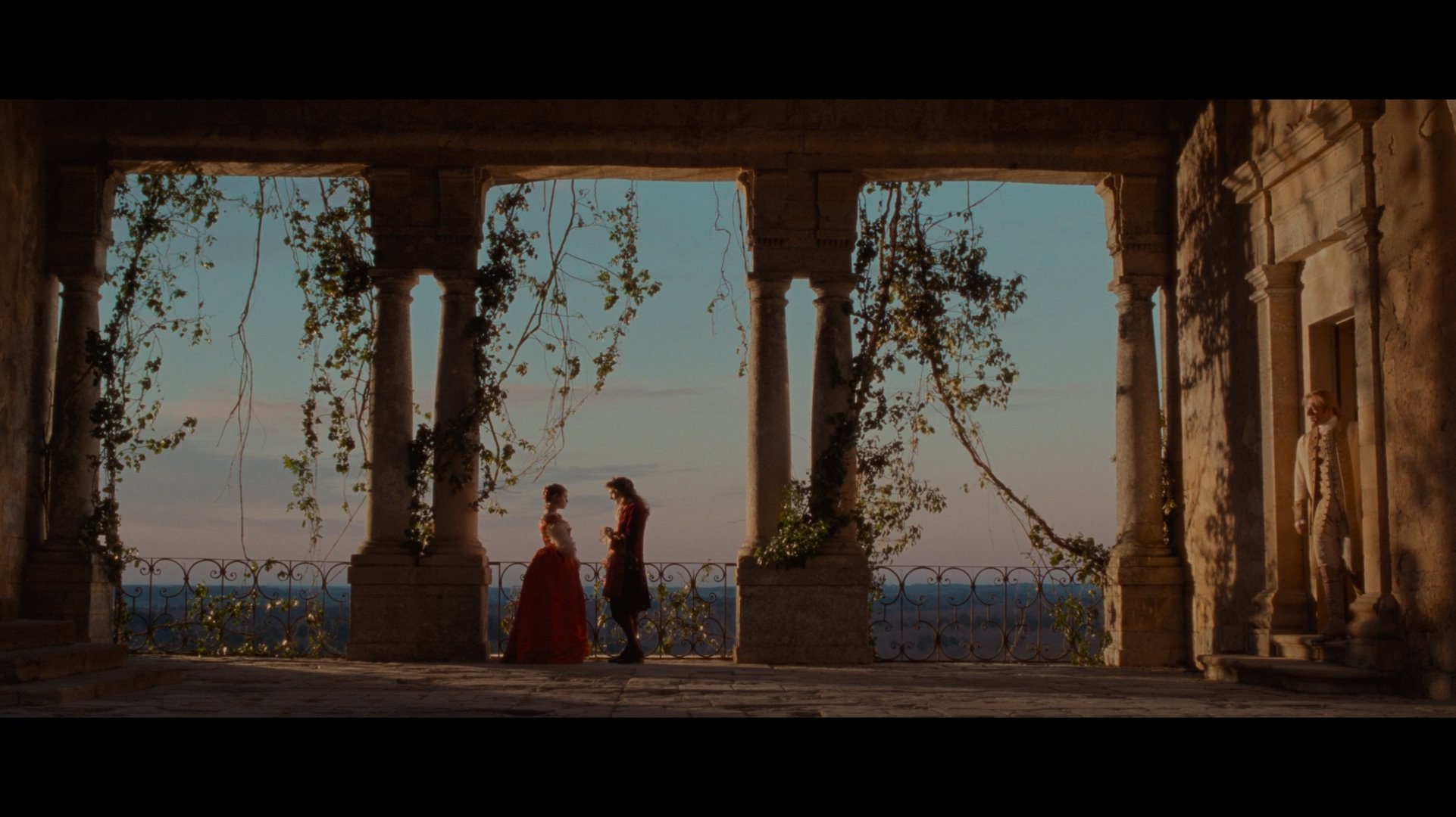

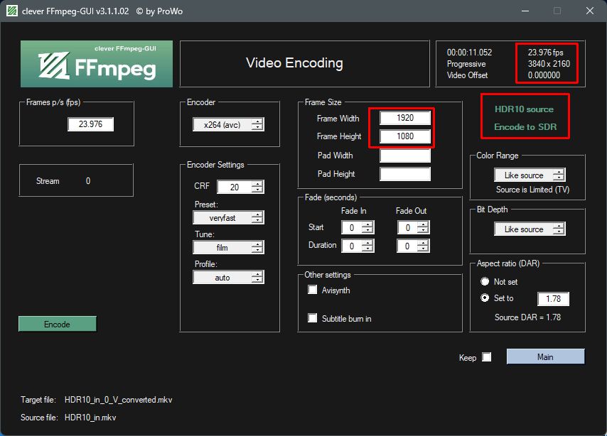

  8. You can do the colorspace change and the resize at the same time.
    Take clever Ffmpeg-GUI, load your video, click main, click encode videostream, click resize.
    Make your settings and click encode.
    [Attachment 71533 - Click to enlarge]

    ProWo: Wow, excellent timing (and thanks for your reply). I went hunting for an FFMpeg GUI yesterday and settled on clever FFMpeg-GUI for my first to try (thanks for your GUI, too; I especially appreciated the set up guide upon first opening), so thank you also for the above picture. After color conversion and resizing I plan to encode the result with my usual AviSynth script using MeGUI (denoising, sharpening, debanding, etc.), so I'd like to do the first bit losslessly. I'd normally use VirtualDub2/UtVideo; do you have a recommendation for a lossless codec in clever FFMPeg-GUI?

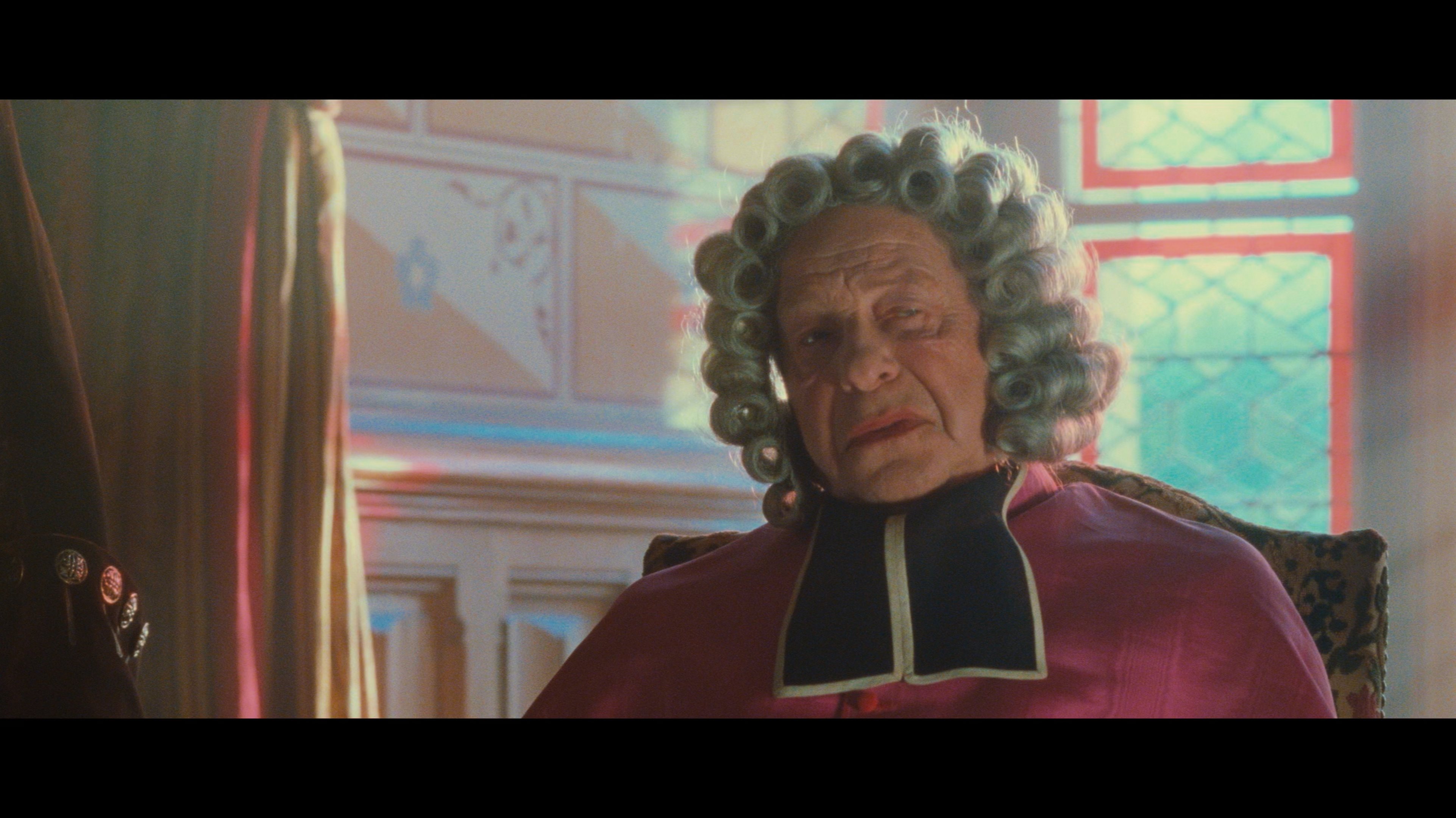

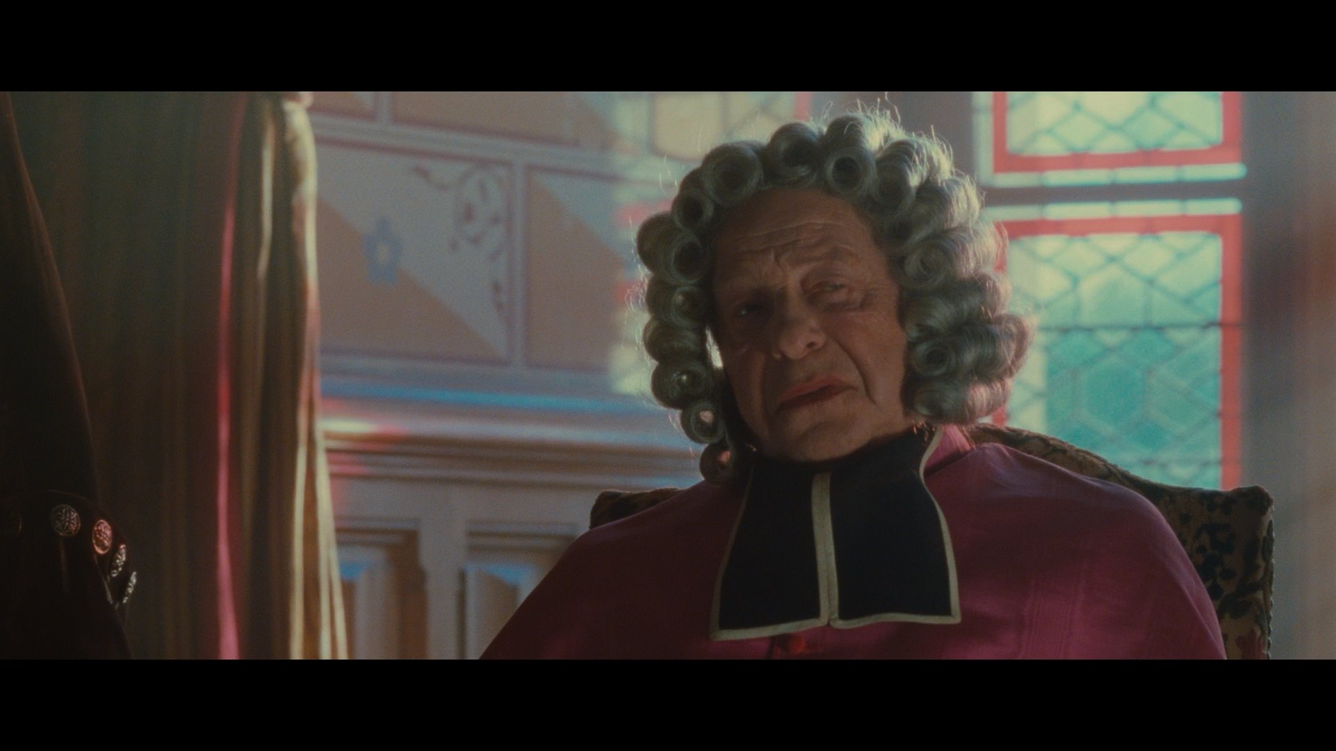

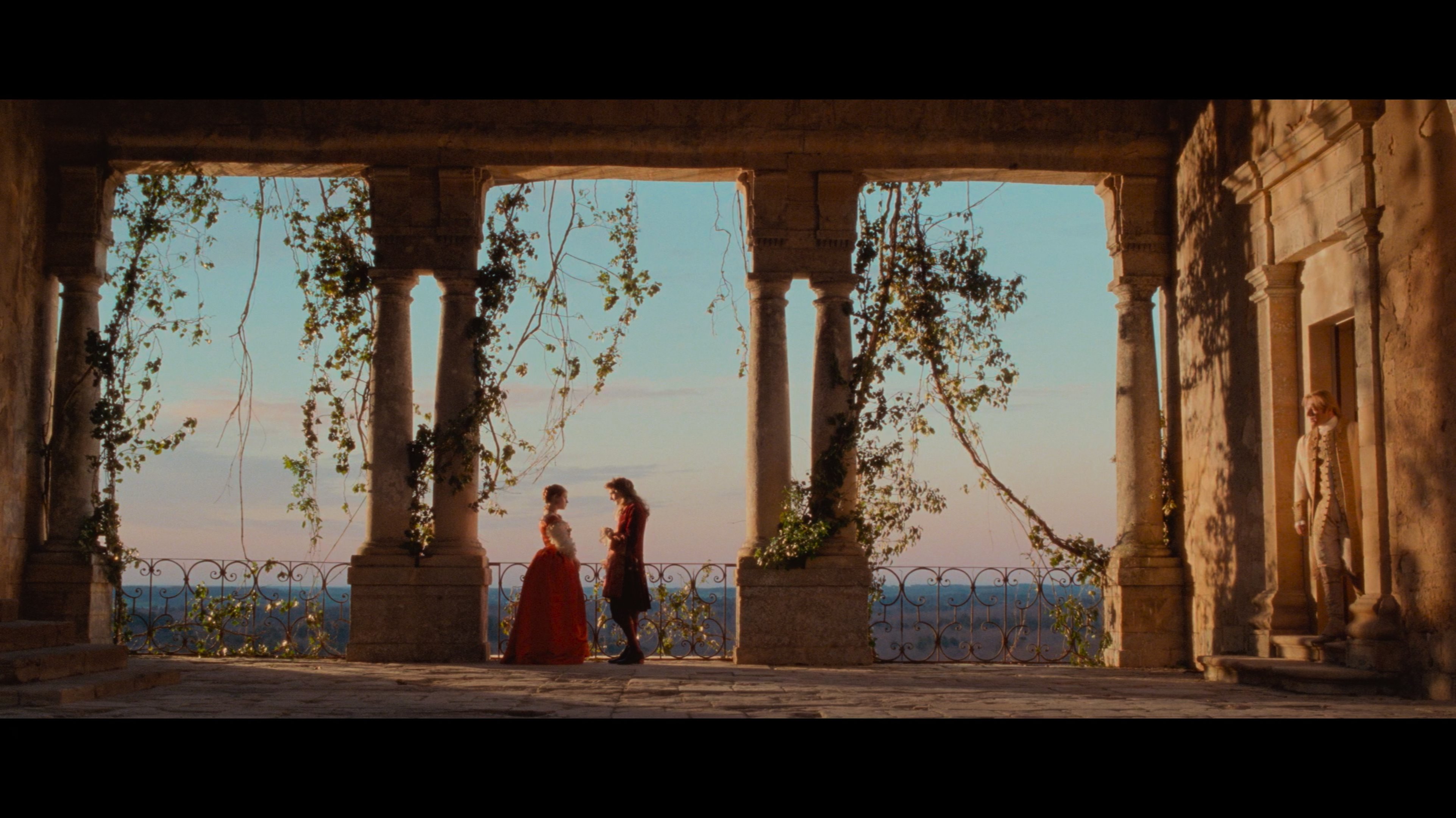

  18. Having some time this weekend I ran some tests on a short clip to compare six different methods of tonemapping:
    1) AviSynth[davexnet's Above Script + Downscaling]
    2) clever FFMpeg-GUI[Reinhard + Downscaling]
    3) clever FFMpeg-GUI[Hable + Downscaling]
    4) HandBrake[Colorspace BT.709 + Downscaling]
    5) Avidemux[Reinhard + Downscaling]
    6) Avidemux[Hable + Downscaling]
    I didn't note speed because not every method displays that information and I did no fine-tuning of the settings because not every method allowed for that. Here are the results (in the above order):
    1,1:
    [Attachment 71652 - Click to enlarge]
    2,1:
    [Attachment 71653 - Click to enlarge]
    3,1:
    [Attachment 71654 - Click to enlarge]
    4,1:
    [Attachment 71655 - Click to enlarge]
    5,1:
    [Attachment 71656 - Click to enlarge]
    6,1:
    [Attachment 71657 - Click to enlarge]
    1,2:
    [Attachment 71658 - Click to enlarge]
    2,2:
    [Attachment 71659 - Click to enlarge]
    3,2:
    [Attachment 71660 - Click to enlarge]
    4,2:
    [Attachment 71661 - Click to enlarge]
    5,2:
    [Attachment 71662 - Click to enlarge]
    6,2:
    [Attachment 71663 - Click to enlarge]
    To my eyes the results with HandBrake are the worst, but to be fair I'm running Win 7 and the last version of HandBrake I can use, 1.4.2, is verrrrrry old. I also think the davexnet's AviSynth script is not so good but, again to be fair, I don't know enough to make the necessary adjustments (although I'm sure davexnet does ). Clever FFMpeg-GUI with Hable is a bit dark, but it's results with Reinhard look good. Avidemux's two results are quite similar but I find the Hable a bit too bright. So, down to clever FFMpeg-GUI with Reinhard and Avidemux with Reinhard I'd pick clever FFMpeg-GUI for the indoor scene, given it's light from candles and through stained glass, but Avidemux for the outdoor scene. Both clever FFMpeg and Avidemux's settings are tweakable so I'd do some more testing until happy (or I could beg ProWo for some advice ).
