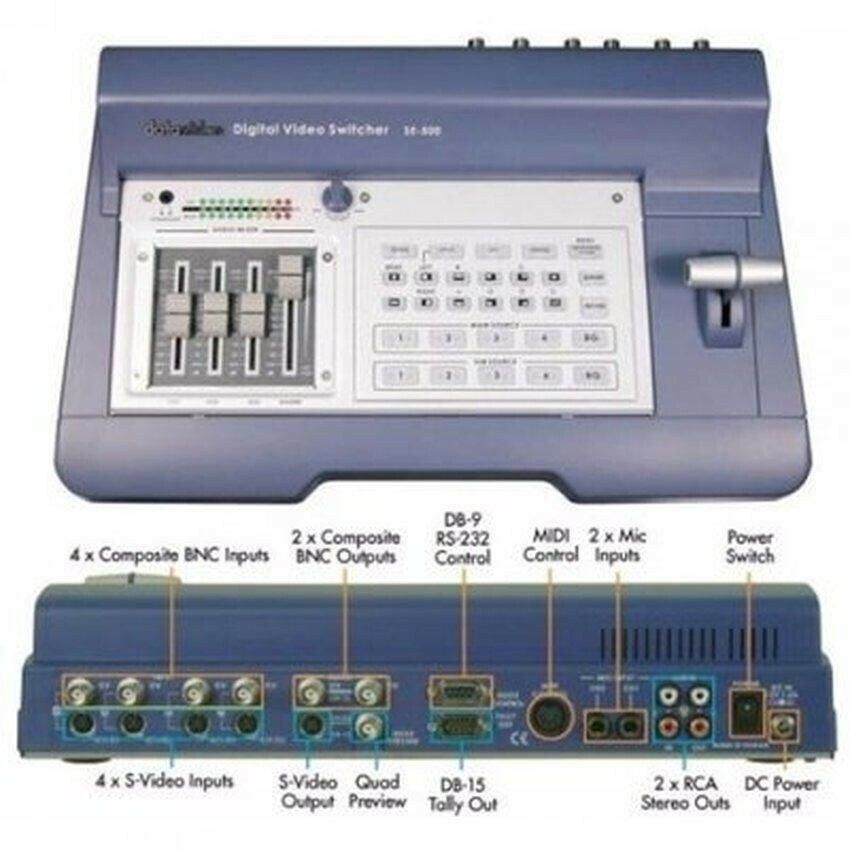

  1. I have just bought one of these unit to see if these are able to UN-skew old VHS (using some sort of integrated frame-sync technology) like TBC can do...
    anyone know if this unit (standard one... not the HD) is older than the DATAVIDEO TBC-1000 or something more recent (looking at the anspect seems more recent)
    very thank you to anyone can give me some informations about this unit.

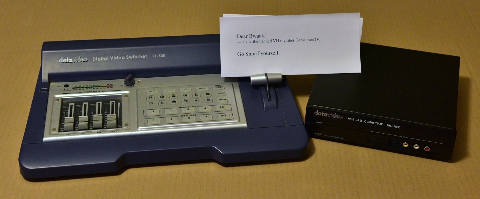

    Originally Posted by Bwaak View Post
    LS went for #4, not confirming his personal experience with the device
    I've addressed your concerns in the attach image.

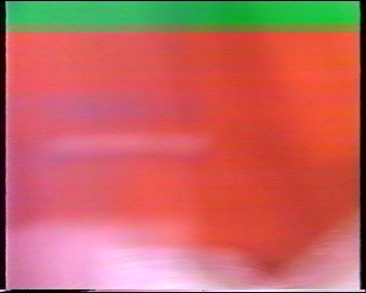

    ok... you are right .... here what happens using the cheaper VCR .. on top of the screen there is a band that have wrong colors...

    Is the above screenshot with or without the SE500 ? If it is with, then how does the same clip look without it?

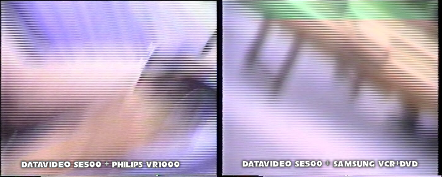

  14. the screesnhot is from the output of SE500... the original frame (on the previous post) are completely RED... (the top green band is not present..)
    using the Philips VR1000 i have no issues... using 2 different Samsung ccombo VCR-DVD i have the top of video always with wrong colors...
    here animage showing 2 VCR... the Philips VR1000 and the samsung connected to the SE500... the top greenish part sometimes is RED if the background is blue (on the sky for example) and size is changing randomly (this is the maximum that it can reach)

    Nice! The image from the Philips is more straight and without defects. Can you remind me why did you get the SE500 if the Philips has built-in TBC? Were you getting vertical sync issues? I am curious, how does the same picture look from the Philips but without the SE500?
    EDIT: Oh, I guess because the picture from teh Philips is less sharp than from your old Samsung, and you wanted to use the Samsung stabilized by the SE500? But looks like the Philips is the way to go.

  16. If i never seen the Samsung COMBO output quality (a lot better than the Philips VR1000.. with or without integrated TBC active) i would have been happy with SE500+VR1000.... but right now i think that my major issue is the Blackmagic Intensity PRO ... that generate a lot of black frames (a known problem for 10 years) during Composite/Svideo acquisition... (Selur the maker of Hybrid helped me creating a special "plugin" to remove black frames ... replacing them with interpolated sequences but i will found something to fix this... probably a new capture card)
    the VR1000 is great to remove the "skew" of clips... but if the VHS quality is very HIGH ( from miniDV Svideo ... from SVHS) i need to use the Samsung to have the better quality possible... i will wait for the German GSE MPE-200SX mixer that is made for VHS, i'm a bit worried about how many horizontal lines can handle... but i need something to "stabilize" (not a TBC) the Samsung output to make Intensity PRO able to take every frame.

    Um... okay. I am still not sure how the Philips output looks like without the SE500 on the same scene as you showed above. Because it has built-in TBC, so I wonder how much the SE500 helps. Does the Philips straighen the frame, while the SE500 ensures there are no black flashes with the Blackmagic? It seems that the Blackmagic box is extremely sensitive to timing. Maybe replace it with something else?
  18. you are right... the real issue can be the Blackmagic Intensity PRO...
