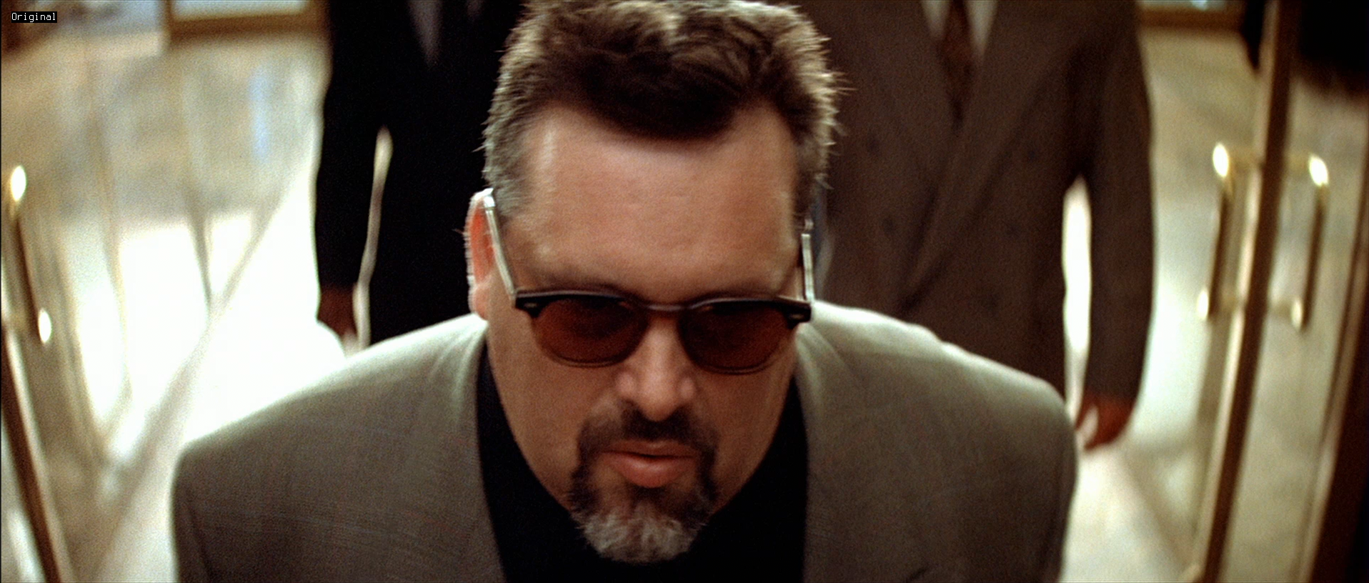

  19. For general amusement, I attached what codeformer does. *gig*
    Cu Selur
    users currently on my ignore list: deadrats, Stears555
  20. what is codeformer ? Looks funny. He has different glasses
    But i decided now to take SMDegrain
    In some scenes i liked it more but when i watch the film on tv i see actually not a very big difference between 10mbit/s SMDegrain and TemporalDegrain2. Because SMDegrain is 2.5 times faster, i used this (and 60FPS RIFE 4.6).
    But both makes good results i think.
