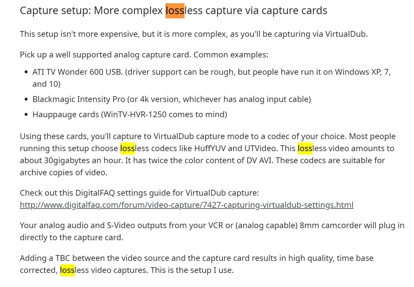

    ^ I thought "lossless" methods were considered the top notch best way. Using a TBC> capture card >Virtual Dub, would be keeping it as original as it can be.
    Source: https://www.reddit.com/r/DataHoarder/comments/j4rwk1/the_how_do_i_digitizetransfercapt...e_video_tapes/
    [Attachment 71401 - Click to enlarge]
    So is "Uncompressed" (100gb/ hour) considered even more superior than the lossless Capture Card method? Is that even better since there is no compression at all?

    2. 10bit uncompressed is certainly lossless (meaning no loss). 35gb per is also lossless and the normal size/format for video capturing and post-processing. Uncompressed is generally just too be for practical handling. I'd be wary of ProRes; I understand it's a good lossless codec but may not be compatible with consumer video editors if you want to edit it yourself later. One of the big issues with home video is the endless hours of footage.
    Should I question them if they use VirtualDub and what Codec? Such as Huffyuv.
    It's probably not relevant. VDub isn't the be-all and end-all. It would be worth asking what codec you'll get for your lossless files (although that would be covered by question 2).
    Yes.
    No. Just larger.
    And overkill. Measurebating. "Mine bits are bigger than yours!" Mean, the input source is like 6-bit dithered, not even 8, much less 10.
    No, but you don't want to ask what software. If they're using crap like OBS or Pinnacle Studio, run away fast. Amateurs.
