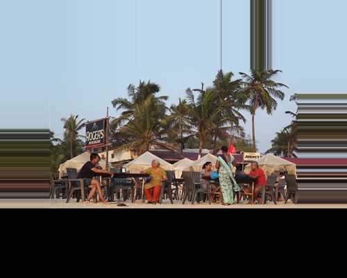

  1. I have noticed wired effect when using filter Motion and few other third party filters for VirtualDub if i zoom less than 100% or rotate video borders getting filled by pixels. Its also in original VDub and VDub2.
    Is there any solution i can attempt?
    Built-in filter Rotate2 does not produce this effect so i don't think its my video card driver issues.
    But what i need is to have rotation animated between frames not just happen.
    I even went back to VDub v1.4.13.14328 and still same bug.

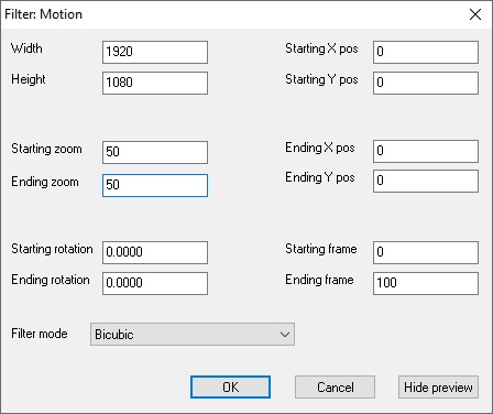

    Name of the filter and link was in first post, https://www.rationalqm.us/motion/motion.html
    This settings will produce the problem.

  5. No problems here at all with VirtualDub2, 32 bit. Hide preview before changing settings.
