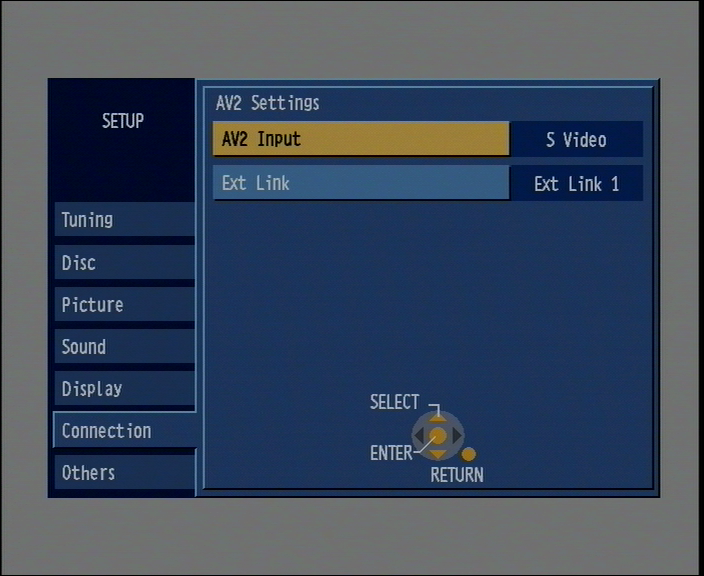

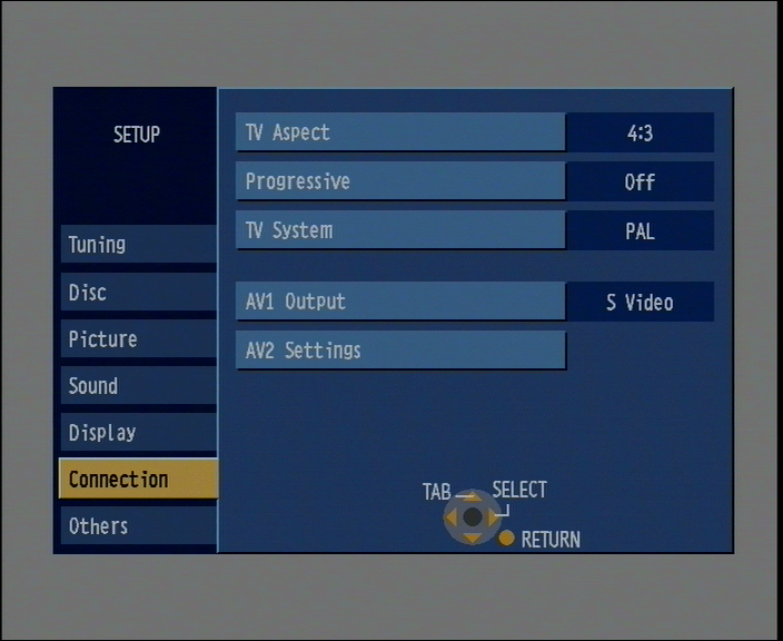

The I/O configuration seems to be correct. Here's some stills for clarity.
[Attachment 71383 - Click to enlarge]
[Attachment 71384 - Click to enlarge] -
