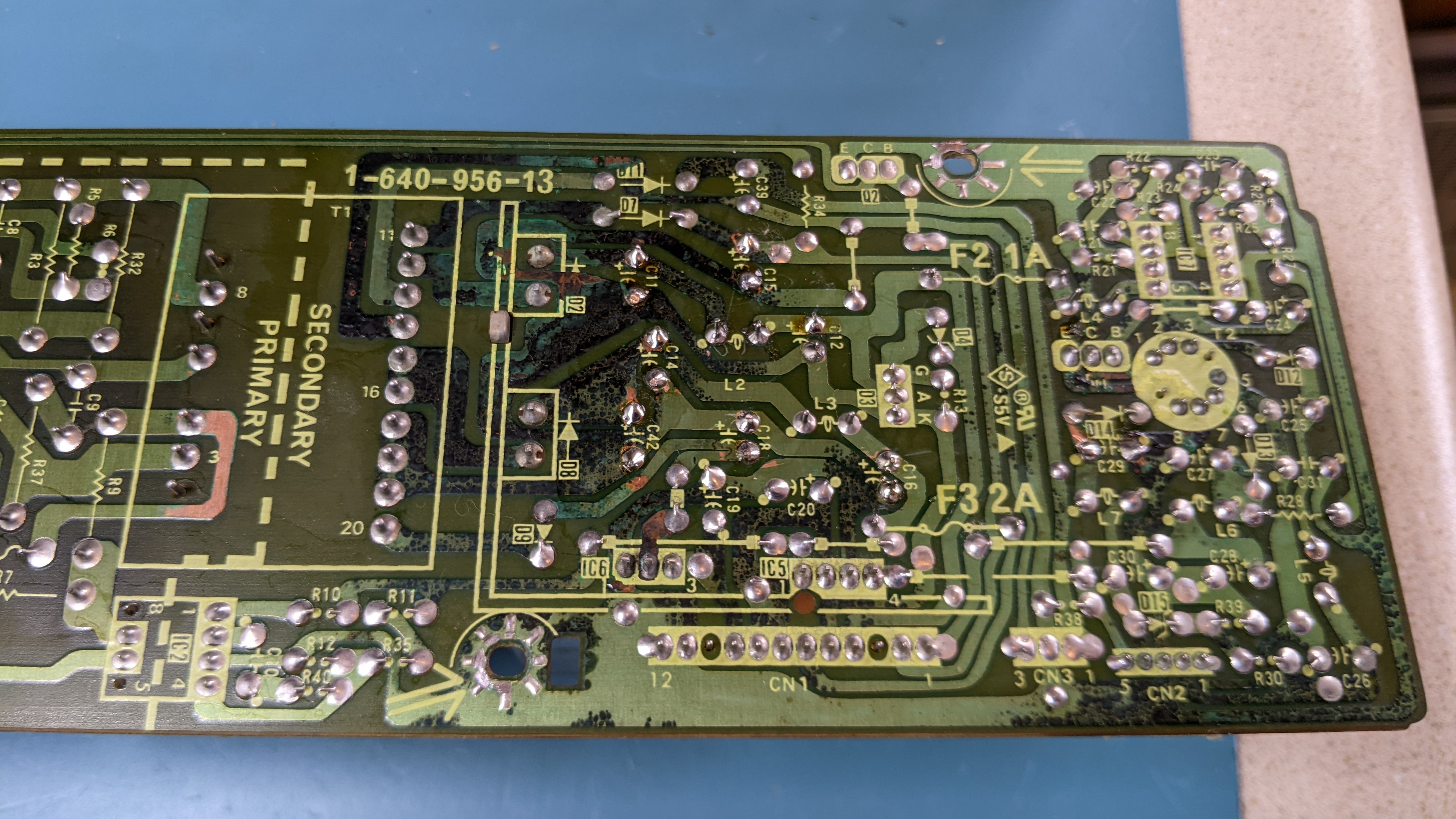

  7. Pulled the Power Supply board out and tested voltages on the connectors. It looks like an electrolytic cap had exploded before. There are corroded board areas on both the front and back side of the board. I cleaned the two connectors and board pins with IPA. CN2 had some oily substance on the pins and connector shell. All unswitched voltages seem good with no load. I also found a fuse F2 that had been jumpered with a wire. I need to order a replacement.
    [Attachment 71429 - Click to enlarge]
    Jan 2016
    If a capacitor shorts out and started blowing fuses that explain why idiots put a direct jumper wire across the fuse terminals which will transfer the load to the capacitor and pop it. I've seen it happens over the years, no surprise at all. I just hope that bridging the fuse did'nt overheat some chips and caused damage to them, Also make sure the copper traces are not corroded thru and lose their connectivity.
  9. Can't find one that looks like what's in there now. I think this littlefuse should work OK. I need 1A.
    [Attachment 71431 - Click to enlarge]

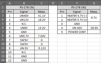

  12. First, I started to monitor the voltages coming out of the Power Supply connectors CN1 and CN2.
    - All voltages on connector CN1 look good, but when switched off pins 7 & 8 SW5V are -0.55v when switched off?
    - Power Control signal on CN2 Pin 5 in normal operation measures 0v when power button is off and 5.06v when On.
    - When the Power Button stops working Pin 5 stays at 5.17v instead of 0v.
    - The Power Control signal goes to the enable pin on the 5v regulator (IC5). When the signal is high, the output is on, low output is off.
    - So, in the failed state, SW5V is on.
    - The signal comes from IC005 Timer/Tuner/LCD Control on the FL-46 board.

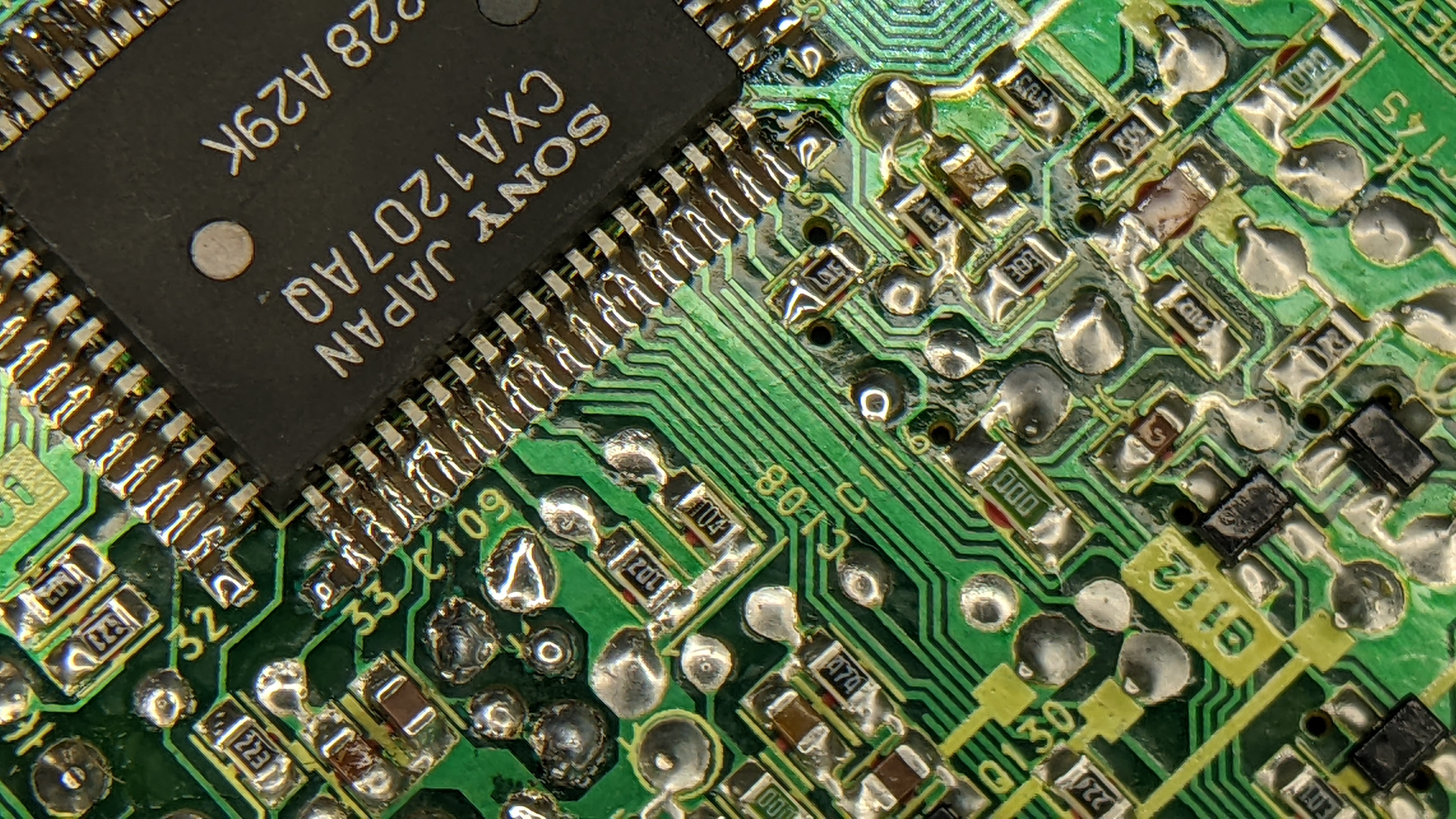

  17. I came up with an experiment to see how long it would play before being non-responsive and to isolate the problem to a board or component.
    - Start play, stop, turn-off, turn-on then play... repeat every min. It went for about 8 min. before locking up.
    - Put a fan blowing room air directly on the top board VI-104. Worked fine, did not lock up.
    - Lifted up the board and put a fan blowing on the backside of the board. Locked up in about 6 min.
    - Put fan back on the top side while covering 1/2 of the board with cardboard to determine which half of the board the problem was on.
    - Covering rear side of board locks up in 10 min.
    - Covered front 1/2 of VI-104 and it ran good for 10 min.
    - Managed to isolate it to the "big" chip on the board, Sony CXA1207AQ (Luminance Signal Processing) by covering all but this chip
    - With fan blowing on it, it seems to work fine... turn the fan off and it locks up after a time
    - (It could also be a component in the vicinity of the chip. I'll check ESR of any caps nearby)
    - Next, I'll look for any damaged traces or via holes nearby, then I'll reflow the IC pin to board solder connections in case of a cold solder joint.
    This has been a tough one to troubleshoot.

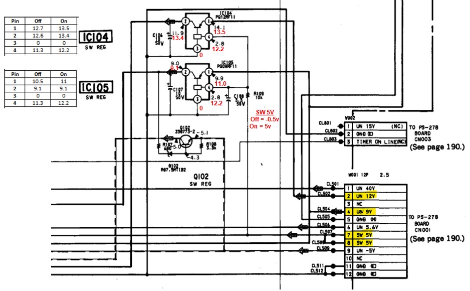

    Since the problem seems to occur when you turn-on/turn-off the unit, I looked at which voltages get turned-off with the Power Switch. (see diagram)
    * The power supply has a switch for controlling the SW 5V signal output.
    * That switched 5V also controls Pin 4 of two switched voltage regulators (9V & 12v) on the DS-55 Mode Control board.
    * The schematic shows the 5v goes thru a dropping resistor to 2.4v connected to Pin 4 for the two regulators. I measured 12.2v regardless of whether the switched 5v is 5 or 0.
    * Looks like IC104 (PQ12RF11) is bad. I'll remove the part and see if I get my 2.4v control voltage back.
    [Attachment 72305 - Click to enlarge]
  19. Pulled the 12V regulator, IC104, then tested control On/Off voltage on pin 4 of both IC105 and IC104 and both read 5v. Tested transistor leads and all show open. Ordered a new part.
