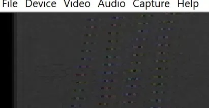

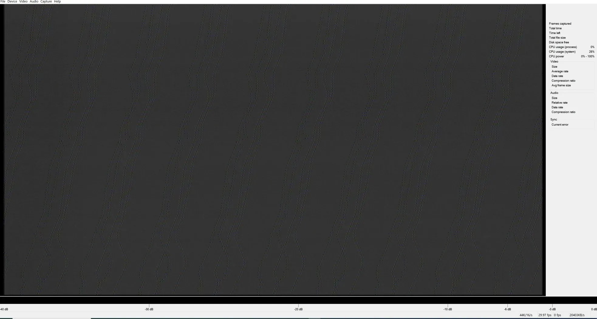

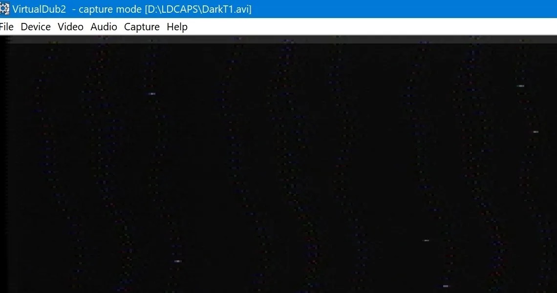

    Update:
    ANY connection, either VHS or LD input). You can still see the interference w/ the TBC, its not pure black. there's movement. I changed cap cards, and from laptop to desktop, and changed outlets to a different room. Its the same. If its both the vhs player and the LD player, and any cap card.. its not those devices, its the house, imo. I just need to know WHAT in the house is causing it. I relocated to a different room, everything off, using a different laptop, and cap card. Same interference. I'm concerned its a whole-house ground loop or bad wiring or something. Image
    [Attachment 82307 - Click to enlarge]
    [Attachment 82308 - Click to enlarge]
    [Attachment 82309 - Click to enlarge]
    Video file attached is showing movement/noise even w/ the TBC on.
