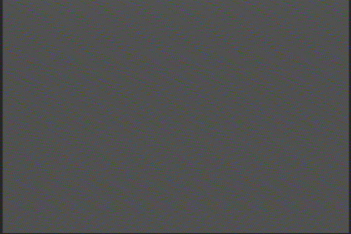

    Ignore the above, here's a better example:
  16. Captures & Restoration lollo's Avatar
    Jul 2018
    Italy
    I only see black frames in both files
    Feb 2006
    Then you may need to calibrate your monitor? Its subtle, but its there

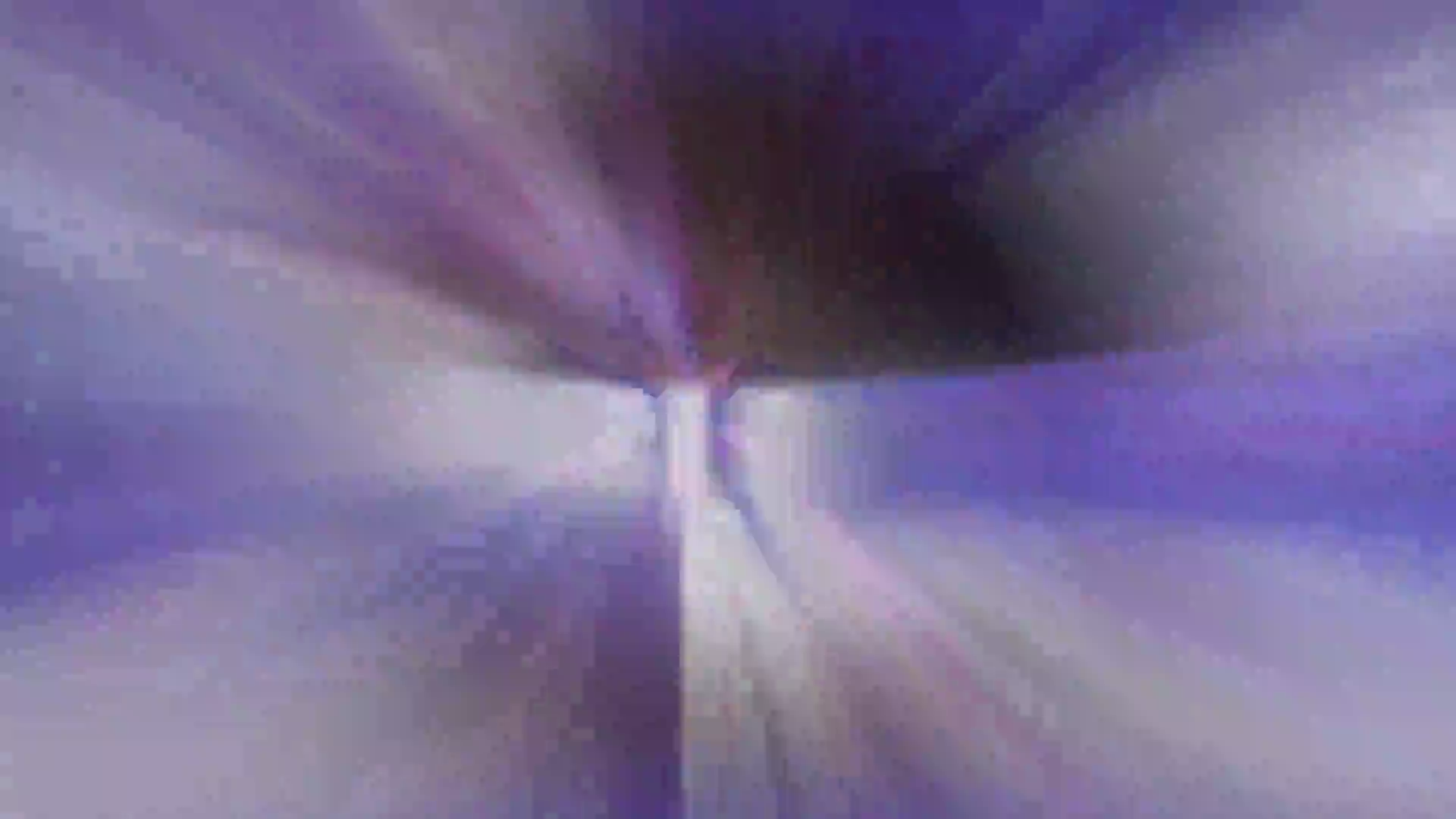

    Here I boosted the brightness and gamma a little, there's diagonal cascading swirly red-green-yellow-purple-orange dotted lines:
    [Attachment 71406 - Click to enlarge]
    And a zoom-in on the noise:
    [Attachment 71407 - Click to enlarge]
    (see attached video)
    Thanks again

    And when you connect the RCA input from the LD to the VC500 in addition to S-Video and capture from it or you capture from RCA the pattern is not present.
    Difficult to conclude without a comparison with another Y/C source, sorry. Somebody else may have better hints...
