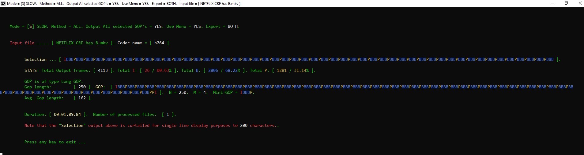

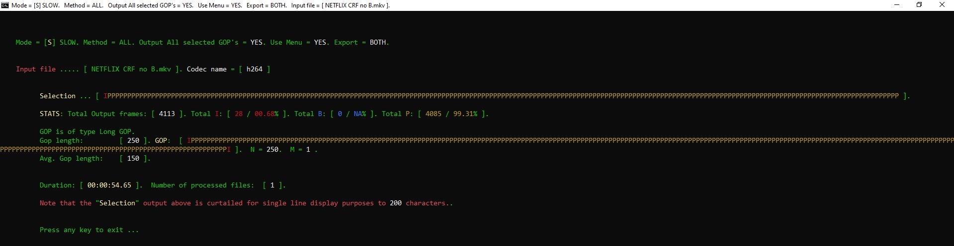

    May be of interest, average GOP varies between 2 files ...
    [Attachment 71347 - Click to enlarge]
    [Attachment 71346 - Click to enlarge]
    How does one give/create a link to a file in a post as sophisticles has done in his #1 post ?
