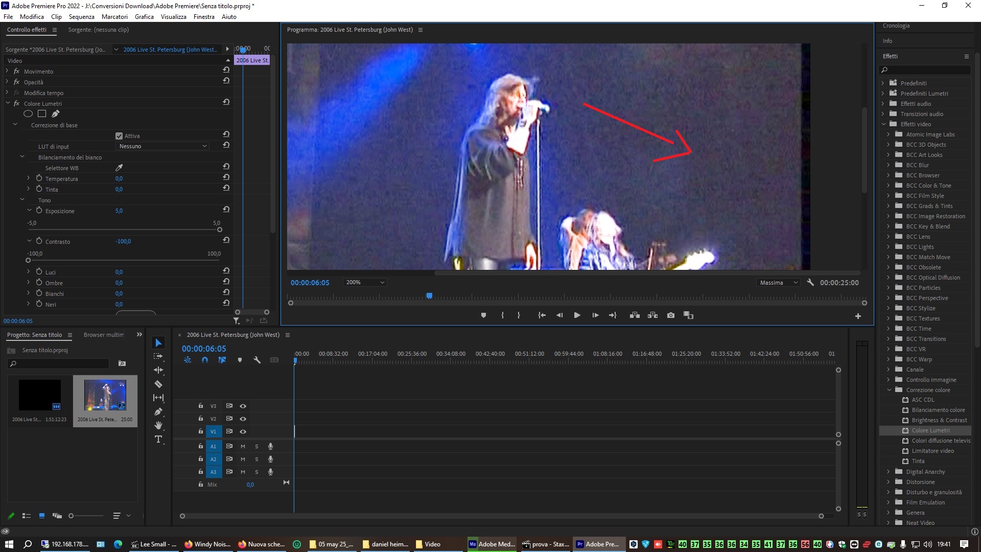

  3. No, the deblock doesn't help, but Probably I found the culprit. I opened the file in Premiere and with Lumetri I given +100 to Exposure and -100 to Contrast and I found that probably this is a chrominance noise problem. Now please can you suggest me the best denoiser and the settings only for chrominance noise? Tell me if I am wrong on my hypothesis thanks.
    I have the latest version of Neat Video. Can you suggest me something better for Chorminance Noise. that I can use with Staxrip or without using Premiere or this is the best Denoiser?
    This is a video that I have deinterlaced with QTGMC (after Checkmate). If you want to suggest something that I can use in the same process and QTGMC or some function for chrominance noise of the QTGMC, let me know, thanks.

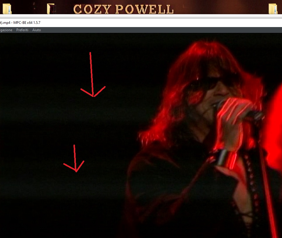

  4. Those are posterization artifacts. But it's not clear to me if that is the source you are starting with or the result of your encoding. If the latter you just need to encode with a higher bitrate and bit depth. If the former it's hard to fix but you need to work at a higher bit depth, apply a debanding filter, a temporal noise reduction filter, and dithering. Then use sufficient bitrate when you encode.
    And yes, lowering the black level can crush that noise away (along with other dark details).

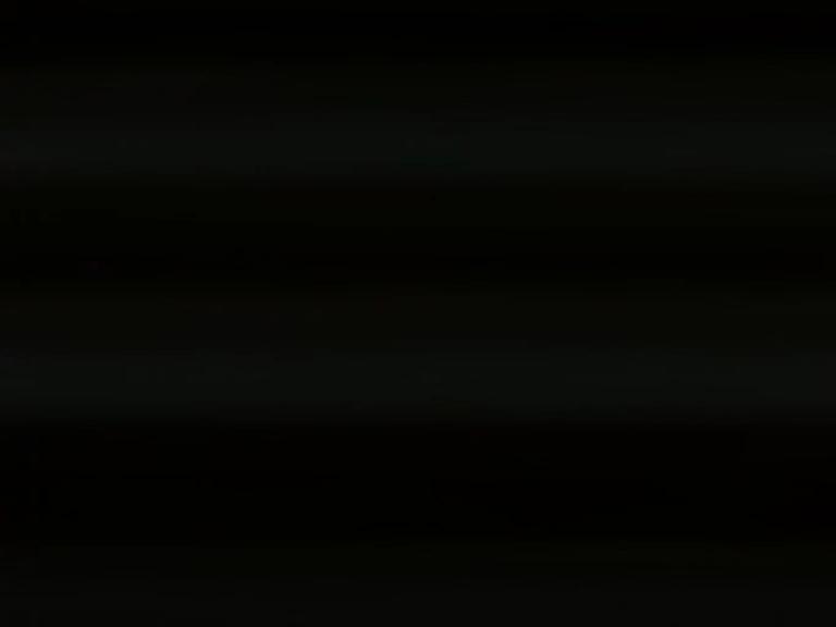

  5. This is the original. In this image with Exposure at maximum value and contrast at minimum valuee you can see the problems:
    [Attachment 71327 - Click to enlarge]
    I tried with derainbow and chubbyrain but these doesn't resolve the problems.
    Please can you explain me temporal noise reduction filter, and dithering and what filters and what settings you used?
    I know that with QTGMC It's possible to denoise, but can QTGMC handle chrominance noise and how to use it?

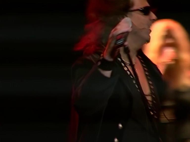

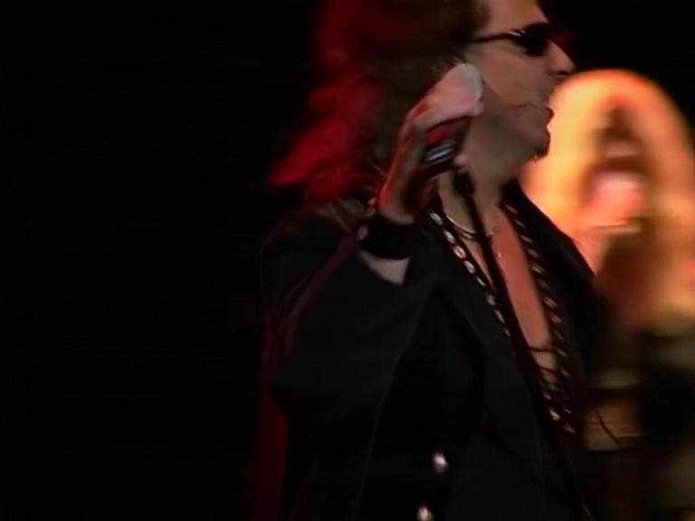

  7. No, the deblock doesn't help,...
    Worked here, to illustrate what I had in mind:
    Original:
    Retinex: (to make problem visible)
    Masked DPIR (luma <= 30) + Retinex:
    Masked DPIR (luma <= 30) + Flash3kDB + Retinex:
    Vapoursynth script used: https://pastebin.com/jT3FwZBa
    (all used filters are available for Avisynth too)
    Cu Selur

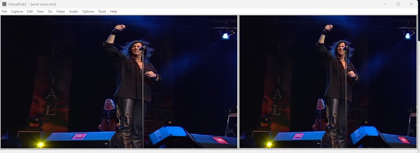

    1) how can you tell if a video has a wrong aspect ratio?
    16:9 on the left, 4:3 (768x576) on the right. Check the heads.
    [Attachment 71366 - Click to enlarge]

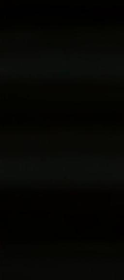

  14. Do the light bands move up and down? Are they stationary? You'll need to provide a video sample.
  15. It looks like there was something wrong with one of the cameras used to shoot the concert. The idea here, since the noise is fairly consistent across the width of frame and across frames, is to take a piece of one frame where the background should have been all black and subtract that from all the frames.
    LWLibavVideoSource("C:\Users\John\Desktop\wind\lines\Lines 1.mkv", cache=false, prefer_hw=2)
    BilinearResize(768,576)
    patch = Trim(77,77).Crop(0,0,256,-0).Spline36Resize(width, height).ColorYUV(off_y=-16)
    Overlay(last, patch, mode="Subtract", opacity=1.0).ColorYUV(off_y=2)
    This works pretty well for frames 49 to 283; though not as well at the end as at the beginning of that range. In other parts of the video it creates dark bands. You would have to limit the processing to only that section with Trim():

    Since the light bands are fairly consistent within clip 1 (the same position, the same strength, across the entire frame) the idea is to subtract an image of just the light bands from each frame of video. Unfortunately, there's no frame of the video that has just the light bands on a black background. But there are some frames where a large portion of the frame is black with only the light bands. One such frame in the first clip is #77:
    [Attachment 71414 - Click to enlarge]
    You can see that about 1/3 of the frame at the left side is black with the light bands. First I select only frame 77 with Trim(77,77). Then I crop it down to just the 256 pixels at the left with Crop(0,0,256,-0):
    [Attachment 71415 - Click to enlarge]
    But I need an image that is the full width of the frame for the subtraction step. So I use Spline36Resize() to make it full width:
    [Attachment 71416 - Click to enlarge]
    Finally, I subtract 16 from all luma values because the video is limited range (black Y=16, not 0). I now have an image of just the light bars on a black (y=0) background.
    Then I subtract that image from each frame of the video using Overlay(last, patch, mode="Subtract", opacity=1.0). That leaves the image a little too dark so I bumped the Y values up a bit with ColorYUV(off_y=2). Here's frame 77 with the light bands subtracted:
    [Attachment 71417 - Click to enlarge]
    The result is pretty good. It's not as good for some later banded frames because the banding is a little different there. And it's a fail in parts of the clip where there is no banding -- it creates dark band where there were no problems before. So obviously, you need to apply the filter selectively.
    The exact same code doesn't work for the second clip because frame 77 of that video isn't black with just the light bands at the left edge. You're subtracting random image data from the video. Also, the bands are in different locations in that clip. So you need to find a similar frame with the bands over an otherwise black part of the frame and trim/crop/resize as necessary.
