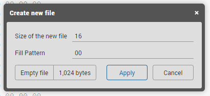

Write the obtained key into a file. Here, I call it key.key. You can use hexed.it to create a 16-byte file and fill it with the obtained key in hexadecimal literal form.
Let's assume that I've got a key: 6762b37e175348bda9582b42ca25f99a. I will create a 16-byte file on hexed.it:
[Attachment 71273 - Click to enlarge]

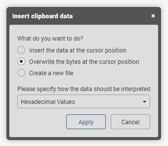

Then, I will paste this key into the file, select "Overwrite the bytes", and choose "Hexadecimal Values":
[Attachment 71274 - Click to enlarge]

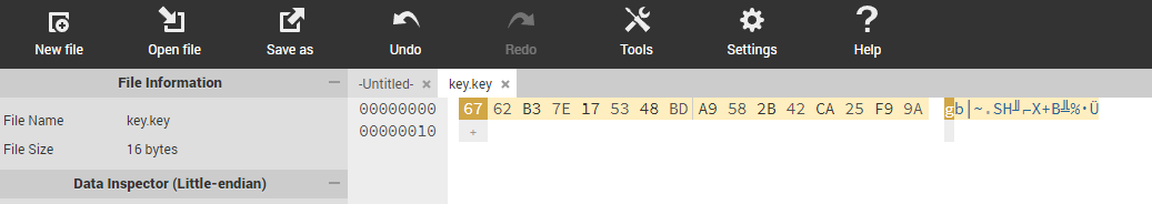

Finally, save the file as key.key:
[Attachment 71275 - Click to enlarge]
