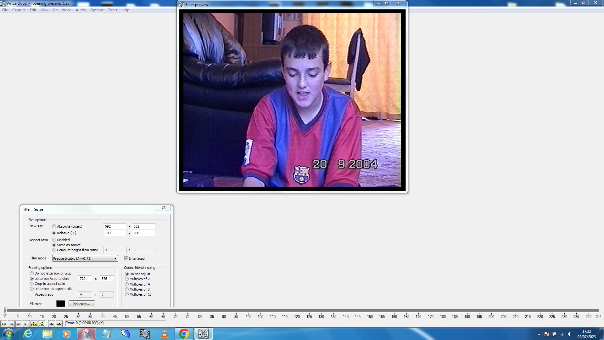

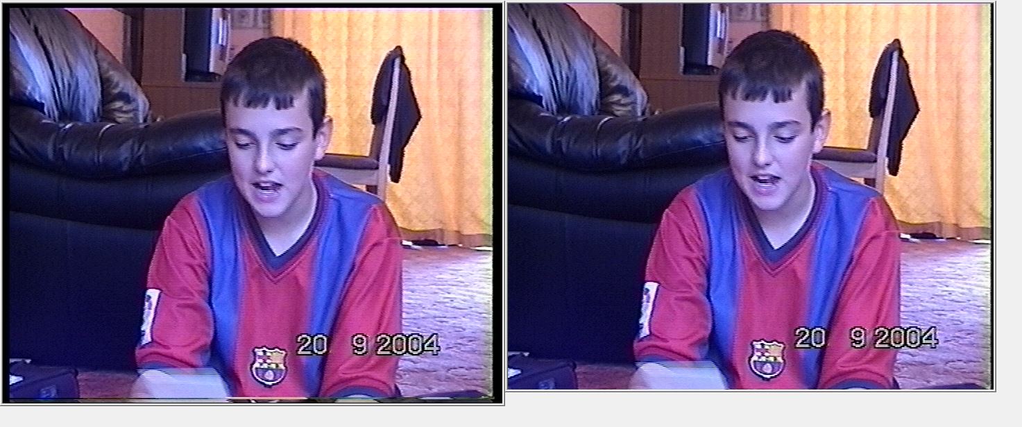

    I've been looking at Virtualdub 2 editing. I've really struggled to replicate the crop add borders from Avisynth. I've used the resize filter and I removed 20 from the side and top as a rough test but I didn't know how to put a border(mask) around it (if this filter even does this?) null transform seems to be a crop filter. I read of a border control filter but I haven't tried it. Any pointers as to what I'm doing wrong would be welcome. Thanks.

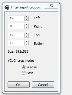

  12. Apply the Crop filter first, then use the resize filter to Letterbox/Crop To Size.

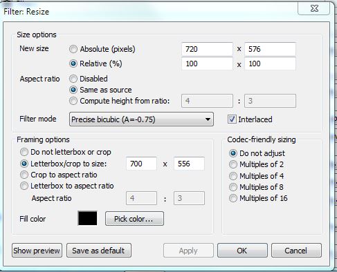

    Thanks jagabo for explaining that. Does that mean that as some of my analogue captures only need crop & add borders, gaps deleted and joined together that this amount of editing could be done in one sitting and then saved as a Direct Stream Copy? I've attached my crop and preview of resize. I left "code friendly sizing" as default as I wasn't that sure of any of my settings if I'm honest. Tomorrow I will try the File> Append video segment to join two videos together that Alwyn mentioned and the Mark in-Mark out you mentioned. Thanks.

    No. The only thing you can do in Direct Stream Copy mode is cut/paste editing; no filtering. Filtering (crop, resize, addborders are filters) requires the frames be decompressed, modified, then re-compressed.
