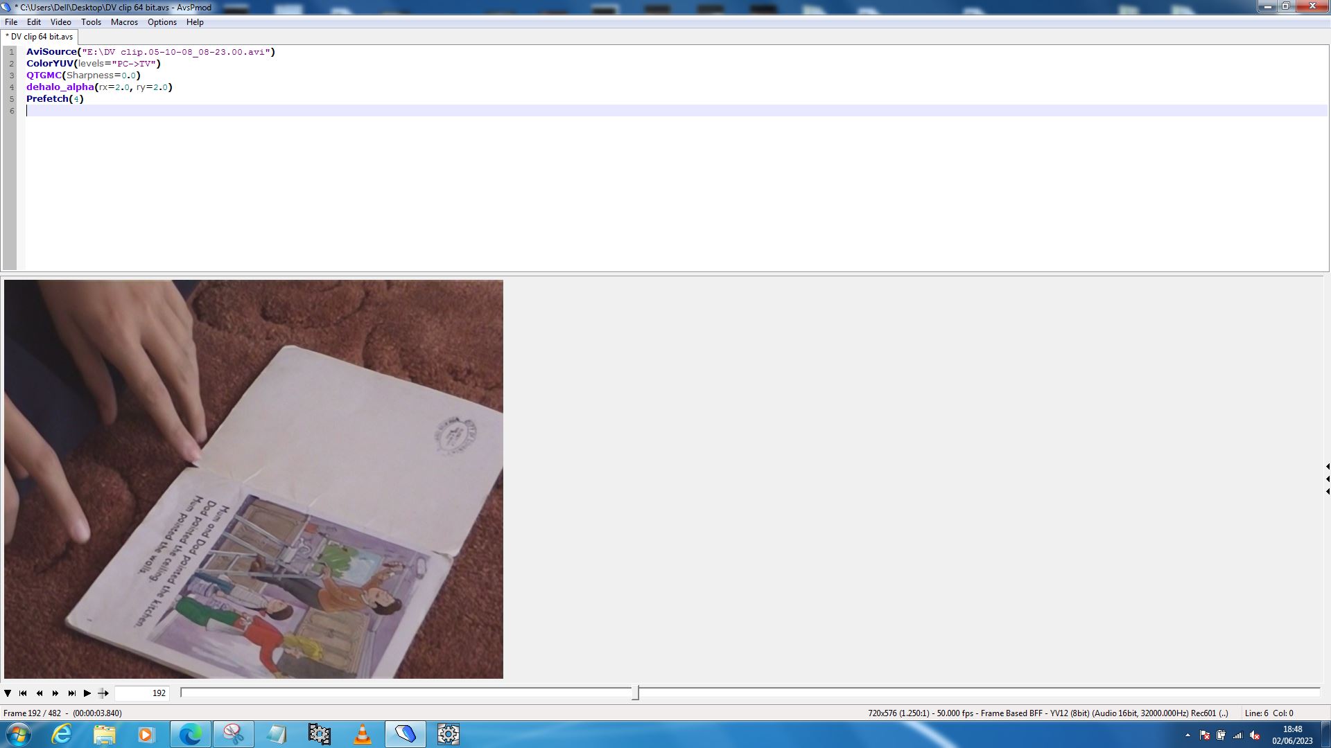

    Thanks Sharc & Cornucopia. In the script I've replace jagabo's color ColorYUV command with ColorYUV(levels="PC->TV") I'm guessing they both achieve the same final result? I can only see 3 vertical lines on my windows media player and VLC player, What do I need to do to get my player to comply with full range? Thanks.
Name:	pc tv Avisynth.JPG
Name:	Sharc chart.JPG
  7. The color range is now limited ok, but you got elevated darks again and the picture looks washed out.
    Add after ColorYUV(levels=....) something like
    SmoothLevels(input_low=24,gamma=1.0,input_high=235,output_low=0,output_high=235)
    which should fit the luma better into the 16....235 range - and look similar as jagabo's in post#10.

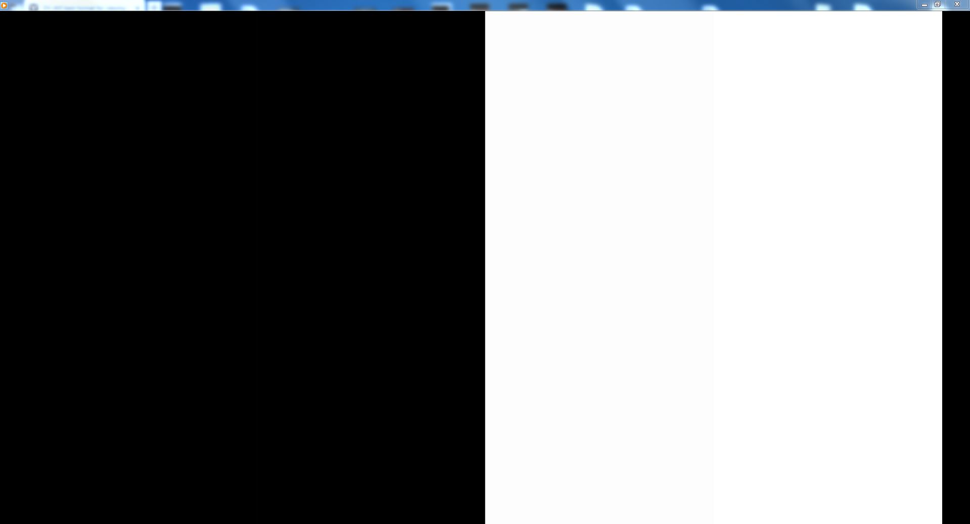

    Histogram("levels") and Histogram("classic") is your friend for checking.
    PC player (renderers) usually have a setting to select (force) TV or PC range playback. For video encoding however always stick to limited (Y 16 ....235). Doing anything else just calls for troubles.

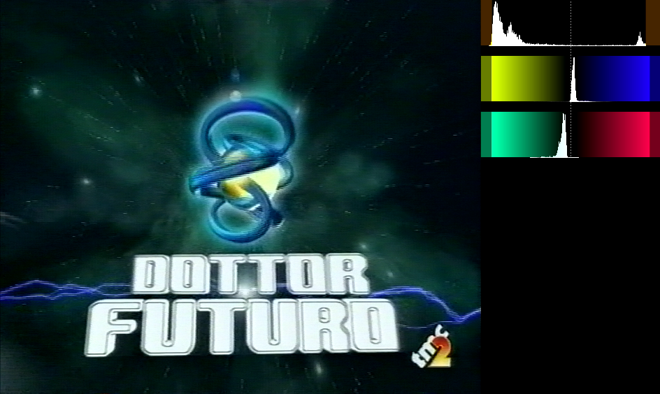

    In addition to what Sharc properly said, note that an AviSynth processing most of the time expand an input video with levels 16-235 to an output video full range 0-255 (i.e. when deinterlacing, denoising, sharpening).
    If needed in the contest explained before, add a conversion to limited range (also) at the end of the script.
  18. Also, VirtualDub operates in RGB only as I understand. This is one more reason to keep the luma in limited YUV range.
    As the PC player/renderer settings are sometimes not very clear and flags and ranges are sometimes conflicting and criss-crossed, one may play the attached file as a test. It is YUV limited format like captures, DVDs etc. should be.
    Now use a color picker and check the squares labelled 16 and 235. If the picker returns 0,0,0 for the '16' and 255,255,255 for the '235' your player is set up correctly for viewing standard YUV videofiles.

    I don't know of any AviSynth filter that clandestinely converts limited range YUV to full range YUV.

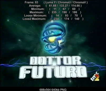

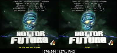

    Not clandestinely, nor with a specific command, but the effect is there. Here an example with a simple QTGMC:
    My old experiment reference here: https://www.digitalfaq.com/forum/video-restore/10776-levels-before-after.html
    In addition, some filter converts internally from TV level to PC level for better processing. An example from SMDegrain (although for motion vectors only). Same for TemporalDegrain2:
    # Converts luma (and chroma) to PC levels, and optionally allows tweaking for pumping up the darks. (for the clip to be fed to motion search only)
    # By courtesy of cretindesalpes. (http://forum.doom9.org/showthread.php?p=1548318#post1548318)
    I remeber also Shapeners having same approach, for example LimiteSharpenFaster:
    ex=blankclip(last,width=smx,height=smy,color=$FFFFFF).addborders(2,2,2,2).coloryuv(levels="TV->PC")
     \.blur(1.3).mt_inpand().blur(1.3).bicubicresize(dest_x,dest_y,1.0,.0)
    edit: QTGMC filtering used was QTGMC(preset="slow", matchpreset="slow", matchpreset2="slow", sourcematch=3, tr1=2, tr2=1, NoiseTR=2, sharpness=0.1) to avoid intensive processing

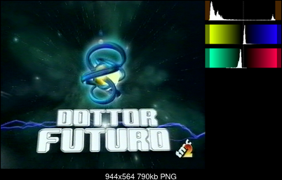

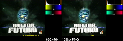

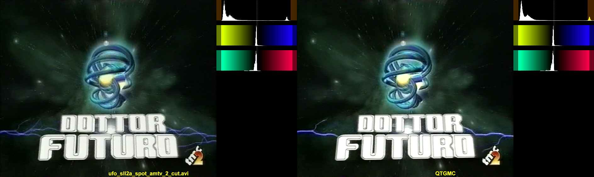

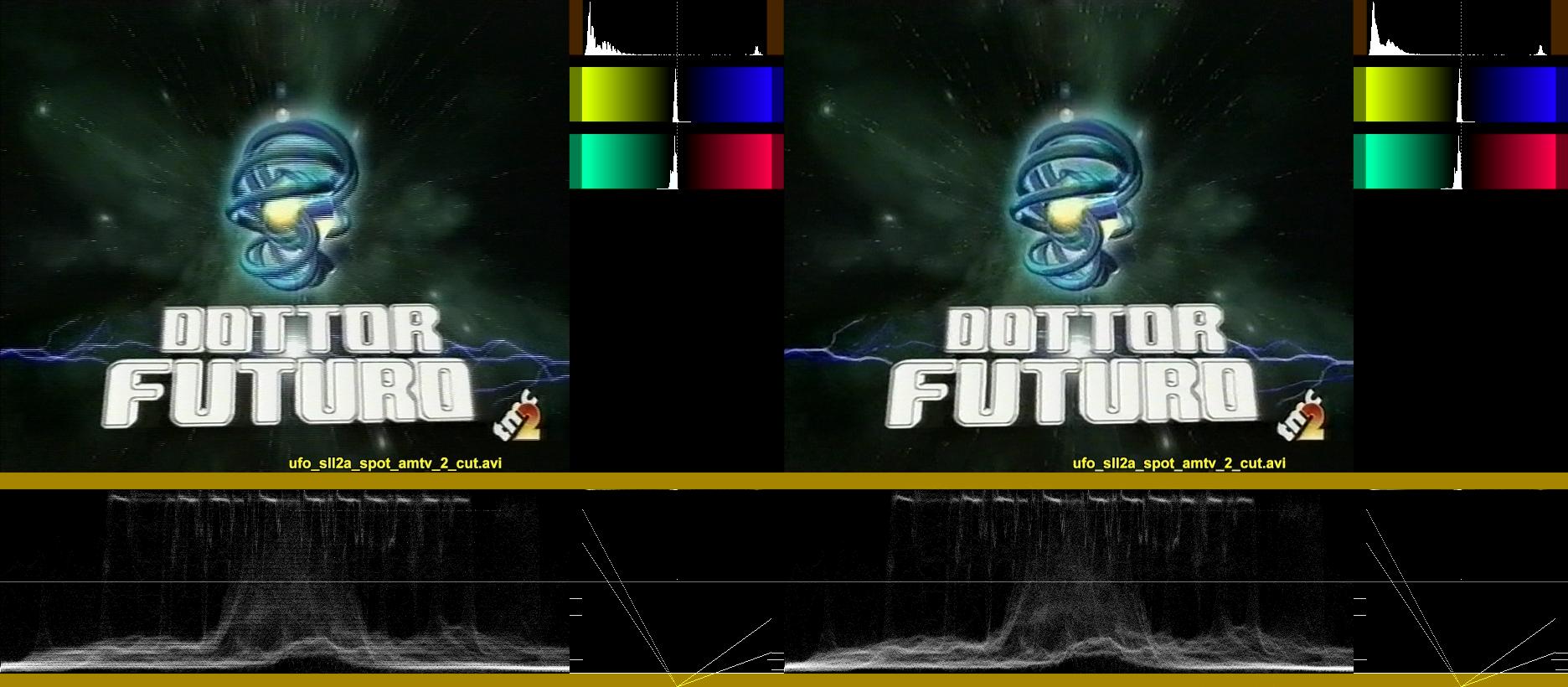

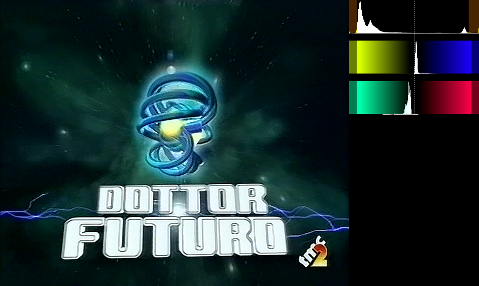

  22. I have never seen QTGMC change levels. For example, taking the left portion of your sample image and applying QTGMC():
    ImageSource("qtgmc.png", start=0, end=23, fps=23.976)
    Crop(0,0,680,-0)
    ConvertToYV12(interlaced=true)
    StackHorizontal(last.Histogram(mode="levels"), last.QTGMC().Histogram(mode="levels"))
    HistogramOnBottom()
    [Attachment 71476 - Click to enlarge]
    Replacing QTGMC in that script with TemporalDegrain2, SMDegrain, or LimitedSharpenFaster resulted in the same -- no change in levels.

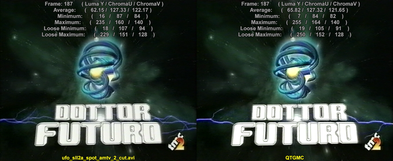

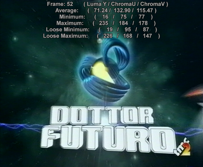

  23. Interesting and surprising. Using a color picker:
    - The white letters of the original are around RGB 240,242,235 (+/- noise). The QTGMCed variant is RGB (255,255,255).
    - The bright spot in the center of the picture has 2 probably clipped RGB components (255,255,205+/-noise) in the QTGMCed variant, while the original .avi is unclipped around RGB(242,248,190), +/-noise.

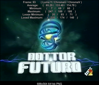

    Let me explain the flow, my previous images may mix different steps:
    0- source is YUV 16-254
    1- apply levels(16,1.0,254,16,235,coring=false,dither=true) to source -> levels are now 16-235
    2- QTGMC() or other processing
    3- levels are now 0-255
    org + levels correction
    processed
    processed
    here the video, if you want to try by yourself. My point is/was that even if I fix the levels to 16-235 prior to filtering, after the processing they are 0-255 anyhow. They may be relative to small "details" as you mentioned in your first reply, but they are there:
    ufo_sII2a_spot_amtv_2_cut.avi

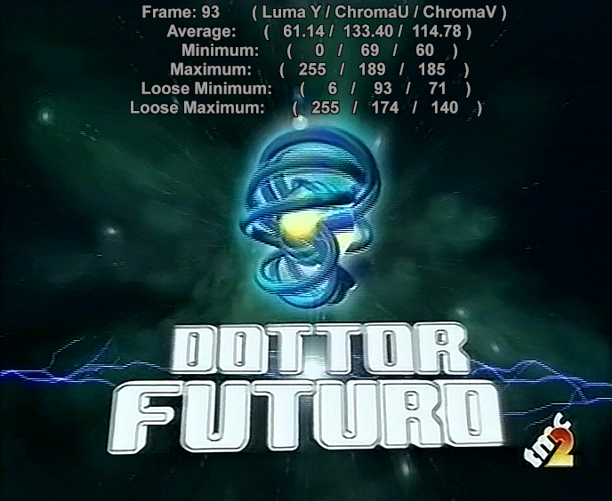

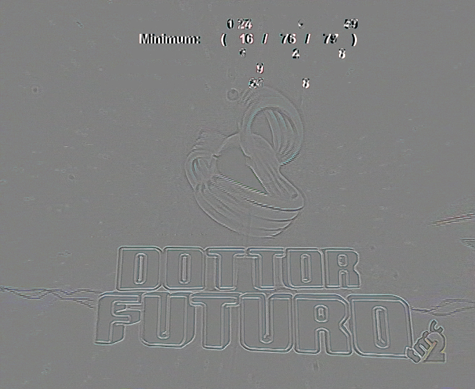

    The previous image may mix different steps, sorry; not worth an analysis
    edit: you see Y=11 level instead of Y=16 in the picture because there are other "corrections" in the script, but the concept is the same. Here a better comparison and the (modified) script
    [Attachment 71482 - Click to enlarge]
    processed
    [Attachment 71483 - Click to enlarge]

  25. Looking at your new series of 6 pictures, I can't see a level shift of the brights. Your histograms and reported minima/maxima may just include sharpening halos introduced by the processing filters, no?
    Taking the avearge of 5x5 pixels in order to smooth differences introduced by noise, for the white letters for example:
    1 RGB(235,250,251)
    2 RGB(235,250,247)
    3 RGB(234,252,246)
    4 RGB(235,250,248)
    5 RGB(226,240,244)
    6 RGB(226,240,244)
    The minor differences are caused by the residual noise. I don't see an indication of systematic level shift by QTGMC etc. 5 and 6 are even identical.
    So I don't get it, or am I missing something....?
    Edit:
    I did some tests with QTGMC() using test clips. No change in levels, but I see the local deviations along sharp edges, caused by the sharpening of QTGMC(). Adding sharpening filters will make it worse of course. These halos will appear in the histogram() and push the min/max values.

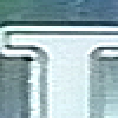

  26. You're showing over-sharpening halos, not a levels change. Flat white areas (like the middles of the white letters) are the same brightness in both images. Flat dark areas are the same brightness. Only the high contrast edges are different. If you subtract one image from the other you'll see all the major differences are at sharp edges.
    [Attachment 71488 - Click to enlarge]
    If you zoom in on the letters you can clearly see the halos in rest3.png (top of the first T in DOTTOR).
    [Attachment 71490 - Click to enlarge]
    Those were created by LimitedSharpenFaster. Just because there are a few brighter pixels doesn't mean you've changed the levels.
    Yes, that's what the processing aims to do.
    Back to my original point in post #47: after processing the levels are expanded, then if I do not want to loose the effect of the filter I may need to shrink back the levels before the RGB conversion, otherwise the sharpening effect I want to introduce will be reduced, because clipping of 235-255 range.
    They are not so few, because the "Loose Maximum" in the analysis of the processed video is 255. And once more, I do not want to loose what I have introduced, even if they are not many.
    In addition, applying only TemporalDegrain2 without LSFmod the effect is there, although much much reduced (Maximum=247, Loose Maximum=235)
    I agree. But the quality of all best filters, such as QTGMC and TemporalDegrain2, relies on some amount of sharpening at the end of their processing. For what I said before, there is a risk of loosing the "improvement" if the expanded levels are not fixed before the RGB conversion.
    Thanks to both for your constructive opinions, I revised some of the checks on my flow while providing the samples thanks to your comments
  28. Originally Posted by SkyBlues2021 View Post
    Your second picture in post#36 indicates that your video player (or browser) ignores the full flag but plays standard YUV video in the range Y=16......235 correctly, as the luma of the 4 bars are mapped to RGB, like (order 1....4 is left to right):
    1 Y=0 -> RGB=(0,0,0)
    2 Y=16 -> RGB=(0,0,0)
    3 Y=235 -> RGB=(253,253,253) small rounding error, should be (255,255,255). Therefore you see a tiny brightness difference between bar 3 and bar 4 which you can ignore
    4 Y=255 -> RGB=(255,255,255)
    So you don't have to change anything with your player I would say.
    Edit:
    Here the same as in post#35 but flagged 'limited' (as standard YUV video shoud be):

  30. Originally Posted by lollo View Post
    Your processing did not change the levels, it produced super-white artifacts. You might want to make those artifacts visible by lowering the white level but then other parts of the picture that were perfect white (Y=235) before processing will now be a light grey instead (Y=~215), making the picture a bit dull. And the rest of the picture proportionally darker. And if you do the same at the dark end your perfect blacks (Y=16) will become dark greys (Y=~32), making the picture look washed out.
    The issue here is your definition of "levels". You are using the term just to describe the range of Y values. I'm using the term to mean the theoretical full black and full white values.
