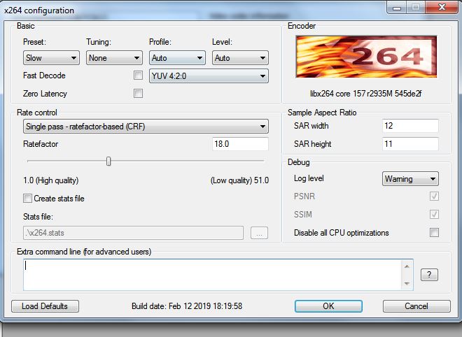

    I'm looking to put my DV AVI format videos onto a TV friendly format, at present without any edits. I have attempted virtualdub2 using 264x placing "bff" in the extra command line and saving as an mp4. I've read about MeGUI but I'm unsure if it's required? Any advice would be grateful. Thanks.

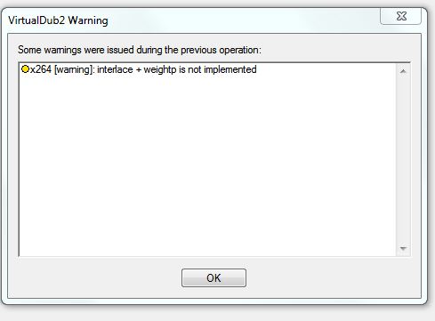

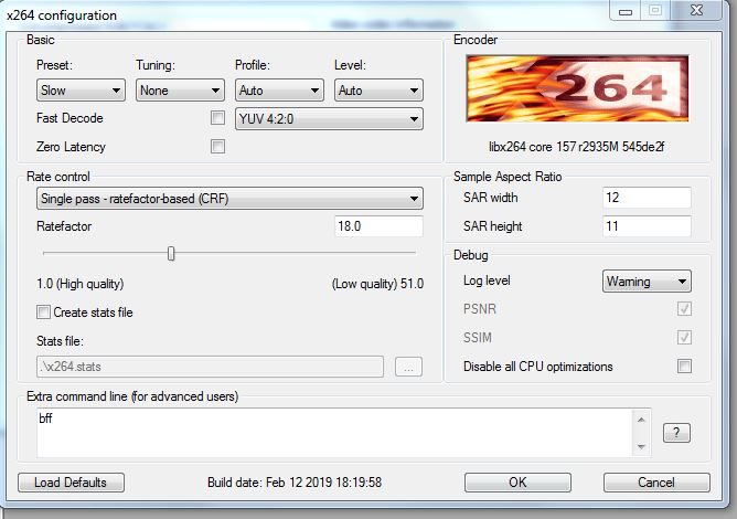

  2. Your mp4 file is encoded progressive, not interlaced. You need to specify "--bff" in the extra commands, not "bff".

    Thanks jagabo. For the audio I used FFMPegAAC I've attached the new clip. I specified "--bff" in the extra commands I got this message after the encode which made me think should I have done --bff--weightp=0 as well? Thanks.

  4. That looks good. Don't worry about the x264 warning. It's just telling you that it will not be using weightp with your interlaced video. And yes, if you want to get rid of that warning also add --weightp=0 to the list of options.

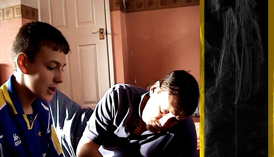

    Oh, one thing I noticed with your DV file is that brights are clamped at 235. DV usually contains brights all the way up to 255. You can usually adjust that to get the levels into spec and recover some of the brightest brights. Maybe the problem is in the way you provided the clip. Is that straight from the camera? Or did you process it in an editor?

    Thanks jagabo. If it looks good I will ignore the warning messages. I will try the clip on a few players today. I used WinDV to transfer the Digital8 videos from the camera. I haven't used an editor. I've posted another clip that I have encoded.
  6. That clip has brights all the way up to 255. The black level could be brought down too. Compare original on left, adjusted on right (both deinterlaced with QTGMC):

    Thank jagabo. I can see that the one you adjusted one on the right has more natural look. Is this a common problem with dv transfer or should I have done something differently when I transferred with WinDV?
  8. The bad levels are not unusual with DV camcorders.

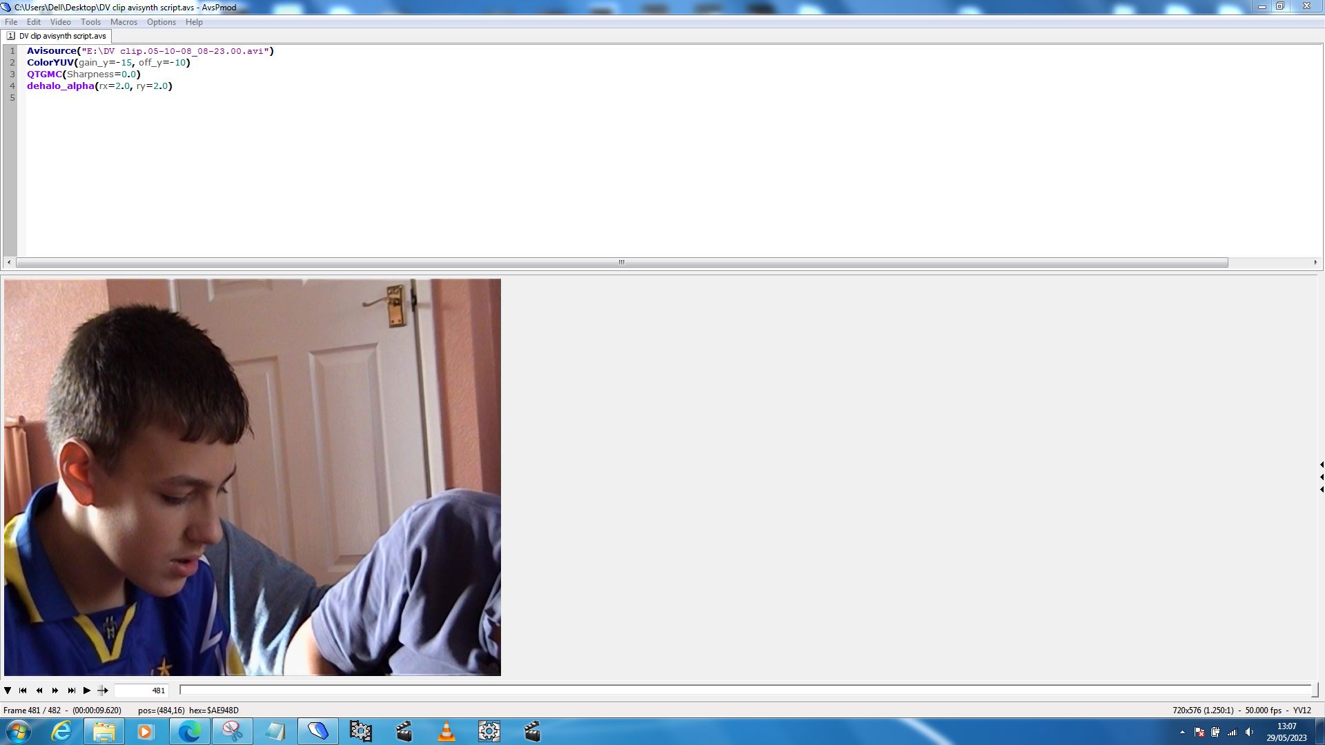

    Thanks jagabo. I've attached the new video with your code, hopefully I've done it properly. I think it looks great.
    At present I have everything installed in 32 bit, I'm guessing the 64 bit is much faster? Should I run the script throughout the whole 1 hour video? It was my Son's ABA workshop and stay's within the living room setting. I removed --bff from the extra command line in virtualdub2 before encoding as it's been deinterlaced and it's now progressive? Hopefully that was the correct thing to do. Thanks

  16. That clip looks good. The settings you've used are fine. It will probably be fine for the entire video. Sometimes I'll use a lower CRF for things that are really important to me.
    64 bit AviSynth+ will run a little faster than 32 bit. But the biggest issue is running out of memory with 32 bit programs because they can only use 2 to 3 GB, regardless of how much you have installed. That can be a problem when using multiple temporal filters. Also with high definition video. With only QTGMC you will be OK. But if you added another temporal filter or two, say SMDegrain and SRestore, you might have problems. Especially if you use a lot of threads.
    For faster processing enable multithreading. Add prefech(N) to the end of your script; where N is the number of cores you have (sometimes more, sometimes less).

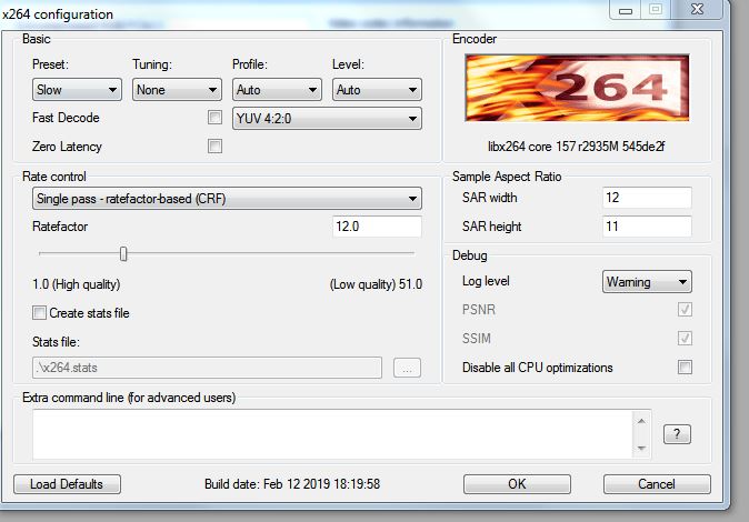

    Thanks jagabo. Glad I didn't mess up! What CRF would you suggest? I think it probably best that I install 64 bit Avisynth and Virtualdub2 for when I start to encode. Can you use Prefech on all scripts DV and analogue captures? I think I have 2 cores, I've looked it up apparently you divide by two?

  19. For general stuff I'm going to watch I'll use CRF 18. For really critical stuff I'll go as low as CRF 12. Of course, the lower the CRF the bigger the files will be. I find the Slow preset to be a good compromise of encoding speed, quality, and playback compatibility.

  23. That looks fine. If you have some dark shots try comparing crf 12 to crf 18. You may see less posterization in the dark areas.
    Also try comparing different prefetch values to see which encodes fastest. That can be hard to predict as you have a mix of filtering and encoding and hyperthreading.

  27. Originally Posted by SkyBlues2021 View Post
    I've just got 64 bit Avisynth+ and virtualdub2 up and running. I was hoping it was the same quality as my 32 bit version and I haven't messed anything up. Any advice would be appreciated. Thanks.
    Full range (top picture) is ok as long as you stay in YUV color space. I would however adjust the luma to be within the range 16 ....235 (bottom picture), or you may loose dark and bright details when the player (TV) converts YUY to RGB for the display.
    Try
    colorYUV(levels="PC->TV")
    or
    SmoothLevels(input_low=0,gamma=1.0,input_high=255,output_low=16,output_high=235)
    or adjust the proc-amp settings for capturing.
    Also, the brights are clipped. But this is probably due to an overexposure of the camera. One can't recover the details in the clipped brights.
