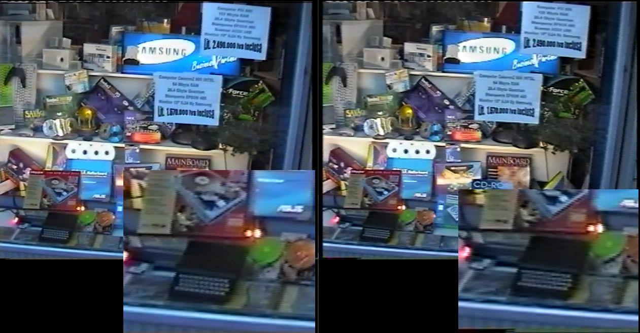

    Aug 2018
    Wrocław
    Originally Posted by Bartoloni View Post
    BUT after buying the PhilipsVR1000 i can't reach the same quality...
    it's possible to see tha the "interlace" seems "more" (no idea on how is possible) on captured footage from the Philips.
    I have the same impression when comparing Toshiba (a Samsung clone) with JVC or Panasonic.
    It seems that "Innovative V3 Technology" ((this is what I have on my Toshiba) gives something there.
    (up - Toshiba, down - JVC, both postprocessed)
