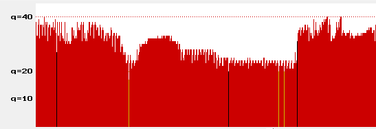

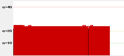

    FWIW attached a graph showing the variable quantizer for the CRF encode with AQ from frame 2850 onwards.
    For CQP it would be q=33 fix.

  3. Here the same for the CQP33 encode. It varies little between 33 and 35.

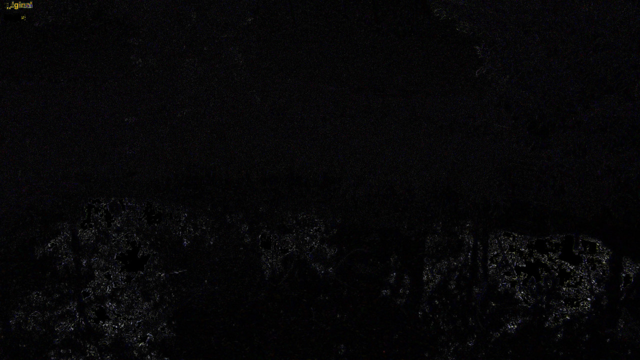

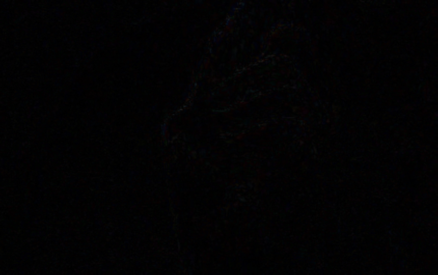

    With the help of Gimp, I made a blending of the layers to show the difference in the images. Obviously, the deviation in CRF is stronger.
    Difference between Original and CRF.
    Difference between Original and CQP.

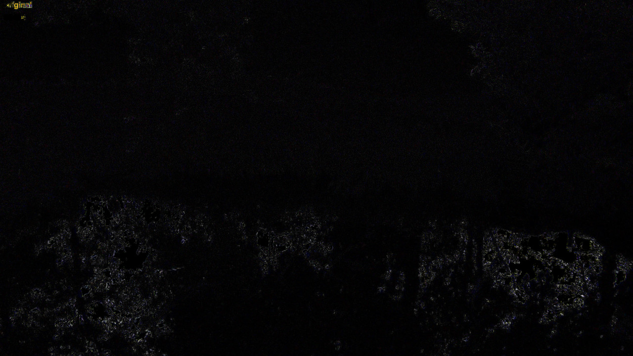

  13. Originally Posted by poisondeathray View Post
    These are animated png's that should animate in most browsers, if they don't try opening in a new tab. Frametypes are the same for each P,P, then I for the keyframe
    Merge with difference for your examples
    Difference between original and CRF
    Difference between original and CQP

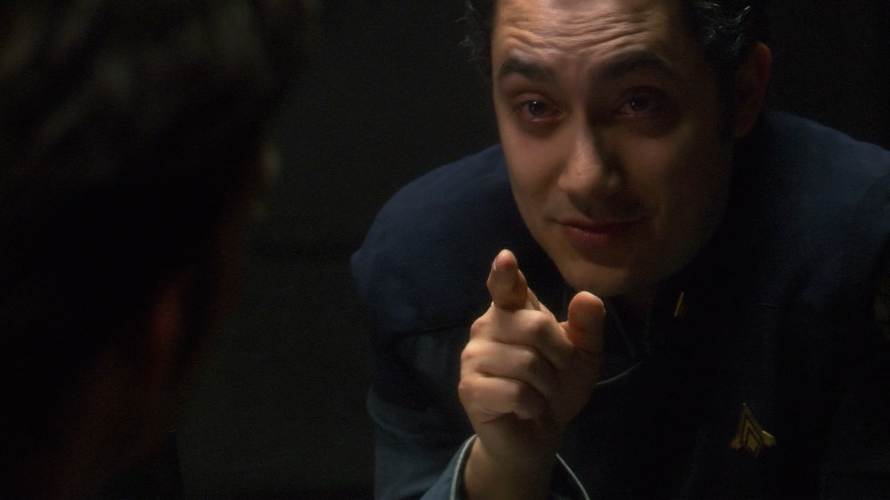

  15. I don't understand why you are comparing Q=23 in CRF and Q=26 in CQP. It is natural that 23 will be better than 26.
    I read the comments and realized that I-frames affect the quality. I set GOP 1/10 and the quality really improved for both CQP and CRF. But the problem still remains. The skin on the forehead does move in CRF:
    this CQP

  18. What does that mean GOP 1/10 ? --keyint 10 ?
    keyint_min=1 / keyint=10
    Warping areas like that forehead example are usually from bad motion vectors. But you would expect the same problem in --qp rate control
    With all the examples, I have shown that the problem with shifting parts of the image is much less in CQP.
    Don't you recognize the CQP deficiencies, or are you just trolling?

  19. The edge defect is probably related to AQ redistributing bits, what I referred to earlier as the main drawback of AQ . if you reduce the strength or disable AQ, and it disappears, you have your answer - then wouldn't be a "crf" issue, but an "AQ" issue. Check the other parts of the image, and the temporal consistency because they might be worse with --qp and no AQ.
    I mean not only the edges, but the semi-shadows inside the object (hand), on the fingers, on the metacarpus, on the joints. I already spoke about the influence of AQ, it will be necessary to do more precisely with screenshots.
  20. Originally Posted by gelo333 View Post
    Turn down psy-rd. This is part of x264's psy optimizations. The idea is that you are less likely to notice (at normal playback speeds) slightly inaccurate moving edges than you are other types of errors like posterization (note the dark area on the head of the guy on the left).

    A possible reason why this clip is not clearly inferior using CQP may be because this source - or this particular and pretty "homogenuous" dark scene - has been encoded with --qp 24 already. Hence there is perhaps little to gain by re-encoding this scene with CRF. A speculative thought only, no science.
    jagabo raised a good point regarding the "deformations" caused by psy-rd activities aiming at best perceived real-time visual experience.

  26. Now you have a video full of blocky posterization artifacts.
  27. Despite the tiny "movements" I prefer the CRF encode (CRF 23.1, preset slow, rest default settings) over the more blotchy dark areas of the CQP (qp 23) encode. Even more so because the rest of the movie will be more natural daylight scenes, I assume.
    Surprisingly and by chance the CQP and CRF values are almost the same for the same filesize, for this case.
  28. Originally Posted by jagabo View Post
    Did I do wrong? The only thing that I was told about my problem was to disabled AQ and psy.
