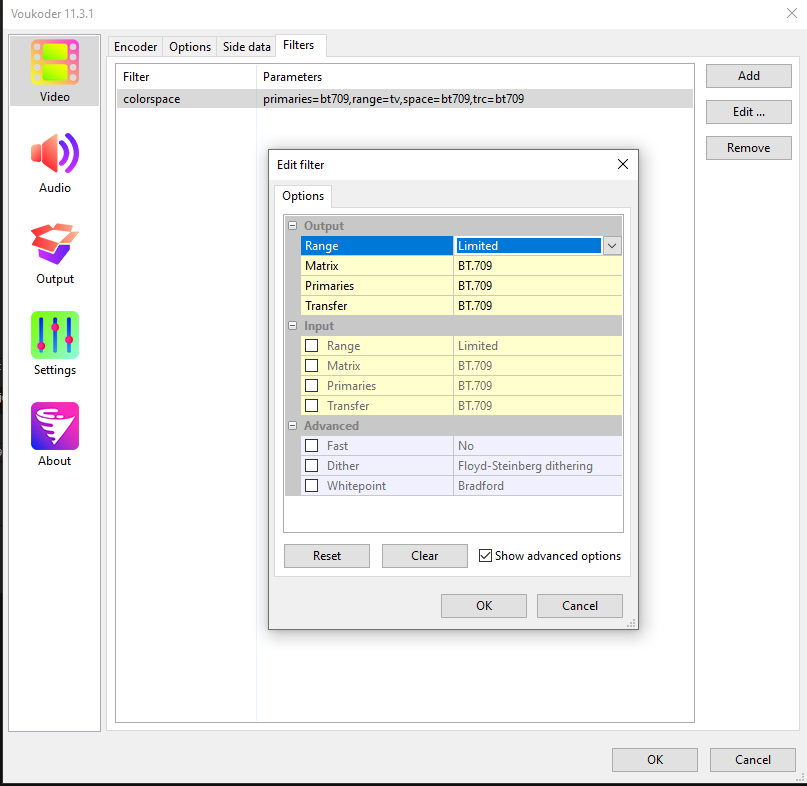

  3. install Voukoder plugin for your Vegas and export directly a youtube video, voukoder has Bt601 to Bt709 conversion besides many other things,
    [Attachment 71233 - Click to enlarge]
    you might also google for some color correction preset values for 601 to 709 if not wanting voukoder, google for it, there should be something even on this site
