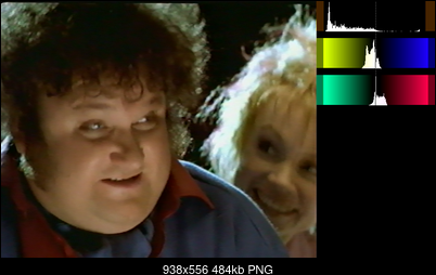

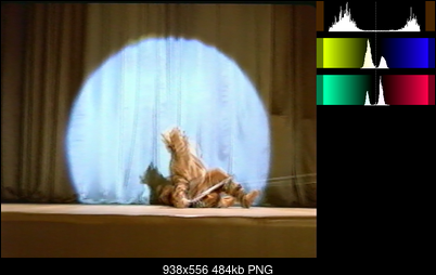

  5. Originally Posted by lollo View Post
    Your capture is fine from the field architecture point of view.
    the histogram suffers of crushed blacks and clipped whites, probably because the card. Try to use its procamp if possible for a better distibution of the levels:
    [Attachment 71271 - Click to enlarge]
    [Attachment 71272 - Click to enlarge]

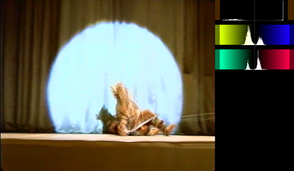

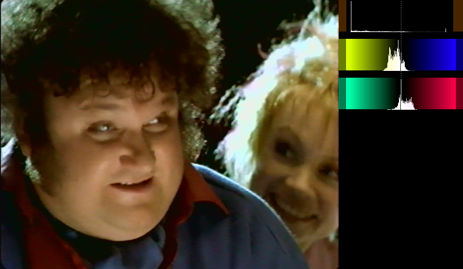

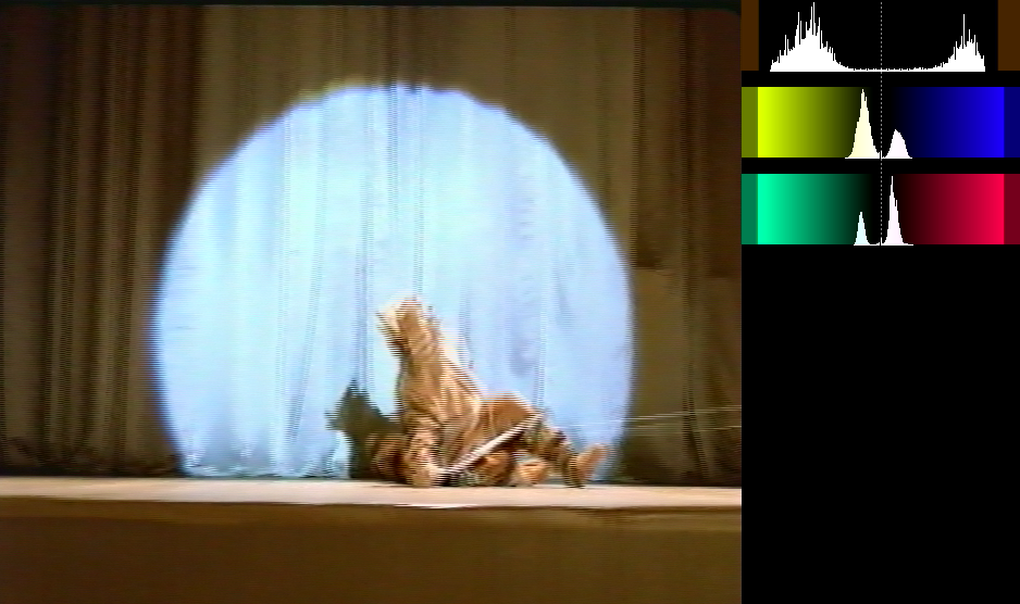

    I know this is a slight necroquote, but I had some spare time today and so I made a new capture of that same tape. To me, the levels look much better now.
    They do. But look to a sequence, not a single shot image (maybe you did it, and just post 1 image for comparison, I assume)
  8. Originally Posted by lollo View Post
    They do. But look to a sequence, not a single shot image (maybe you didi it, and just post 1 image for comparison, I assume)
    Yeah, I've gone through some of the whole footage, LGTM. I removed one of the hardware pieces (Kramer FC-400, to be precise) from my capture chain and used just my HR-S7600 + ES10. I came to the conclusion that chaining it with the ES10 blows out levels.
