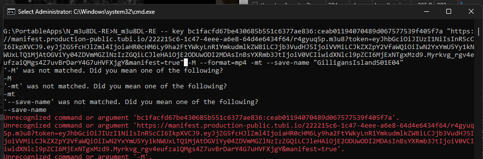

    Was coming back to post an update. I managed to get a "SUCCESS" from cdrm-project. Now, I just have to figure out what data to pull from it to pair with the CLI command tool.
    ADDENDUM: Drats! I thought I had it. Copied your code from earlier and made what I thought were the necessary edits, but N_m3u8DL-RE is being rude.
    [Attachment 71218 - Click to enlarge]
    I see it now! I had an unnecessary space in the command. Ok, now that I spotted that, let's grab episode 4 and then see if I can grab a couple of episodes on my own.
    NEW ADDENDUM: Apparently I only grabbed the audio. Grrrrr!
    NEXT ADDENDUM: And now, only a smaller resolution video.
    FINAL ADDENDUM: Hooray!

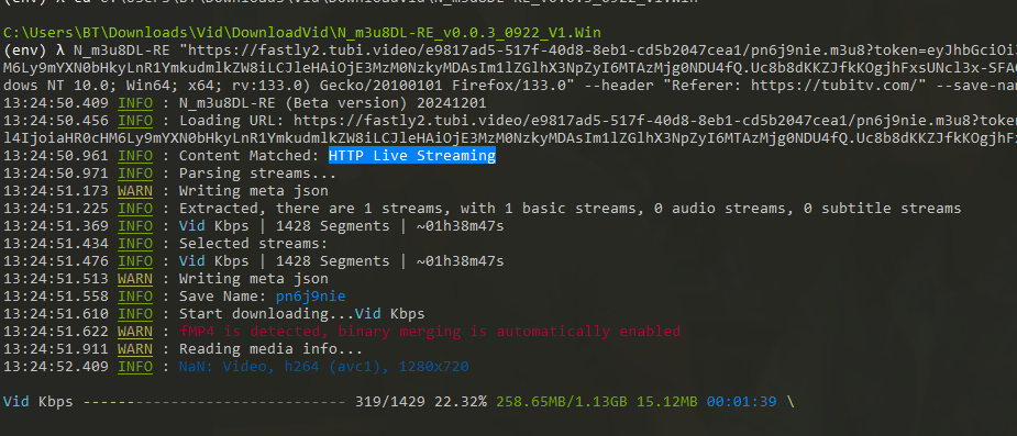

  18. I put the PSSH in and hit enter and it gave me an error message. What should I have been doing?
  19. Originally Posted by lvstrtrk View Post
    inputting only the pssh would only work if the keys were already cached.
  20. Don' know...everything seems to be ok.
    [Attachment 83853 - Click to enlarge]
    Which url?
