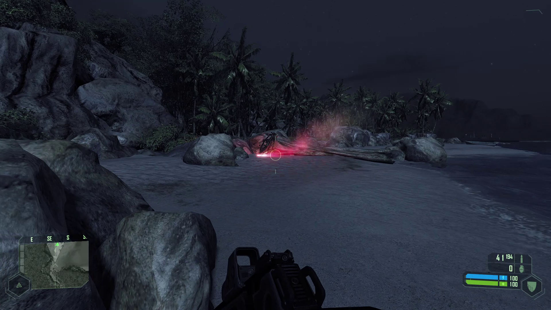

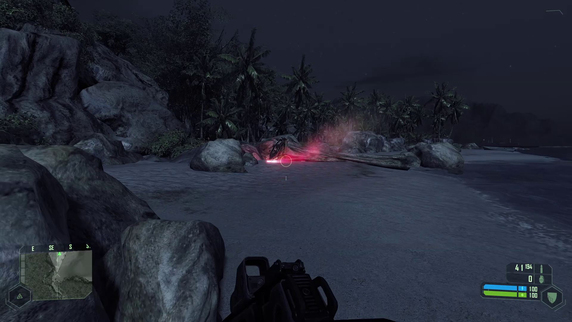

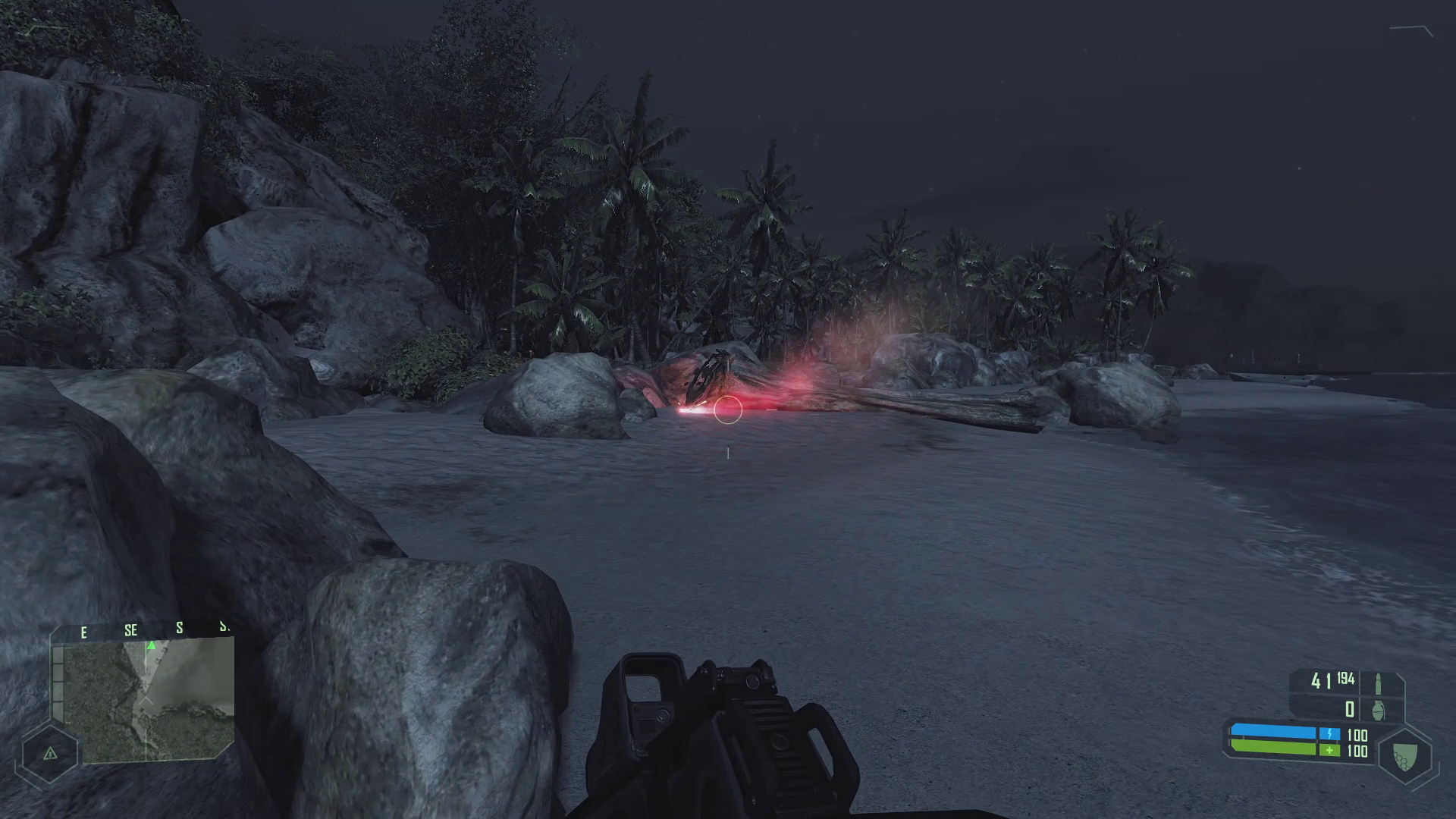

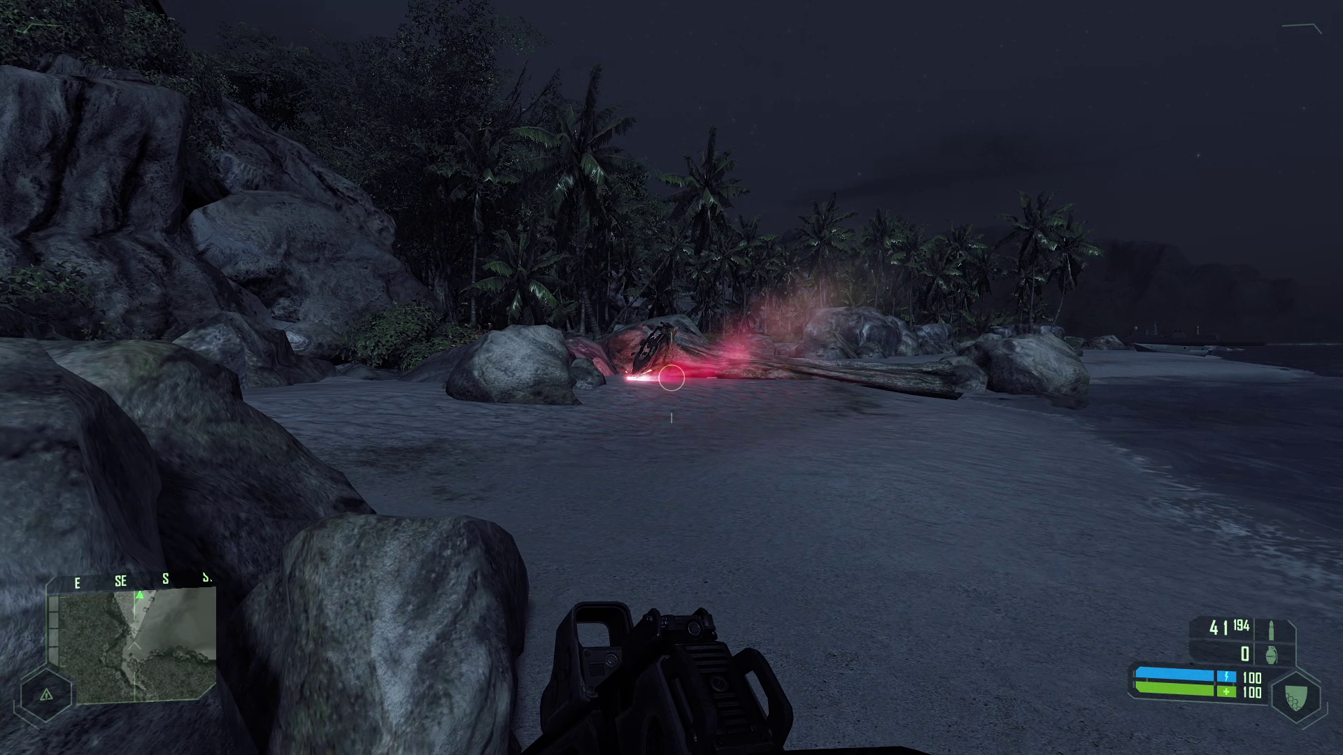

  1. I have a recording from a game that i'm trying to edit.
    When i render the result using x264, it produces a video that has a noticable yellow tone added to it compared to the original recording.
    In comparison, Mainconcept or AMD VCE both retain the colors but produce a lower quality (more pixelation) for a given bitrate.
    original recording
    [Attachment 71157 - Click to enlarge]
    rendered with AMD VCE
    [Attachment 71158 - Click to enlarge]
    rendered with Mainconcept
    [Attachment 71159 - Click to enlarge]
    rendered with x264
    [Attachment 71160 - Click to enlarge]
    Is there a workaround to make it look like the original?
    I would really like to use x264 over Mainconcept because it has higher quality and more settings, but this is discouraging me.

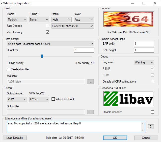

  5. Try this on the x264 file:
    ffmpeg -i input.avi -map 0 -c copy -bsf:v h264_metadata=video_full_range_flag=0 output.avi
  6. Erm, i don't have the command line tool. I use the x264vfw launched from a video editor.
    Is this going to do what you expect?
    [Attachment 71161 - Click to enlarge]
  7. Try it, but i think it will not work.
    Download ffmpeg from the software section here and executemy commandline above.
  8. Done. EDITED (wrong file): The colors in the result are still wrong.
