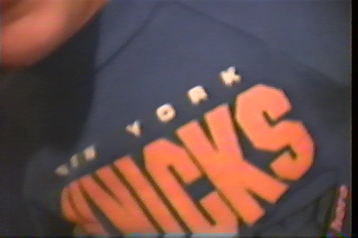

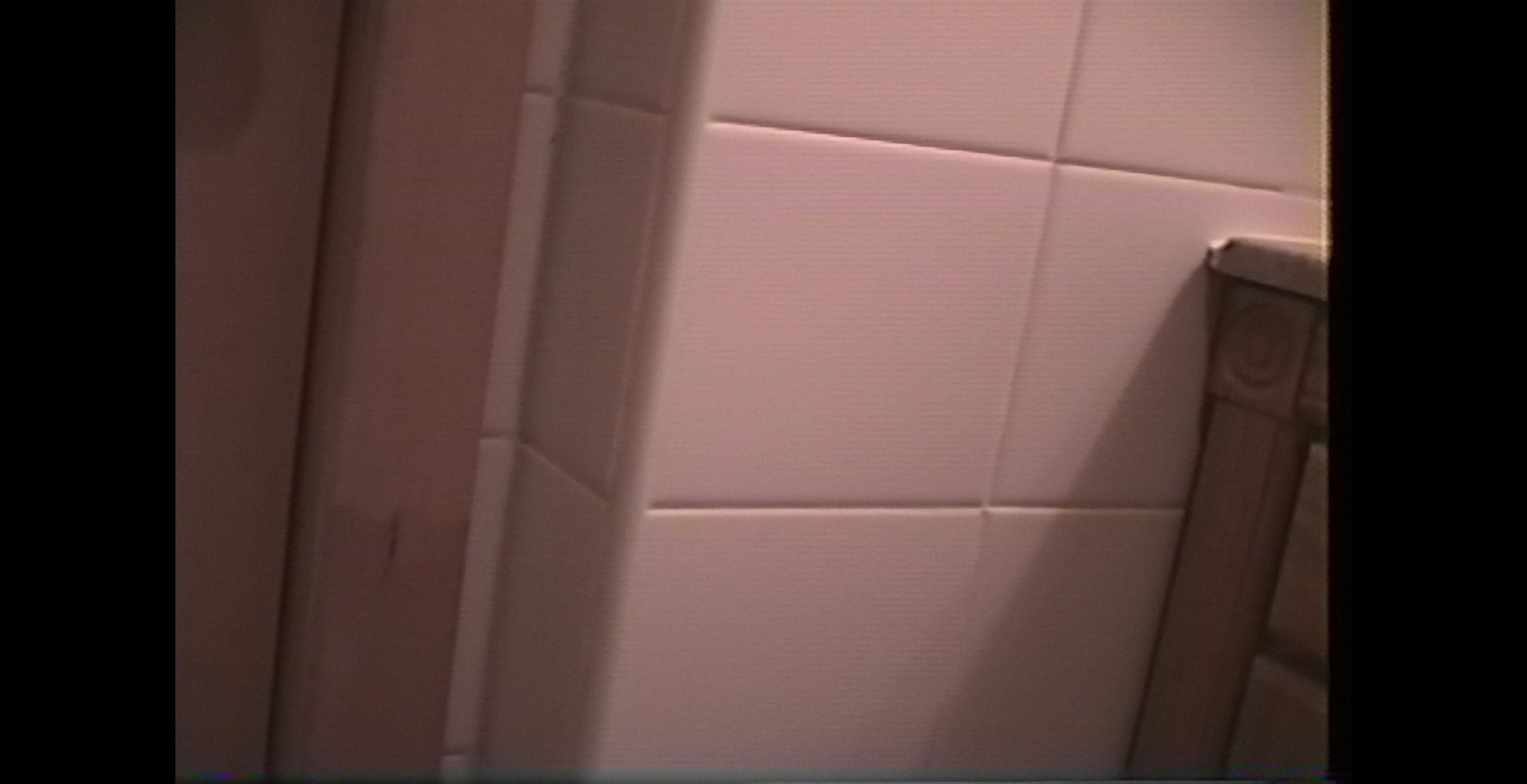

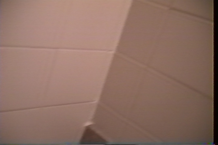

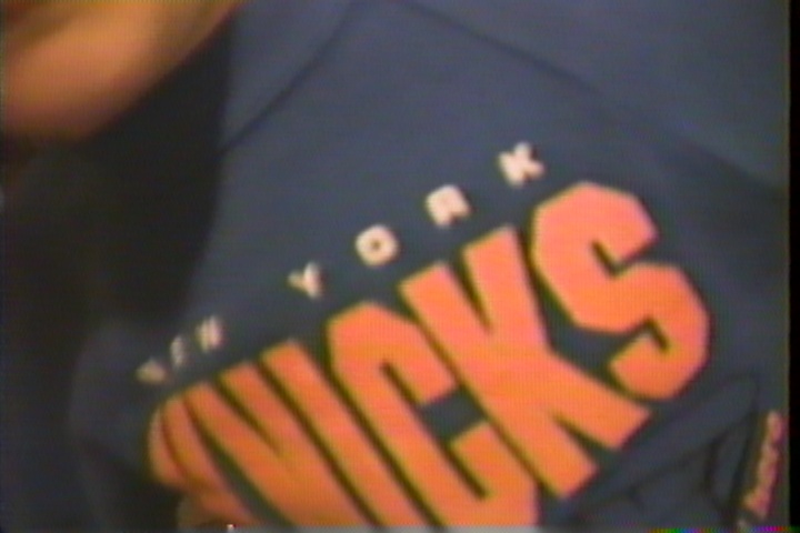

    (1) Banding issue: With the Auto picture setting on my JVC HR-DVS3U I am seeing a banding effect that I do not see on the Sharp or Soft setting. It is present on all tapes recorded with that camcorder, prominent on some scenes more than others. Attached are some samples with the Auto and Sharp settings of the JVC as well as a transfer direct from the original camcorder. The effect is also present with the same tapes on my other VCRs, so it is not a defect of the JVC in my estimation, but more of a difference in Panasonic's 1980s VHS standards.
    In summary, the effect persists on the Auto setting, but is not really noticeable on the Sharp setting nor when the tape is played back on the original camcorder (though various artifacts are visible this way - I can definitely see the advantage of the JVC VCR with TBC on).
    I can also confirm that this banding issue is not limited to this specific camcorder but is likely present on various models from different manufacturers. Other footage recorded with two different 1980s camcorders, one an early 1980s model with a separate VCR recording component and camera and another mid-1980s camcorder, produced the same banding result. Besides that, there is no problem transferring tapes not made with these 1980s camcorders (they look great and have no banding), so it is most certainly something to do with the possibly out of spec designs of some 1980s Panasonic stuff as discussed elsewhere on the forums. Everything is SP. The tapes are not copies but are tapes that were in the camcorder while the movies were recorded. I have tried with various settings on and off and they did not address the issue (TBC ON / stabilizer off, stabilizer on and TBC necessarily off, both off, the various audio monitor settings hifi, hifi L, hifi R, norm, mix, etc.).
    Is "Sharp" the best option or can something else be adjusted with the equipment I have?

  2. By "banding" you mean the horizontal lines?
    On the auto.mp4 you could try something like
    LWLIbavVideoSource("156 90 Auto.mp4",cache=false)
    QTGMC(InputType=3)
    vinverse()
    The Sharp has strong sharpening artifacts.
    The PV-420D has rainbows, color noise and flicker.
    How did you deinterlace the video?
  3. The issue is the darker horizontal lines that are visible most noticeably on solid areas such as the nearly-solid tile background. These are different from the sharp lines when I play an interlaced file with no deinterlacing.
    I ran the script and have attached the results as well as the original TFF interlaced file and a screenshot of the deinterlaced file. While this does not solve the issue I think that the QTGMC recommendation will be a good option to deinterlace the footage after capture.
