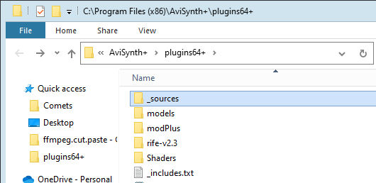

Put the models folder inside the plugins folder where you have rife.dll:
[Attachment 71235 - Click to enlarge]
Inside that folder there should be many other folders that contain the model data files.
After setting up the models folder... RIFE in AviSynth requires planar RGB32. So call it with:
Code:ConvertToPlanarRGB().ConvertBits(32).Rife(gpu_thread=1).ConvertBits(8).ConvertToYV12()

Which one should I download?
https://github.com/Asd-g/AviSynthPlus-RIFE/tree/main/models
Is it the same as Flowframes? -
I have all of them in my models folder. The default is rife_v2.3. By the way, this is the first time I've used it.
https://github.com/Asd-g/AviSynthPlus-RIFE/releases/tag/1.0.0 comes with all the models, so downloading v1.0.0 and taking the models from there might be more convenient than downloading them one by one.

I put the rife-v2.3 folder in the models folder (in plugin64+). No longer 'no models error' but: 'System Exception -- Access Violation'
ffms2("10000000_924752528810545_132584178015633738 9_n.mp4")
convertbits(bits=32)
ConvertToPlanarRGBA(matrix="rec709")
RIFE() -
Did you fulfill the requirements list ? Especially the Microsoft VisualC++ Redistributable Package 2022 ?
http://avisynth.nl/index.php/RIFE#Requirements -
