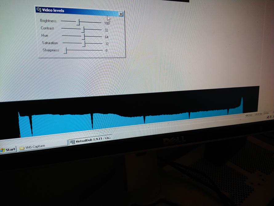

    Does this seem normal with the ATI 600 USB? All I did was adjust the sharpness down to 0 as recommended and here's what the histogram does.
    [Attachment 71143 - Click to enlarge]
  7. Originally Posted by theseeker2 View Post
    I don't know. Squeezing or expanding the levels can introduce periodic spikes and dips in the histogram. But changing the sharpness?

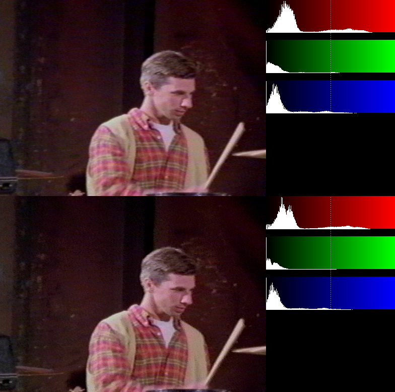

  13. FWIW here another demo showing how extreme level manipulations affect the shape of the histogram (top vs bottom picture).

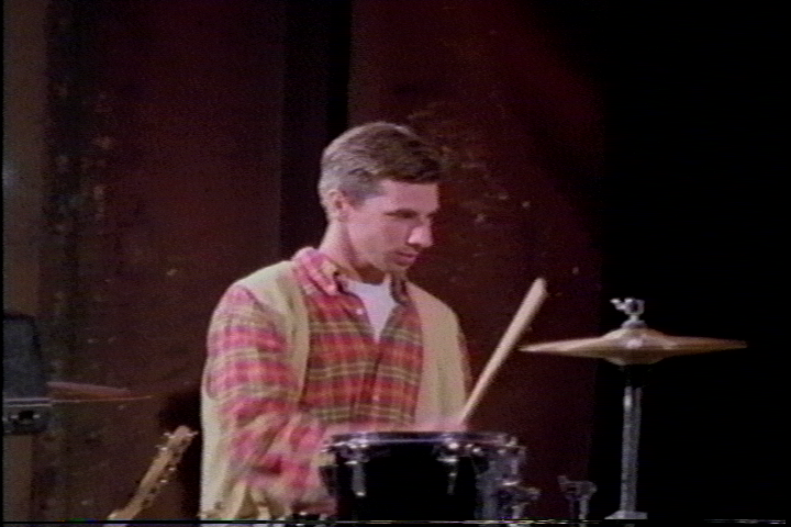

  18. I just found a recent thread comparing the picture quality of an AIW 9600 to a USB 600 and comes to a similar conclusion that you all helped me discover: that the USB 600 provides a sharper more detailed image and also that AIW 9600 slightly stretches the image: https://www.digitalfaq.com/forum/video-capture/12424-usb600-better-quality.html. This makes sense to me since the AIW 9600 also uses a Rage Theater chip just like my Radeon 7500.
    I'm still hoping to figure out the mystery of the sharpness setting on my USB 600 with the gaps in the histogram. I just compared two captures taken from a professional recorded VHS tape, one with sharpness at 0, and the other with sharpness at the default of 2, and I'd be curious to know what you all thought.
    Here's the image slider: https://imgsli.com/MTgwNDk0 (thanks lollo for teaching me about this!)
    USB 600 at sharpness 0:
    [Attachment 71192 - Click to enlarge]
    USB 600 at sharpness 2:
    [Attachment 71193 - Click to enlarge]

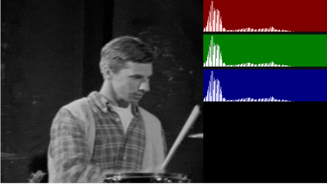

  19. Obviously the sharpness setting does not only affect the sharpening but also changes the levels (brightness, contrast) slightly. Therefore the differences in the histograms. This is just how this card and driver seem to work. Nothing wrong with the device I think.
    The final result will depend on your post processing anyway.
    (VirtualDub makes a YUV->RGB conversion, so you can't directly compare the histograms)

  20. Member Skiller's Avatar
    Oct 2013
    Germany
    Sharpness at 2 has coarse "dither-like" posterization all over. Wouldn't use 2, no matter what the histogram does when setting sharpness to 0.
    Sharpness at 0 looks good and natural, much better.

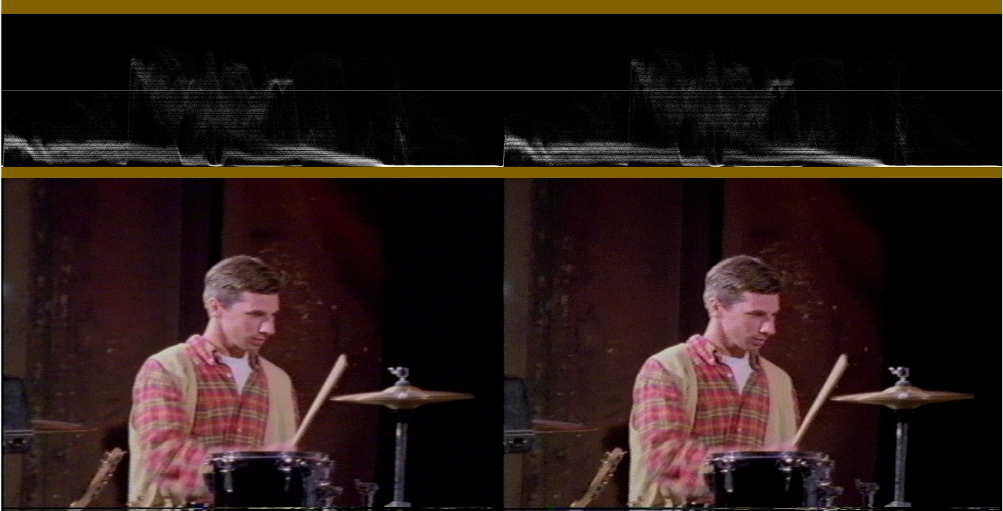

  22. Yes. And both show missing codes in the waveform, so there is not much difference in this respect. The sharpness=2 however crushes/clips the blacks slightly at Y=16 (maybe it's from the head switching crud only, not that this really matters).
