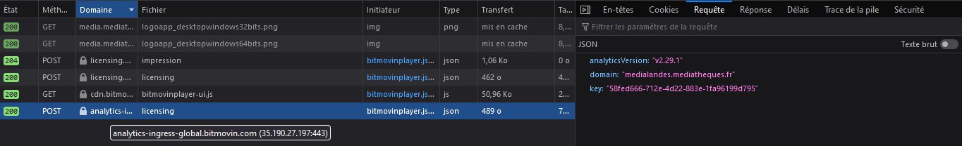

    [Attachment 70976 - Click to enlarge]
    [Attachment 70977 - Click to enlarge]

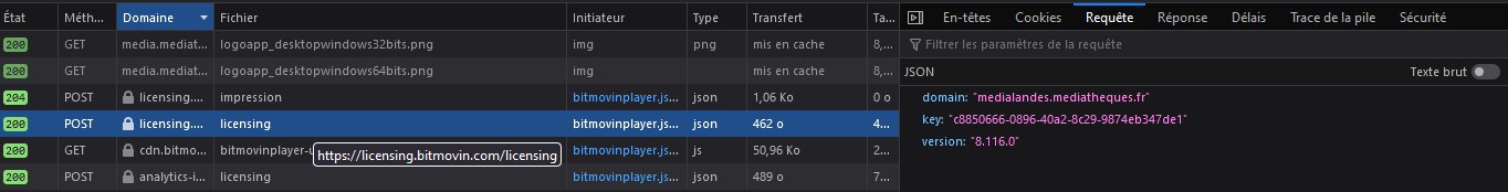

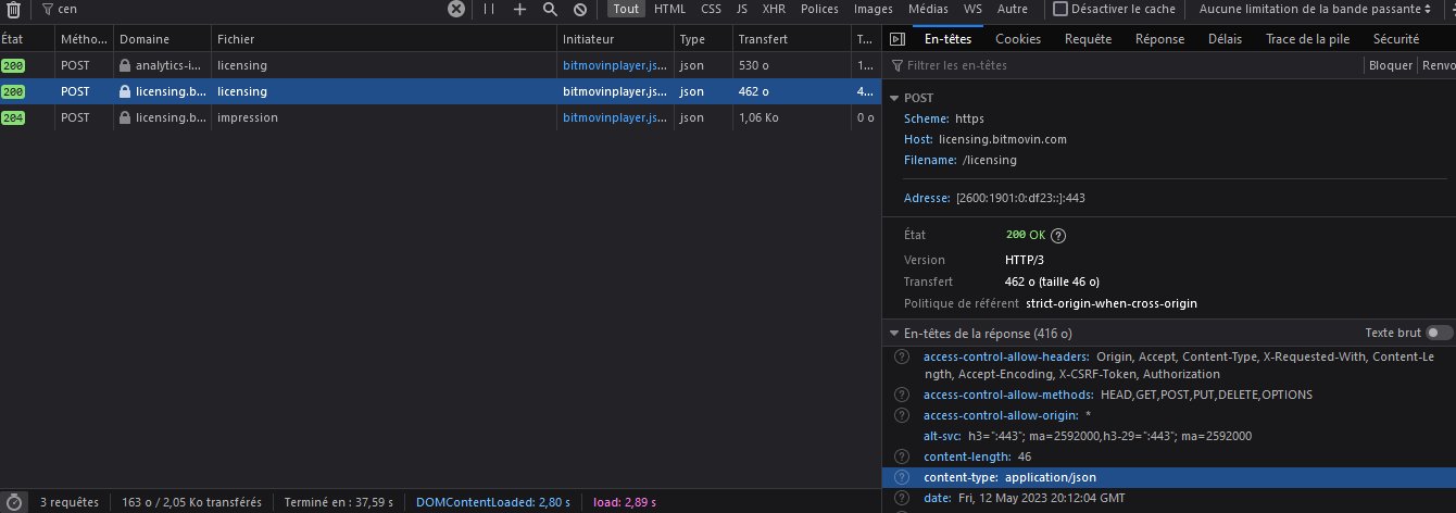

  5. And how does the payload tab of the licensing request look like?
  6. Image
    [Attachment 70978 - Click to enlarge]
    [Attachment 70979 - Click to enlarge]
    i'm not sure which one is the good one...
    in my ask for help, i can mention that this not widevine but bitmovin, so i understand that cdrm-project doesn't work.

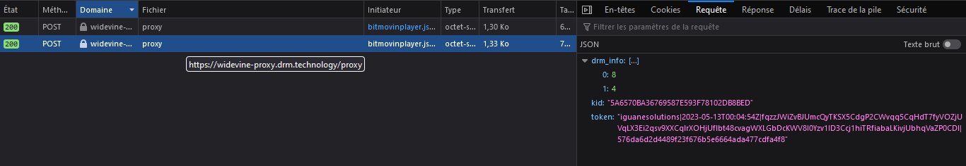

  7. What you should be interested in are the calls that deals with auth or widevine or anything else.
    Does that have any payload? The bitmovin calls are normal and they don't possess any key exchanges.
    I hope somebody from your region, who can access this service, tries and helps you out with this.

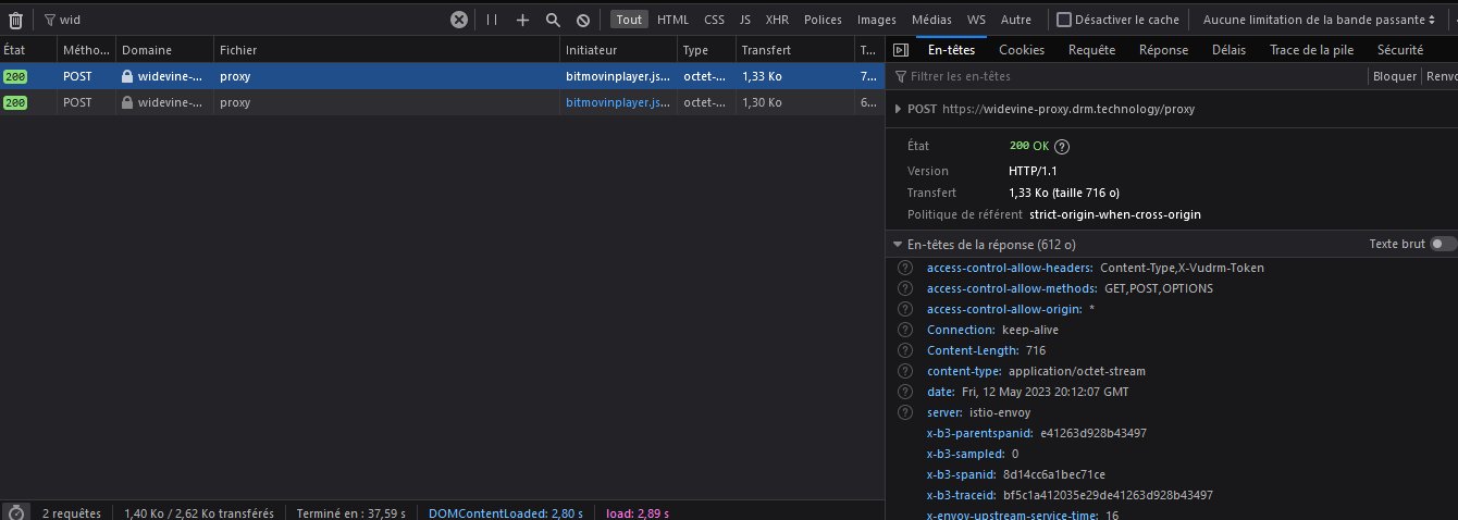

  8. Image
    [Attachment 70980 - Click to enlarge]
    something appears related to widevine...
  9. Yep. From a glance it looks like that's the one you should be interested in.

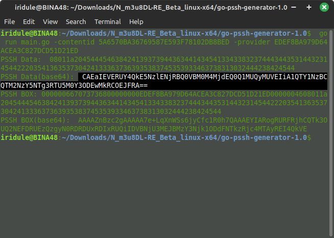

    @pram0dm I was curious and ran the KID he gave along with provider ID (which had label "uuid" in his mpd and I got something else? I would think the EME pssh data he posted is the correct ID though.
    [Attachment 70981 - Click to enlarge]
    EDEF8BA9-79D6-4ACE-A3C8-27DCD51D21ED is the content protection system id for widevine.
    also this provider (if its the same style as vrt.be) doesnt use the kid in its pssh, it uses the content id.
    while generating the pssh from the kid works for a lot of sites, it doesnt work for all and id be trusting the pssh from emelogger before a generated one.
    That specific script that you use will fail to produce a valid result for services that use WV PSSHs since it doesn't contain a KID but a ContentID. An example of such a service is VRT Max.
    Therefore, PSSH can only be extracted from the InitData that the EME script logs. So the second PSSH is what I would bet on.
