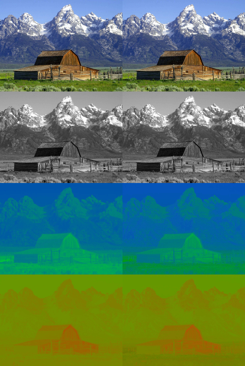

I don't know exactly what the Wikipedia image is show as U and V but I worked out something that looks similar:
Code:function ShowUAsBlueGreen(clip c) { c ShowU().Tweak(hue=-22).ColorYUV(off_u=22, off_v=-55) YtoUV(UtoY(), VtoY(), c.VtoY().ColorYUV(cont_y=-128, off_y=-40)) } function ShowVAsRedYellow(clip c) { c Showv().Tweak(hue=10).ColorYUV(off_u=-55, off_v=10) YtoUV(UtoY(), VtoY(), c.UtoY().ColorYUV(cont_y=-212, off_y=-16)) }
[Attachment 71249 - Click to enlarge]Last edited by jagabo; 26th May 2023 at 19:08.
