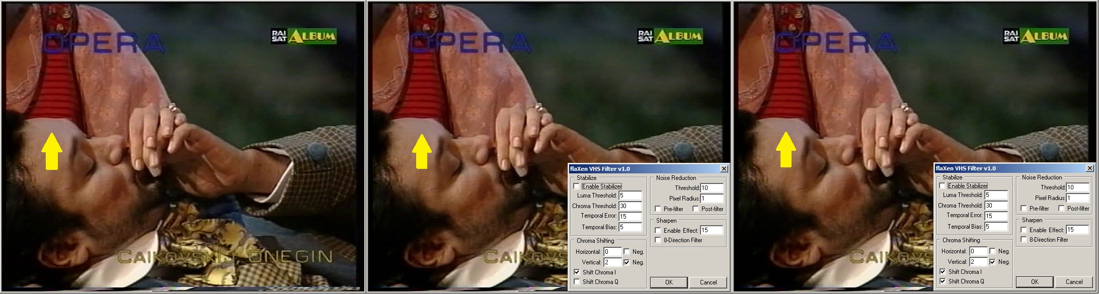

    Originally Posted by lollo View Post
    Originally Posted by Bwaak View Post
    I would shift chroma one or two pixels up and a couple of pixels to the right.
    I see a degradation doing that (also on the green logo). What am I missing?
    https://imgsli.com/MTc4MzQ2
    [Attachment 71002 - Click to enlarge]
    That red bleeding can be removed with L=-4, but the rest of the image will be badly impacted (my conclusion was that is not a full chroma shift, but just a bleeding). I may be wrong.
    Here a small sample of the raw capture, if you wish to experiment:
    [Attachment 71003 - Click to enlarge]
    Shifted chroma two lines up. I don't care much about the logo. I guess it may happen when elements added on top of the main picture may not exactly match, in this case I would choose the main picture.
    Strangely there are part of the pictures not affected by chroma shift.
    In general, if present, the shift in VHS PAL is distributed across the whole picture. Is is unlikely that there is a shif in the master video before the broadcaster applied the logo, but you never know.
    Thanks for sharing your point of view
