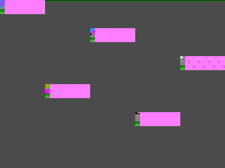

    This screenshot here shows what can be seen at the beginning of each of his recordings - perhaps this allows conclusions to be drawn about the equipment he must have used. Before each recording I have a grey screen with purple spots for a few seconds until the tape starts and plays. Whenever there are empty spaces on the tape the screen goes grey as well until the next recording begins.
    [Attachment 70917 - Click to enlarge]
    With Digital8 camcorders this screen would be rather blue, so I suspect that the playback device he used was probably not a Digital8 camcorder.

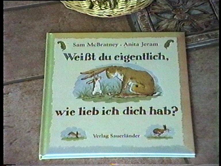

    A few weeks ago, out of curiosity, I dug out those old tapes again that had sat in the basement for 15 years and captured them with a borrowed Digital8 camcorder, which (interestingly) was possible without any problems, at least with this tape here, even without special equipment. Here you can see the two comparisons:

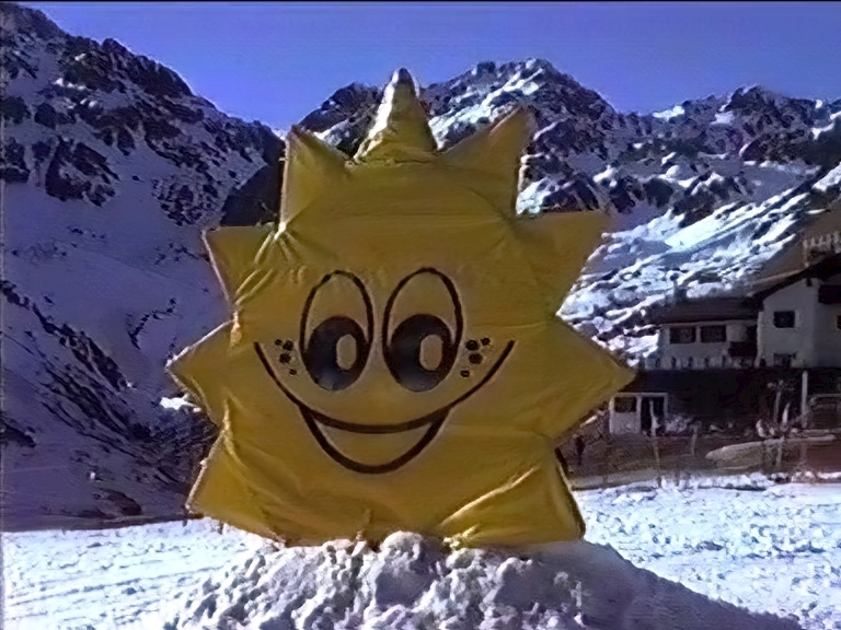

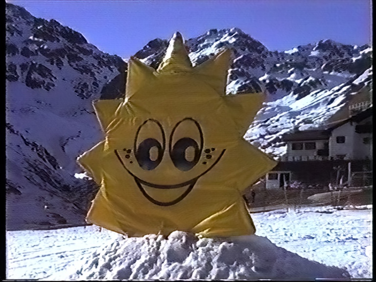

    Screenshot 1 shows the capture attempt from 2008 with unknown (presumably) special (professional) equipment, screenshot 2 shows the attempt with a Digital8 camcorder via FireWire.
    Both recordings (2008 and now) were captured in DV-AVI.
    It is noticeable that the 2023 recording is, firstly, blurrier and, secondly, the colours are much darker and richer in contrast than the 2008 recording. You can see much more detail in 2008 because the overall image is brighter and the colours are less intense.
    BEWARE: the 2023 images have been cropped to hide the jitter noise at the bottom, the 2008 capture is unedited.
    The 2008 recordings seem to have small horizontal / parallel lines visible which the 2023 recordings don't show, presumably because the 2023 recordings are less sharp and more blury by nature.
    My question now is: how does this happen? Is it because the tapes were younger and not as heavily deteriorated in 2008 compared to now? Which shot do you think is better?
    Capture 2008:
    [Attachment 70915 - Click to enlarge]
    Capture 2023:
    [Attachment 70916 - Click to enlarge]

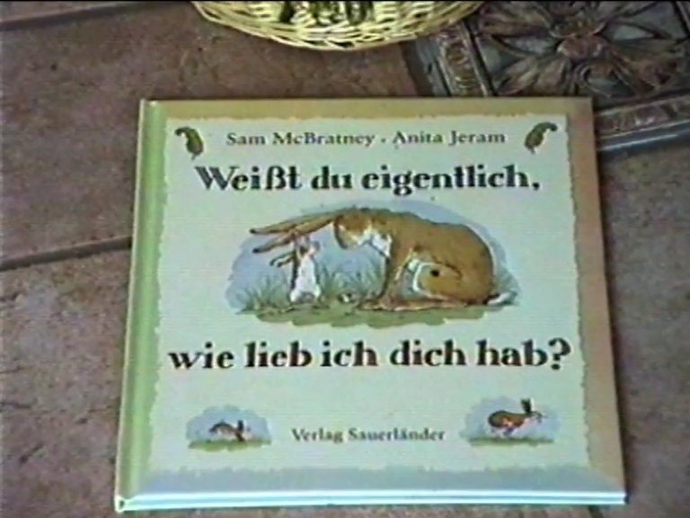

    Capture 2008:
    [Attachment 70918 - Click to enlarge]
    Capture 2023:
    [Attachment 70919 - Click to enlarge]
    Would it be worth capturing all the tapes again with this Digital8 camcorder as additional backup even though the image seems to be kind of worse than the 2008 attempt? Could this be a player thing? Different players produce different pictures?

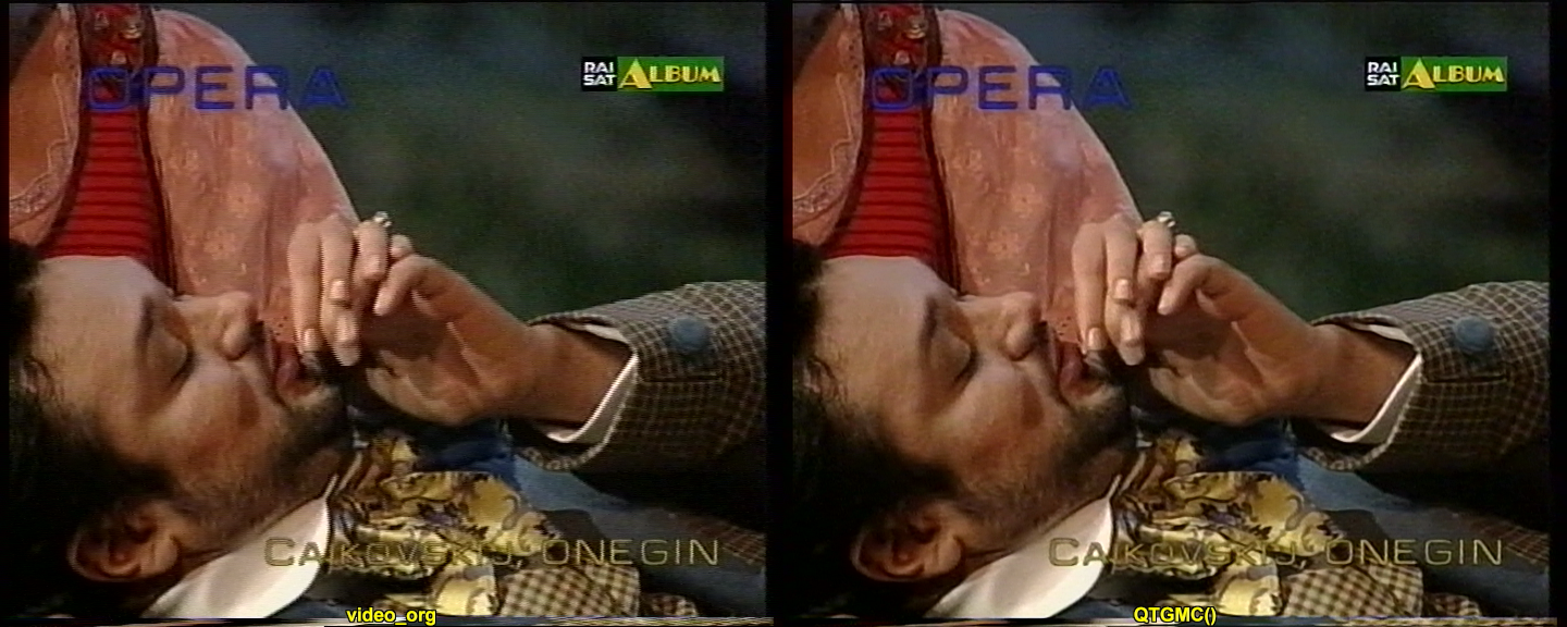

    Originally Posted by lollo View Post
    QTGMC() call alone already denoises and sharpen in a significant way
    I recently tried to set QTGMC to sharpen the video, with little success. Only unsharp (ffmpeg) on default settings gave the desired effect.
  13. Captures & Restoration lollo's Avatar
    Jul 2018
    Italy
    Strange. On analog captures I find the denoise and sharpening of QTGMC() quite evident. At the point that adding a better denoiser (TemporalDegrain2) and a better sharpener (LSFmod) after it, without taking precautions, introduces plastic look and enhaces halos. YMMV.

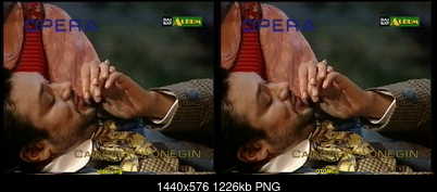

    https://imgsli.com/MTc3NjE0

    On fast setting it will be minimal, but still as I said it is a lossy process on its own.
  15. Is it a sony digital8 camcorder you were using or a hitachi one?. They 2008 caps do have signs of the typical chroma bug on the right side that the newer sony video8/hi8/digital8 camcorders had, though can't say for certain. The picture below the head switch line isn't straightened up with the TBC in these tends to be able to so maybe a variant without TBC or with TBC off. (Would make sense that they used one of the less featured ones for messing with alignment I guess.) Suppose DNR on/off and EDIT setting could have some impact even though I've never seen much difference with those on/off.
  16. Captures & Restoration lollo's Avatar
    Jul 2018
    Italy
    The opposite. Sharpening will be slightly slightly higher, because is less accurate. Deinterlacing will be lower in quality for moving objects, and denoise will be less effective (the frame I used for comparison is quite static and not very noisy).

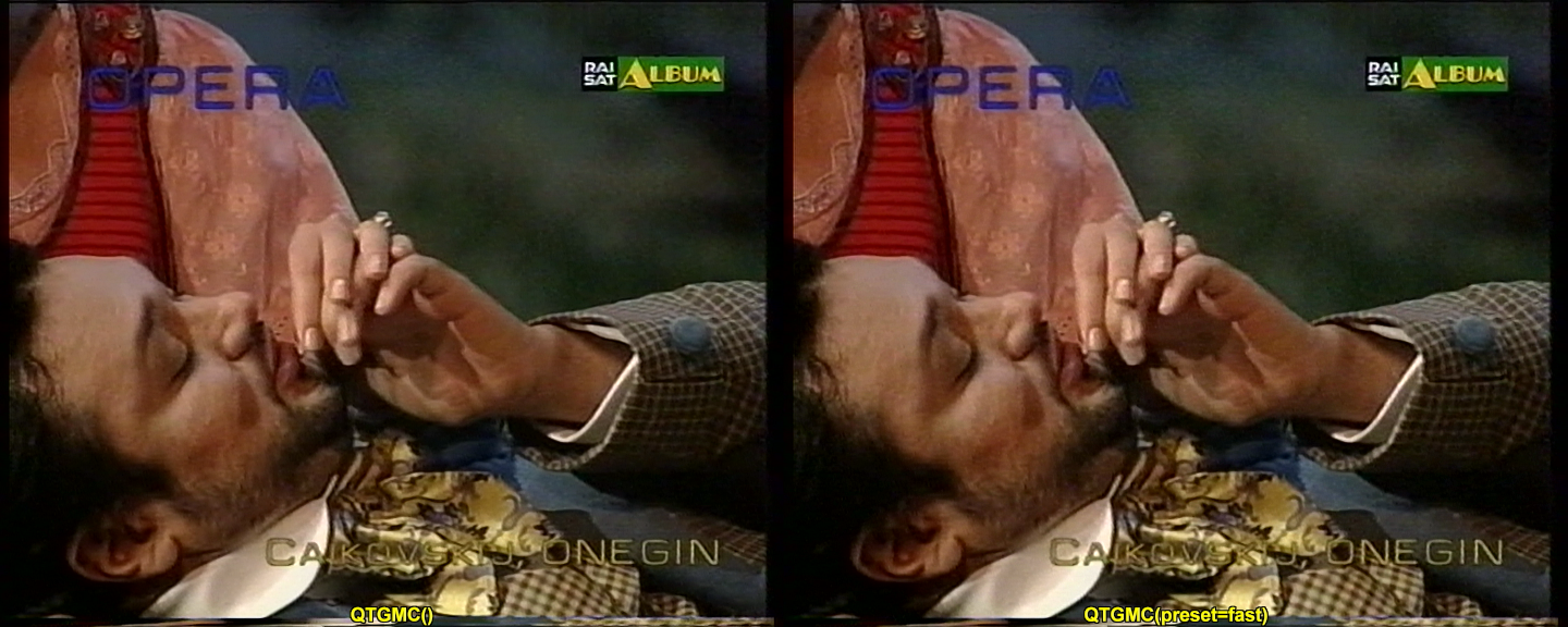

    https://imgsli.com/MTc3NjYz
    Or, at a first glance, not much difference for denoise and sharpening, just lower deinterlacing quality
    edit: if you have samples where this is not true, it will be interesting and instructive to see them, please, if you can upload some
    [Attachment 70952 - Click to enlarge]

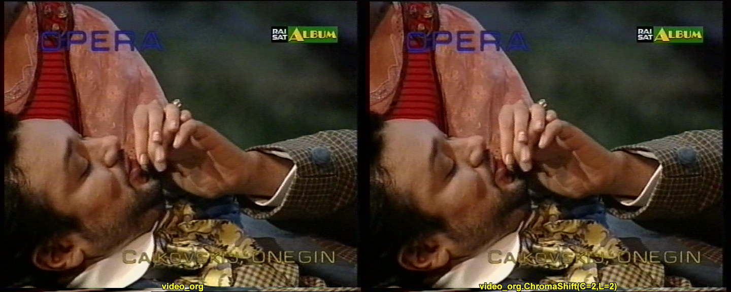

    I don't see much difference. I would shift chroma one or two pixels up and a couple of pixels to the right.
    Yes, using fast option in QTGMC compared to default settings does not reduce sharpening in this video.
    Originally Posted by oln View Post
    You can adjust the degree of sharpening in QTGMC with the sharpness parameter as well.
    Correct. I was just comparing the outputs without acting on sharpness parameters.
    In general I use something like:
    QTGMC(preset="slow", matchpreset="slow", matchpreset2="slow", sourcematch=3, tr1=2, tr2=1, NoiseTR=2, sharpness=0.1)
    or some variant of it, based on some ideas I used from a discussion with Skiller.
    Arrh Ha. I am doing some Video8 to DV on my Digital8 camcorder and that is the pattern I see at the start of my captures as well.
  25. Member
    Feb 2022
    Germany
    Interesting. I thought they were always blue for Digital8 camcorders. Well, whatever..
  26. Member
    May 2005
    Australia-PAL Land
    Yes, its starts off with that pattern then changes to blue (with a message "D8>8/Hi8" or similar' that'd be the mode change. I suspect that it only occurs when it's not a D8 tape.
    I see a degradation doing that (also on the green logo). What am I missing?
    https://imgsli.com/MTc4MzQ2
    [Attachment 71002 - Click to enlarge]
    That red bleeding can be removed with L=-4, but the rest of the image will be badly impacted (my conclusion was that is not a full chroma shift, but just a bleeding). I may be wrong.
    Here a small sample of the raw capture, if you wish to experiment:
