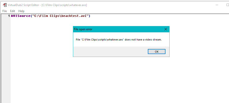

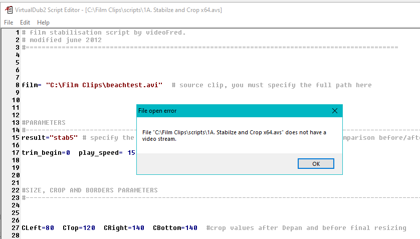

    And yet, all I get, despite all this, even the very simple one Fred proposes as a first AviSynth exercise [AVISource("C:\Film Clips\beachtest.avi")] is an error that my avs file "does not have a video stream". See screens below. The clips are fine in MediaPlayer, and I have tried more than one clip from more than one source.

  4. So you have type 1 DV AVI file -- DV encoded video in an AVI container without a separate audio stream (the video stream includes the audio). I didn't realize that MediaInfo would report audio for a type 1 DV AVI -- but it does, I just checked one here. I had no problem opening a type 1 DV AVI in VirtualDub64 here. Can you play the video? With which player? Can you open the video with AviDemux? Do you have a DV codec installed?
    Another thing you can try is to open the video using a different source filter. In the Open Video File dialog there's a "Files of type" pulldown near the bottom where you can specify a particular source filter. Try "FFMpeg : video".

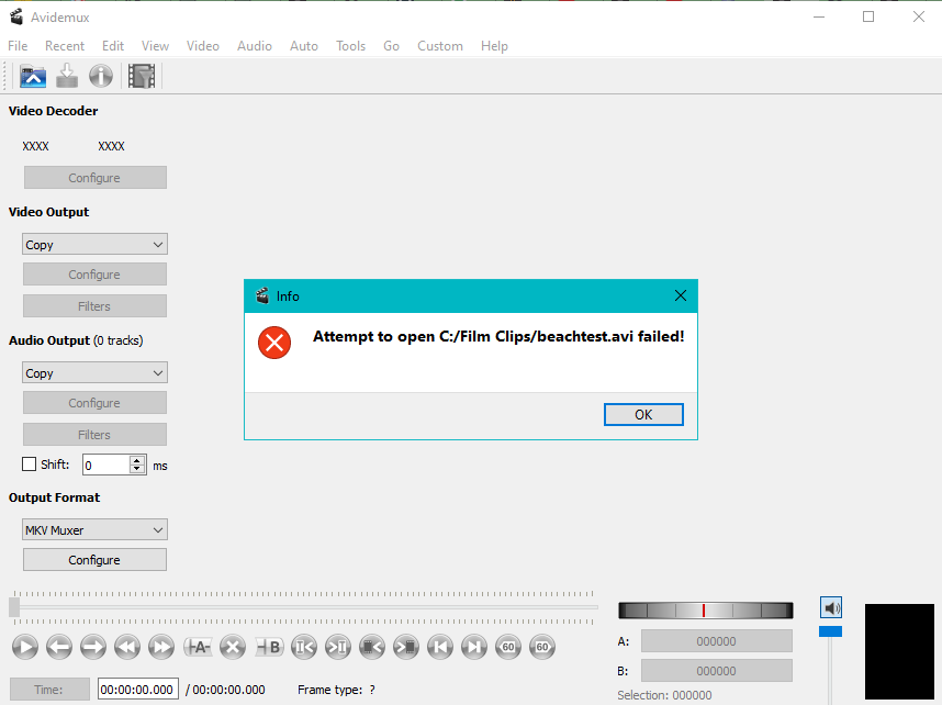

    * BUT.... It will not open in AviDemux. What could this mean?

    I can't open the type 1 DV AVI I have here in AviDemux either. Viewing the video with a hex editor I see an "iavs" (a four letter label that identifies the data that follows) chunk where Type 2 DV AVI files have a "vids" chunk. I'm guessing "iavs" stands for something like "interleaved audio video stream". The stream of data that comes from a DV camcorder includes both audio and video. Type 1 DV AVI files store that combined data as a singled stream in the AVI file, marked as a video stream. Type 2 DV AVI files store the combined data as a video stream, but also make a copy of the audio data and save it as explicitly as an audio stream within the AVI file.
    Anyway, It looks like some programs have problems with iavs chunks. If I remux it with ffmpeg I get an AVI file that will open:

    The partial script you show in your first post doesn't show where the file is being opened. It just shows the line where the file name variable "file" is being set. Presumably later in the script is the AviSource() that uses that variable to open the file.
