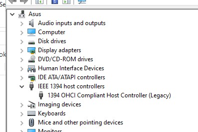

    I doubt there would any frying here as both plugs are 4-pin.
    What version of Windows do you have?
    If it's Windows 10:
    Without the camera plugged in, you should have the IEEE1394 Host controller entry:
    [Attachment 70881 - Click to enlarge]
    If not, install the Firewire drivers using the procedure on this page:
    https://www.startech.com/en-us/faq/firewire-cards-windows-legacy-driver-swap
    More info on Firewire here:
    https://www.studio1productions.com/Articles/Firewire-1.htm

    Yes its Windows 10 and i installed the same drivers a few days ago so thats what it looks like when i open up the device manager but when i plug in the camera nothing happens. theres no sound, no pop up and no new device in the device manager
    Is reinstalling the drivers worth a try?

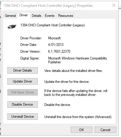

    This is my driver; yours the same?
