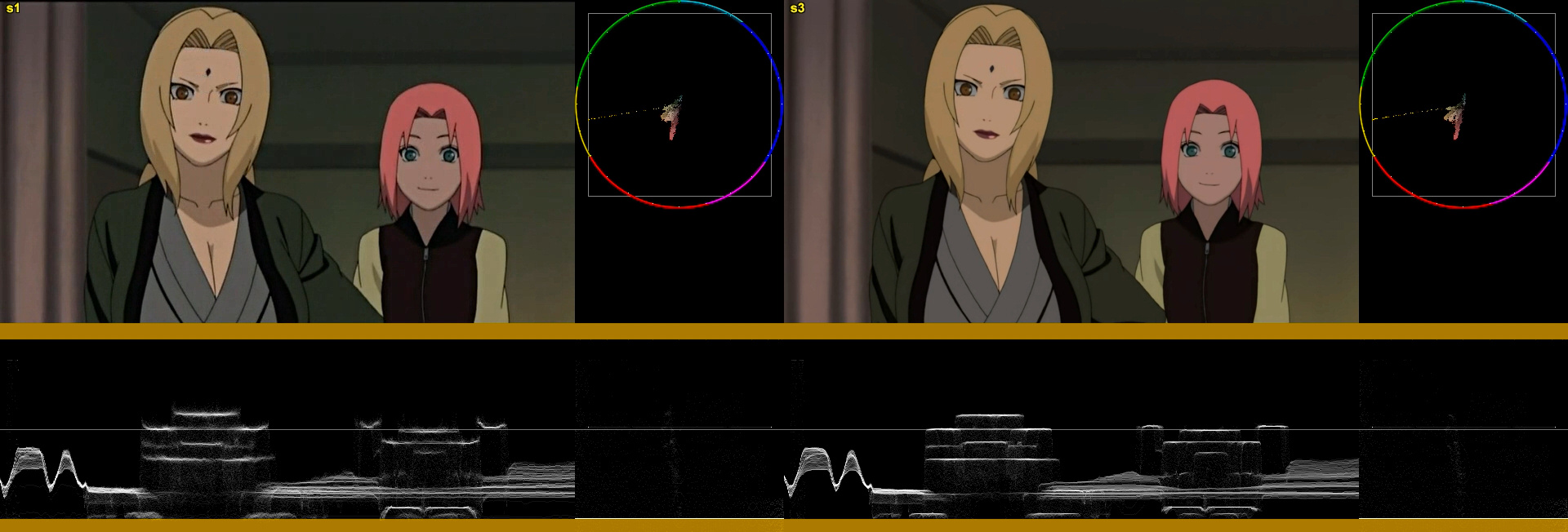

  5. This gets s3 to match s1 moderately well:
    s3 = s3.ColorYUV(gain_y=0, off_y=-4, gamma_y=20, off_u=-3, cont_u=15, cont_v=8)
    But there aren't a lot of different colors (and no greys or whites) so it's hard to be sure whether this will screw up other colors. The background colors (greenish tint on the walls) are still pretty different.
    [Attachment 71061 - Click to enlarge]
  6. Thanks for testing !
    Hmm, but the color of the coat of the blond girl is still not the same. I see it already in the thumbnail of the post here. Same for her Hairs. But it looks better on her. But you are right, the clip i s a bit short. Maybe it destroys the color on another scene.
    But much more important: how do you get these values? How do you decide to take Gain_y=-4, gamma_y=4 and so on? When i do an analyse of the video as i postet above. how can i calculate the "offset" between two videos by myself?
