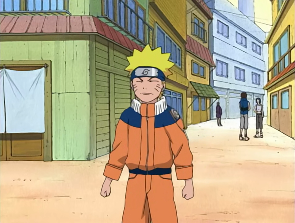

  1. I have one source, it has a bit changed color (Source 2), but it is the better source in some other aspects. That's why i want it. But i wan't to change the color to the color, the other Source has (DVD Source).
    Does anyone have an idea, how to do that ?
    Here are some pictures: https://imgsli.com/MTc2ODM4/4/5
    And here is the second source: https://uploadnow.io/f/Tjtz11N
    The pictures are already upscaled, but the videos are the original input-sources of the pictures.

    1 DVD reference, converted to RGB using 601 matrix, then upscaled.
    [Attachment 70850 - Click to enlarge]
    2 video viewed in RGB using rec709 (this is how it would look normally)
    [Attachment 70851 - Click to enlarge]
    3 video with 601 to 709 shift, then viewed in RGB with 709 matrix.
    [Attachment 70852 - Click to enlarge]
  3. Ah ok, i get it, somehow.
    But im a bit confused now. Is the video "source 2" now in 601 or in 709 ? The "source 2" is not a edited version of de dvd. It's a own source (they have no same origin).
    So could you explain me, what conversion i have to do for the "source 2" video? From what to what ?
    Sorry, im unsure
    Edit: So both versions does not change color when upscaling. But the Source 2 has already a changed color.

  7. Originally Posted by poisondeathray View Post
    If you're still lost, Source 2.mkv was upscaled, but it still has "SD color". ie. It uses 601 matrix, same as the DVD . But a typical playback chain will display it using 709 (convert it to RGB for display using 709 matrix) , so it will appear "wrong" . Some mediaplayers and devices will playback SD (=<576 height) using 601, HD(>576 height) using 709. Others will take precedence by reading colorimetry "flags" (these can be set during encoding, or sometimes in container. Encoding in bitstream is better, because if you remux, you can sometimes lose container flags)
    So if you flag the colorimetry as "601" some media players/device will obey the flags, but some will not . Best practice for "HD" (>576 height) , is to use 709 matrix for actual colors , and flag as 709 matrix as convention (HD uses 709) - this has the highest chance of playing properly across all software/hardware under all situations
    Yeah, im still lost
    But when i check the details of "source2" with mediainfo it shows me BT.709 matrix, not 601.
    So why does it not work, when i use colormatrix from 601 to 709?
    Edit: But i got it working now with hybrid:
    In NVENC->Misc i had to deactivate "matrix", then in color-matrix use bt470bg and then in the Filtering-Tab of Vapoursynth using Color->Colormatrix with Rec. 601/470bg/470m to Rec. 709.
    [Edit2: I dont need to do sth in filter-tab. It will get automaticly correctet in hybrid, if i do the first thing in NVEnc-> Misc setting. I can do that on the fly, while upscaling or so. The upscaled video will then be fixed]
    Now the color is like in the dvd.
    Thanks @ lolo, but got it working now.

  27. Hy guys :
    I have another color-story
    This time i tried already with the knowledge, i got from this thread, but i can't get it work and im not sure, what the problem is.
    I have this time 3 sources. The first is orginal bluray and a "source 2" and a "source 3". I want to use source 3, but want to have the color form the bluray. But in mediainfo it does not show me any information about colormatrix (i dont see it).
    I did following in hybrid with source 3:
    In Filtering-Misc i overwrote the input color matrix to "rec.601/470bg/470m" and in Vapoursynth-color--matrix-colormatrix i choose from "rec.601/470bg/470m" to "Rec.709".
    When i do that, the color from source 3 is now exactly like source 2. Quite similair to bluray, but not the same.
    So because i don't know, whatthe colormatrix of the bluray is, i have to ask here again. And im also not sure, if the problem is even about colormatrix or sth else. So my question is, what is the colormatrix of the bluray and how do i see that in mediainfo ? And is the problem a colormatrix-problem or is it sth else? Because then i try what lollo said in post #6. Or maybe there is a different solution.
    Here are 5 Files. The bluray, source 2 & 3 (untouched) and an upscaled source 2 and an upscaled and color-corrected source 3 (as i explained above).
    https://uploadnow.io/f/wVjpyln
    Edit: Voices are different, if you hear close. But that's only because of different language.
    Edit2: I cant' mask it with the bluray, because the bluray has different intros/outros and then the actual content of the episode does not start at the same time.
    But is it possible with hybrid to "detect" gamma-level and then i can just globally adjust it?
  28. Update: I found out, that not source 3 is wrong, it is source 2.
    That does not mean Source 3 is same as bluray, because i had to fix it too, but it was no colormatrix-problem (so at least i think that, but if you say it is, then tell me). I could make the style from source 3 quite similair to bluray, when i use in vapoursynth-color-basic "levels" with 1.05 gamma and "tweak" with 0.85 saturation (that's the most important) and -5 brightness. I have to final-check the settings, but now it looks like the bluray. But at the end, im not sure, if the bluray is "right", because it's quality is quite bad. So at the end i take that, what i like most.
    It works also, when i only use 0.85 saturation, but with 1.05gamma and -5 brightness it's even more close to bluray. But as i said, i have to decide, what style i want, because the bluray is made bad, so...
  29. I have an update again (final one). It is even more complicatet. But i have one question now.
    What i said above is not wrong, but i found out now, that the bluray itself is wrong in color. I had to search a scene with the girl which has pink hair. Because her hair is very sensitive to colorchanges. And there i could see her hair in the bluray does NOT have the right color (because i know it).
    So but i could fix that too (in source 2 und 3 and bluray). I will explain my results:
    For making it easier, always when i say now "color-matrix change" i mean always that: "In Filtering-Misc i overwrote the input color matrix to "rec.601/470bg/470m" and in Vapoursynth-color--matrix-colormatrix i choose from "rec.601/470bg/470m" to "Rec.709"."
    And when i say "color-change" i mean always that: "i use in vapoursynth-color-basic "levels" with 1.05 gamma and "tweak" with 0.85 saturation (that's the most important) and -5 brightness.".
    - Source 2 with "color-matrix-change": Does nothing, because i guess it is already the "right" one. But actually color is still wrong.
    - Source 3 with "color-matrix change": Looks exactly like Source 2 now. Color is still wrong.
    - Source 3 with "color change": Now it looks very similair to the bluray (only similair, because it's a question of the right values there)
    - Bluray with "color-matrix-change": Now this looks right (lol).
    Questions: Problem is now, i was not able to make source 2 or 3 looking like the bluray with "color-matrix-change" with a matrix-change. Does anyone has a clue, if it is possible ?
    Anyhow: How do i now made Source 2/3 looking like the bluray with "color-matrix-change" ?
    It worked for me, when i make the "color-change" with source 2. It also worked, when i first do the "color-matrix-change" with source 3 and then i use the "color-change". It looks now 98% the same like the fixed bluray (in my eye).
    And btw: I fixed the Bluray as i quotet above. But when i use 1440p on upscaling, hybrid choose automaticly rec. 2020 (i could force it to be 709 manually). But when i let it on Rec.2020, it has also the wrong color. So i have really to force it to Rec.709. I think this whole series is produced often with wrong colors (depends on region). At the end, i actually can't say, what color now the "right" one is. But it just looks wrong for me, when i don't do it like that.
    That was now a big "research" lol. The last one was easier.
    Edit: In another scene it does not look right. strange, have to do more research. No, it works. Just had a mess with my files and edited color on wrong file xD. It's fine now
