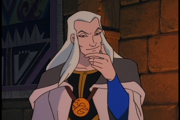

  1. I want to remove rainbows, and this source has a lot of strong rainbows in it.
    My rainbow removal filter of choice is bifrost.
    This source requires a high secenlumathresh setting of 10-20 to actually remove most of the rainbows in several parts. Some parts can use a lower setting like 4 and it gets them all. The problem is, once I set it any higher than 6, a lot of the scenes with faster moving motion or that have a panning screen in them get colors/chroma from other frames in them, and it messes up the colors. This is a side effect of more aggressive rainbow removal.
    https://forum.videohelp.com/images/imgfiles/52lA2E9.png
    https://forum.videohelp.com/images/imgfiles/XK576cL.png
    I tried using altclip like this hoping it would only use a higher scenelumathresh when needed.
    bifrost(scenelumathresh=6, altclip=bifrost(scenelumathresh=14))
    It works, but the problem is the motion scenes are above the threshold so it is still using the higher scenelumathresh even in the motion parts, and causing the color/chroma issue just the same.
    I tried a few other derainbow filters as well and they either have the same problem or don't work as well as bifrost at removal of the rainbows.
    Is there any good way I can use a high scenelumathresh for derainbow, but protect the motion frames from the color distortions better?
    If it were only one movie or 1-4 episodes I would just go through every individual frame, and only use the higher scenelumathresh on frames that need it, leaving the motion frames to go with the lower setting of 6. This is a lot of episodes though, and would take more time/patience than I have for that option.
    Nothing else comes to mind when I think about how to solve the issue. Any ideas would be appreciated.
