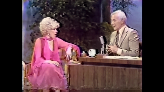

  1. Looking at restoring video to as close as possible to being artifact free and sharp.
    Here is the video clip -
    JR_JC.avi
    It appears that there is some ghosting(?), color smearing, and distortion particularly at the bottom of the clip.
    As I'm a beginner I really don't know which filters should be used (and in which appropriate order) to remove ghosting and color smear, and remove the distortion as far as possible.
    Detailed/sample script(s) would really be appreciated in order to do this video clip restoration.
    Thank you very much!

  4. In my opinion, you are not getting rid of the garbage at the bottom unless you crop it off, or recapture the video from tape again in better quality. You cant just magically erase all that black and white static and get picture back that's been destroyed.
    I don't see any ghosting in the sample.
    Maybe its just a bad sample that's way too short, but I literally don't see anything you can improve except maybe sharpness with a sharpener and chroma sharpening.
    mergechroma(awarpsharp2(depth=3, blur=1, type=1))
    ChromaShiftSP(x=-1.00, y=0.00)
    LimitedSharpenFaster(ss_x=1.00, ss_y=1.00, strength=5, overshoot=0, undershoot=0, soft=0, edgemode=0)

  6. SpotLess with a temporal radius of 3 helps with some of the noise&blocking, see: https://imgsli.com/MTc2NTM3
  7. Dirty trick!
  8. So, since the camera was locked down and she didn't move her lower body, did you just copy a clean frame and merge the lower part into the bad video?
  9. Dirty trick indeed!
