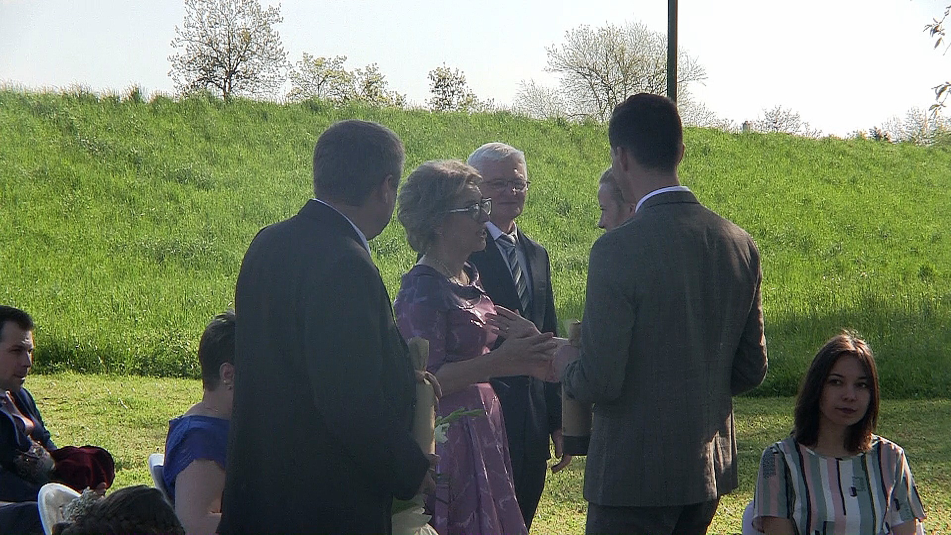

    2. In the clips called "haze" and "haze2", you can see that for some reason, the center portion of the image became dull and lacking contrast. It is like that on all scenes that I shot that day, I have no idea why, maybe there was something on the lense. Is it possible to correct this error?

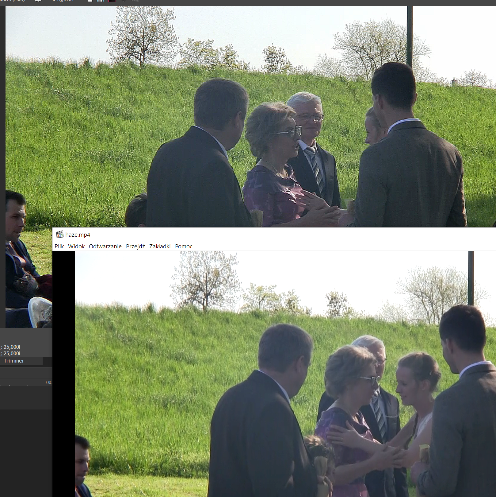

    First of all, the "haze" video has a color range of 16-255 and is labeled as "limited" (16-235). You lose the blue color of the sky.

  8. The haze is almost certainly caused by refraction off the bright sky. The lens coatings that minimize that are why good lenses are so expensive. I'll bet you a donut any shots pointed in the other direction do not have that issue.
