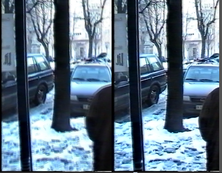

 deinterlacing:
 [Attachment 70800 - Click to enlarge]
 on right the version with QTGMC
 [Attachment 70801 - Click to enlarge]

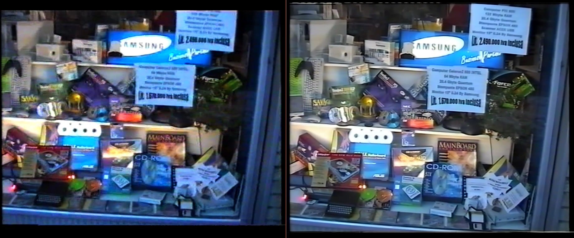

	Emh... BTW thank you for everything , thanks to your help i was able to obtain a very beautiful conversion... maybe not the maximum but still better than the image that i can see on a TV directly from the VCR...
 [Attachment 70849 - Click to enlarge]

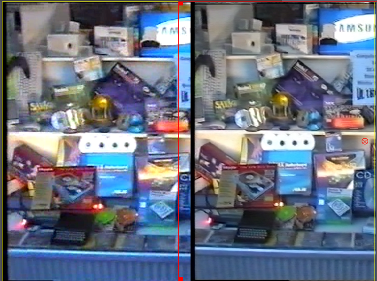

 on the left best quality that i can obtain with 60/200 euros USB converters and relative softwares.... on the right my final result
	Glad you're happy, but please post a sample of your untouched capture. A still image says nothing.on the left best quality that i can obtain with 60/200 euros USB converters and relative softwares.... on the right my final result
	Does it matter? Bartoloni is happy. Are you going to convince them to go into a full-scale AVISynth training course? Probably not.Glad you're happy, but please post a sample of your untouched capture. A still image says nothing.
 And to me, a still image tells us a lot. Perhaps you would like to see what could be done with the original capture, but to say "a still means nothing" is a bit rich. How many times have you flashed Imgsli pics at us?
	Correct, I did not explain well my request.And to me, a still image tells us a lot. Perhaps you would like to see what could be done with the original capture, but to say "a still means nothing" is a bit rich.
 OP wished to deinterlace on the fly while capturing, something that we did not recommend. And resize. And use lower quality (but maybe acceptable) deinterlacers. I just wanted to tell him that his capture is ok, or trying to help if there is any problem. Then the request for a video sample.
 When I post a single image is because we are checking specific aspects, for example the details left/erased by a denoiser, or the halos induced by the sharpening, where a still can say a lot. Of course, a video is always mandatory; the image still is a complement.
