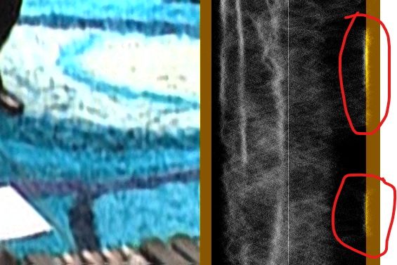

  2. The bobbed and upscaled video has clipped whites and the file size is 4x larger compared to the original. The superwhites of the original got clipped, means any details/gradations in there are lost.
    What's the purpose (and benefit?) of upscaling?
    Edit:
    Here 2 pictures showing the loss of details. Left from the original with superwhites recovered. Right is from your upscaled version.

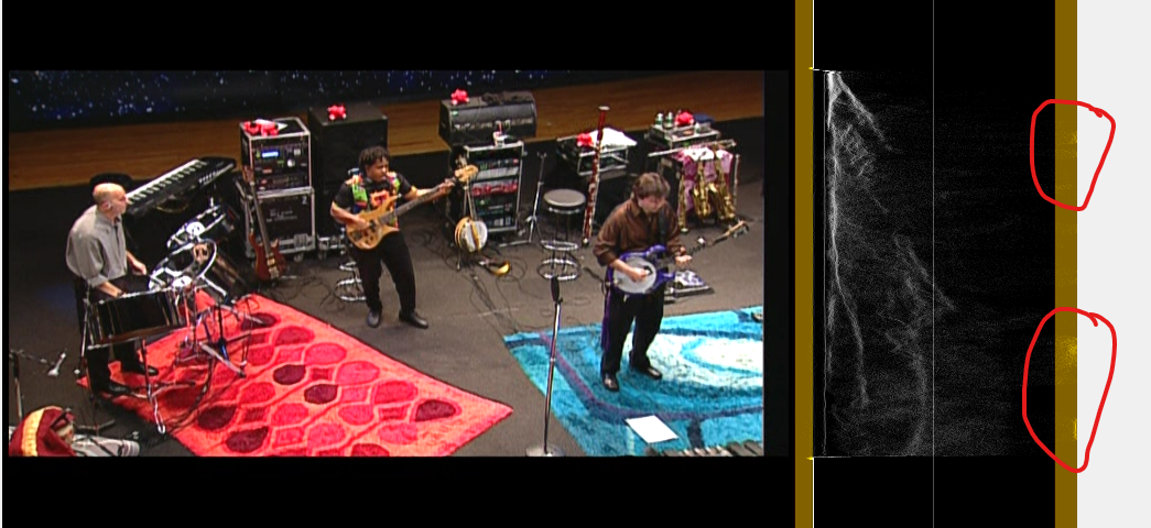

  4. @lollo
    What I mean is this:
    The top picture is the original with superwhites in the Y=235...255 range. These won't be seen on a RGB monitor or TV, but can be recovered by bringing the luma into the 16....235 range, revealing all details. This is what I did in post#2, left picture.
    The bottom picture is the upscaled variant of the OP with crushed whites at around Y=235. Converting to RGB shows clipped R,G,B waveforms. So I would recommend to adjust the levels before encoding to bring them into the 16....235 limited luma range.
    (Being more nitpicking one would actually have to ensure RGB gamut compliance rather than just the luma.)

  6. Originally Posted by lollo View Post
    To summarize, I think the loss of details you properly noticed IMO is not related to levels ("parameter" of the video where all your/mine comments applies anyhow)
    There is a clear accumulation of luma IMO around Y=235 with much less 'swing' compared to the original. Looks like a luma compression in that range, for whichever reason. Even when we shift the level of the upscaled version down, it is still accumulated at a lower Y. Means details and shades are lost in that area. And my doubt remains: Why upscaling, just blowing the file size 4x up and loosing details. What's the purpose?

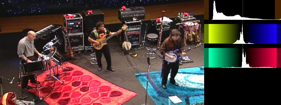

  12. Study the functions "Levels" and "Histogram()" in Avisynth.
    Insert in your script after the source filter something like
    Levels(0,1.0,255,0,235,coring=false)
    It will shift the superwhites of the source from Y>235 to Y<235.
    Or with similar effect you may use
    Tweak(0,0.92,0,0.92,coring=false)
    Or with similar effect:
    ColorYUV(levels="PC->TV")
    Levels(16,1.0,235,3,235)  #restore the black level
    Use Histogram() to visualize and check the waveform. Or try jagabo's commandline
    ffplay.exe -hide_banner -loglevel 24 -stats -loop 0 -i "Live At The Quick.mkv" -an -sn -color_range 2 -vf "split=2[a0][b0];[a0]waveform=filter=lowpass:scale=digital:graticule=green:flags=numbers+dots:components=1:display=stack:envelope=instant[a0o];[b0][a0o]vstack[out]"
    Sidenote:
    The issue with the levels becomes aggravated in the scene from frames 867 to 946 where the levels makes a sudden jump upwards of about 16 steps (shift of the "black" level).

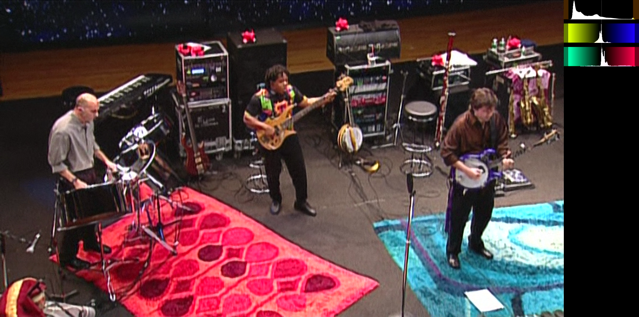

  13. Originally Posted by Sharc View Post
    [/CODE]
    Thank you very much for your help, I finally got the histogram to work as I wanted and could verify what you said. The one quoted above is the one that gave me the best results even though I'm still uncertain since it depends on which part of the video I'm playing. Some did better in dim scenes whereas other worked better on bright scenes. The one quoted above was generally giving me a better result all along the video. Although it might just have been my mind playing games and "I think it's better" is more appropriate than "It is better".
    Regarding this, I'm curious as to why we adjust the luma levels before converting the colorspace and colormatrix. Is it because that after the color conversion the luma data is lost and can't be adjusted from Levels()?
