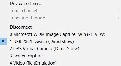

    I am unsure if this is the appropriate forum for my query. I have spent several hours searching online but have been unable to find a solution.
    My issue pertains to the Logilink USB Video/Audio Grabber (VG0029). The device uses the default Windows 10 driver (Masster AVcap). I have successfully connected it to two different VHS players using s-video and composite cables. Although the audio is functioning well, the video appears to be jumping erratically. I have tested both 32 and 64-bit versions of VirtualDub2, but the problem persists. I guess it's not Virtualdub that is the problem, I tested with OBS too.
    I tested to select "Microsoft WDM Image Capture - But it Blue-screen the system :
    [Attachment 70671 - Click to enlarge]
    As the issue is not with the VHS players, I suspect that there may be a problem with the capture device itself or maybe with Windows 10. I would greatly appreciate any troubleshooting tips that could help me to identify the root cause of the problem. What and where do I have to look?
    In the meantime, I have purchased a new capture device, the Digilink VG0030. Although this device is relatively inexpensive, I am uncertain whether the issue lies with the original device or elsewhere.
    Thank you

  3. In the past (approximately two years ago), the device had functioned properly when I attempted to use it. These devices are similar to other electronics in that they are manufactured with identical components but have different designs. They typically range in price from $20 to $60, with the internal components remaining the same.
    That's why I didn't get head first in the most expensive ones.
    It is possible that updates to Windows 10 may have caused issues or that some other unforeseen problem occurred. It is also peculiar that Windows 10 crashes when selecting 'Microsoft WDM Image Capture'.
    Tomorrow, I will test the new revised version (VG0030 instead of 0029) to see if it experiences the same issue. If it does, then I will know that the issue lies with the computer rather than the device itself. If the new one works, maybe it just "went bad", I've seen it with other electronic products. And maybe it's why Windows has a blue screen when I want to use Microsoft WDM Image Capture with it.

  6. You far from the first to have this sort of issue in win10 with a capture dongle with that chipset:
    https://forum.videohelp.com/threads/402211-Windows-10-update-has-rendered-USB-2861-Cap...evice-unstable
    One or more win10 updates at one point broke a lot of capture device drivers and unless the driver has been updated or you can find one for a device with similar guts that supports it that is you'll likely to run into issues with these. These USB dongles are typically based on some generic OEM design with a bunch of different branding, usually with pretty minimal changes by the brand that's selling them so updated drivers are often hard to come by (though Logilink is at least not a complete no-name brand).

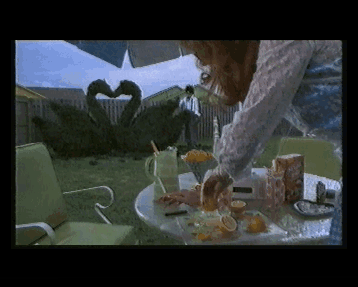

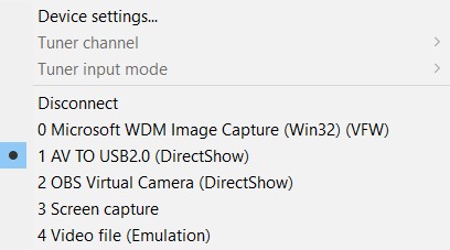

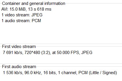

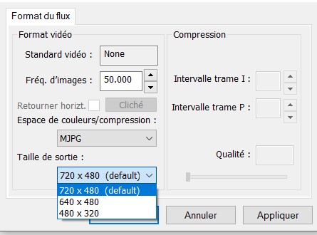

  13. I received the Logilink VG0030
    The vg0030 displays a stable image at least, but the image is already de-interlaced, and there are no controls like with the older one.
    That was one of the reason I liked the old one, it just passed the signal raw, no processing, and I could decide what to do with it. Deinterlace it myself.
    I can only capture in MJPEG eew, and it's not even in a PAL format. Which the old one didn't use lol.
    Anyway, like I said, it's not of a big of a deal. Now It looks like the VG0030 is worse than the previous model (but at least it "works")

  14. Member DB83's Avatar
    Jul 2007
    As you said "At least it works"
    From a viewpoint of troubleshooting, can you describe the installation process of this new one. It does appear that the unit has hard-wired mjpeg encoding rather than soft-wired. Is there a driver installation ?
    If you are going to use it then I would, if you can, change the 'default' from 720*480 to 640*480. At least then you will get 4:3 natively.

  15. Originally Posted by DB83 View Post
    There was no driver installation (I contacted logilink to see if they have specific drivers for it). I don't have hope for that.
    Yeah that's what I changed, but I won't use it. Of course it's better than having nothing to capture, but the quality is pretty trash.

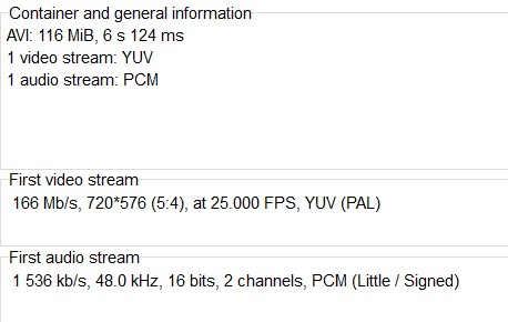

    I won't use it, since I need to capture the most raw feed possible so I can archive old VHS properly.
    I'll just buy the Hauppauge USB-Live-2 at 50 bucks, and return the Logilink VG0030. If you tell me that the Hauppauge would just do what the old one did (before it stop working)

    Glitches appart, the old one outputs exactly what I needed/need, it's just "raw" PAL. The new one, lol, well, seems to be a trash revision.
    As for the other one, as stated by myself and later confirmed by Oln, it is more than likely that Win10 has 'killed' it. Investing in another will probably give similar results since all are typically based on this Empia chipset (and if you think my words were harsh, thank yourself lucky that lordsmurf - who does know his stuff - has not seen the topic.)
    And it's a shame, because my old Logilink was the only one just outputting the images without any processing on it, years ago when I wasn't serious at all about saving my VHS tapes. I knew the ones I tested were trash (not the vg0029 at the time), but I wasn't serious about it.

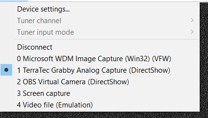

  18. Well, guess what.
    I found a Terratec Grabby in my closet where I had tons of old electronics!
    There was a CD with it, I installed the driver, Win 10 didn't recognize the device, it works. It says that the driver is from 2009
    [Attachment 70715 - Click to enlarge]
    [Attachment 70717 - Click to enlarge]
    I still have to see if the s-video output work too
    Edit: Well, the image is now jumping too .... and I saw that Windows removed the driver to put their shitty one.. WTF

  20. I believe I found out why the Logilink (and now my Terratec) don't work!
    Windows constantly overide the drivers installed manually.
    I imagine that he did it with the Logilink too, Windows just want to use their driver.
    Anyone knows how to force install a particular driver? I was able to do it with the Terratec Grabber just 1h ago!!! The device wasn't recognized in the Device Manager, I selected manually the driver that was on the CD, it work.
    The image was perfect. I disconnected the usb cable to put it on another port, then the image started to glitch like the Logilink! I checked the device manager, and Windows removed the Driver I installed to put theirs..

  22. Originally Posted by DB83 View Post
    Well if that driver you 'found' is dated 2009 it is most def NOT a Win10 driver (which is only current from 2015)
    Would go a long way to explain why once a device id disconnected the 'default' driver takes over.
    [Attachment 70718 - Click to enlarge]
    Well it worked, just for a little bit.
    What I did was :
    1) Connect the Terratec
    2) Windows didn't recognize it in the device manager, and there was a /!\ (which is good because Windows didn't install anything)
    3) I installed the drivers manually by pointing at the folder on the CD (which was in the box)
    4) It installed it
    Then it worked as expected, flawless image, no jump/glitches.
    I decided to just connect the usb cable from the front panel to the back, so it's cleaner...
    I relaunched VirtualDub2, selected the device, then it started to glitch exactly like the other one.
    I went in the device manager, and saw that the driver wasn't the one from Terratec anymore, but from Windows.
    So when I plugged the usb cable in the back, Windows just decided to swap what I installed by their trash.
    Now I can't just uninstall it, because each time I connect the usb cable, it install the Windows version again. And manually selecting the .inf file doesn't work either, saying that the folder doesn't contain a compatible driver for the device.
    lol
    I'm just gonna give up
