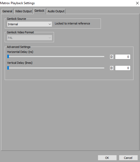

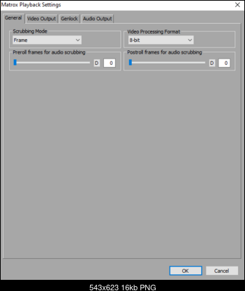

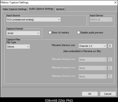

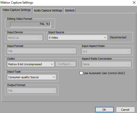

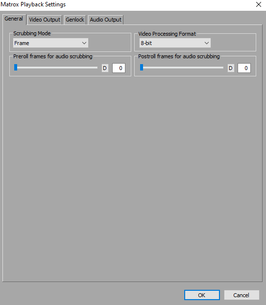

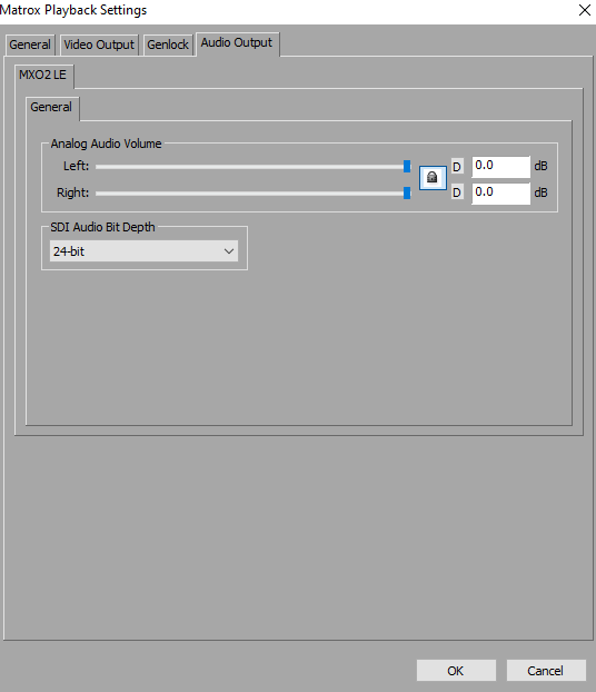

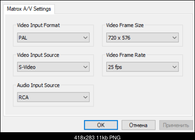

  5. I forgot to mention it earlier, but Matrox MXO2 LE doesn't seem to have any native procamp, or so I think at least. Here are all the Matrox tools that I have and none of them appear to be procamp-related:
    Matrox Playback Settings
    Matrox Capture Settings
    A/V Settings
    I've also checked the manual (attached), but it only covers color correction in an NLE like Adobe. Does this mean I'm stuck with digital procamp and would not be able to adjust it prior to capturing?
